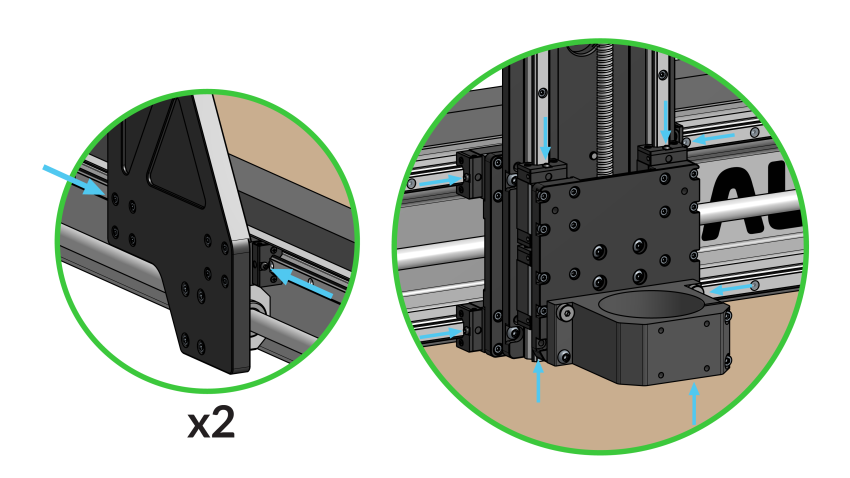

Linear Guides Lubrication
Do this every 160 hours of usage. If you are running the machine 8 hours a day, 5 days a week, you should be greasing every 4 weeks.
Method
If you used 3-in-1 or Mobil Vactra #2 oil in the past, feel free to continue using that on the linear guides. Otherwise, follow the instructions below for grease gun with lithium grease:
1. For the Z-axis, first jog to the top to get access to the screws
2. Remove one (1) screw from each linear guide block using the Allen key. See below for locations on each axis.
3. Push the nozzle firmly against the hole, and slowly pump until a small amount of grease comes out between the block and rail.
4. Wipe with shop towel to remove the excess.
5. Refasten the screw.
6. Jog to each end of the axis, to fully distribute the grease.
7. Repeat the above steps for each axis.
