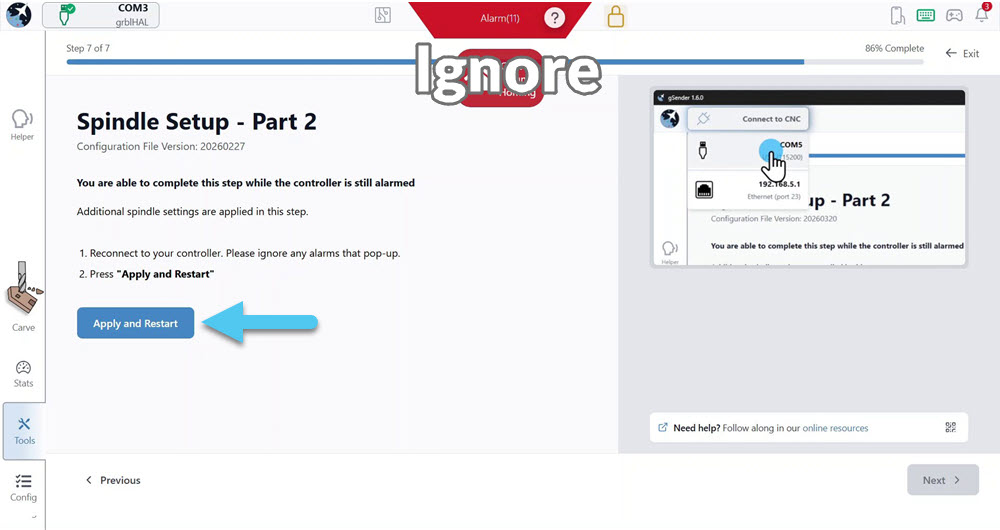

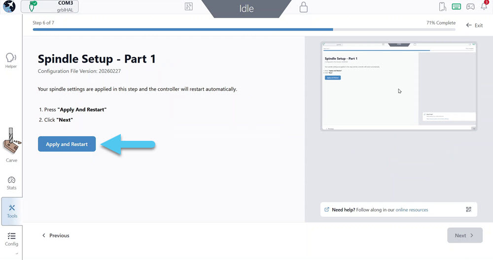

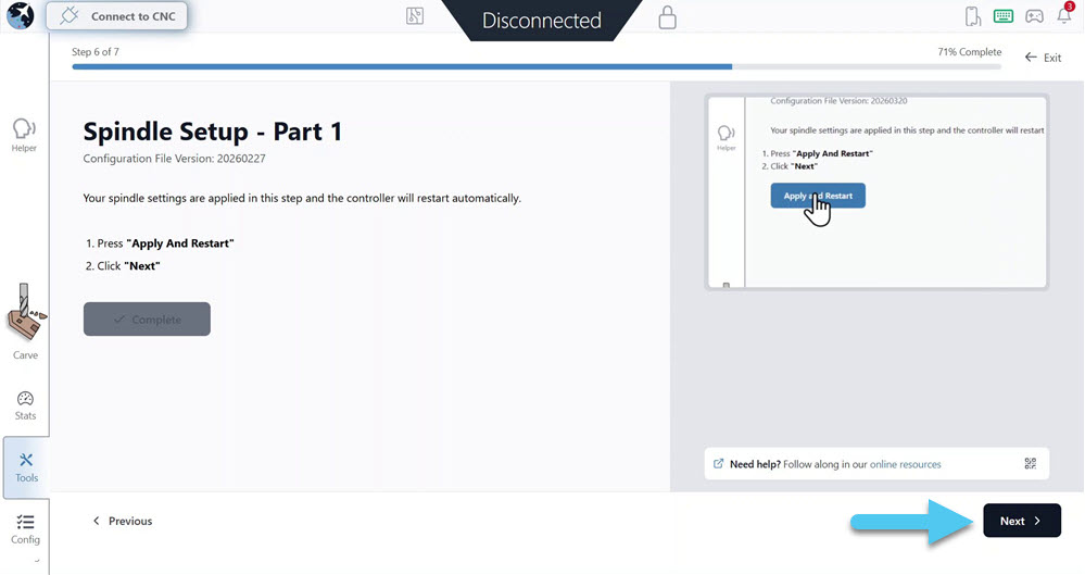

Spindle Configuration
In this section we will be power cycling and reconnecting to the SLB-EXT.
  1. Hit the Apply and Restart blue button.
  2. Hit the Next button in the bottom right corner.
  3. Reconnect to gSender.
  4. Ignore the alarms, and hit the Apply and Restart button again.
    Once complete, click the Next button. Setup is complete! Exit the wizard now.
