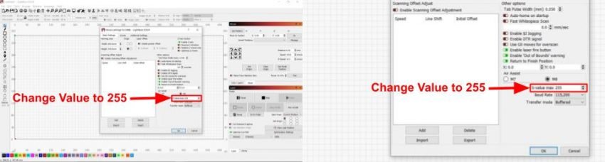

Setting your S value max correctly will ensure you have access to 100% of your laser’s power.
This value should always match your maximum spindle speed in your GRBL EEPROM settings. S value max = $30 value

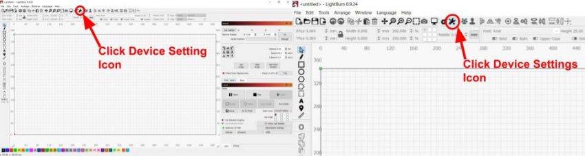

Lightburn
Click on the ‘Device Settings’ Icon
Change ‘S-value max’ to 255

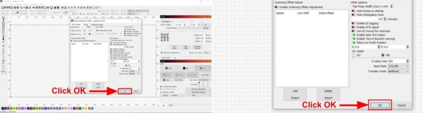

Click OK to save new setting
