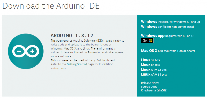

Download Arduino IDE
Start by closing any programs (like gSender, UGS, CNCjs, Easel, etc.) that can connect to your LongMill controller. Since the LongBoards ‘brains’ come from an Arduino that it has on-board, you will need a program called “Arduino IDE” in order to compile and flash any firmware changes onto the LongMill. The download page can be found here: https://www.arduino.cc/en/software.

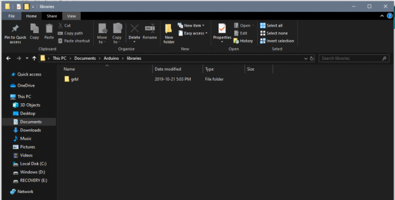

!! If you have flashed grbl firmware before using Arduino IDE, you will need to make sure to delete any old libraries for grbl. Arduino typically saves libraries in the Documents ➜ Arduino ➜ Library folder of your computer for both Windows and Mac. If you do not delete the old library first, you will install the old version of grbl. !!

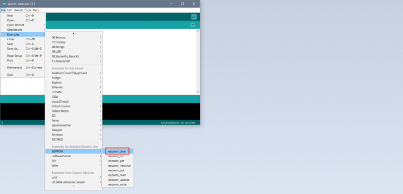

To ensure that all of the old settings are cleared from the board’s memory, we will do an EEPROM clear. You can find this ‘example program’ under File ➜ Examples ➜ EEPROM ➜ eeprom_clear.

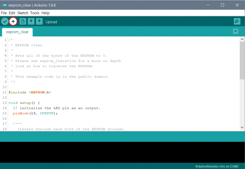

Clicking this will open up a new window where you’ll see the window is titled “eeprom_clear“. Click on the “Upload” button on the top left of the program to compile and upload this code. If you run into an upload error at this step, you might still be connected to your LongMill on your computer in gSender, UGS, CNCjs, or even LightBurn. You’ll need to disconnect from the LongMill in that program and then you should be able to retry the Upload.

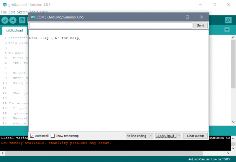

Now, upload the firmware code by clicking on the “Upload” button on the top left corner. It can take a minute or two for the firmware to finish uploading. Once completed you should see “Done uploading” in the turquoise bar as the bottom to let you know that the firmware has successfully been uploaded. Don’t worry about if you see a message for “low memory available”. The grbl firmware uses up a lot of the Arduino storage space but is designed to work very reliably regardless. The LongMill version is, if anything, a little bit smaller than the default grbl firmware so it will be just as stable.
You can check if your firmware has been correctly installed by going to Tools ➜ Serial Monitor. This will open a window to show the console output of the Arduino. If your output looks garbled, make sure to set your baud rate to 115200. As you can see, the output shows the firmware version and build date.
