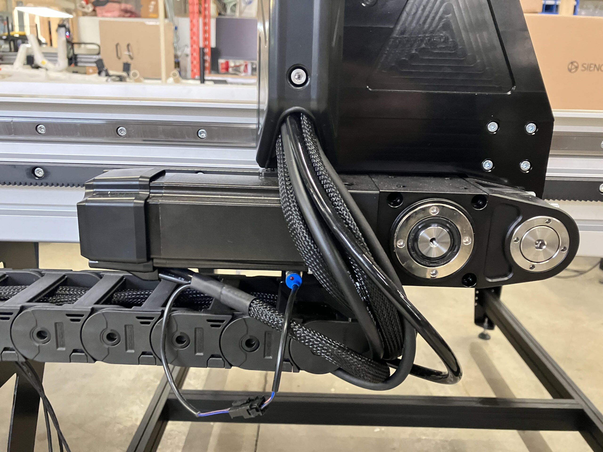

  • Do not lean on or rest your body on any part of this machine, especially during jobs. The rack and pinion assembly is a major pinch point, stay away from that area.
