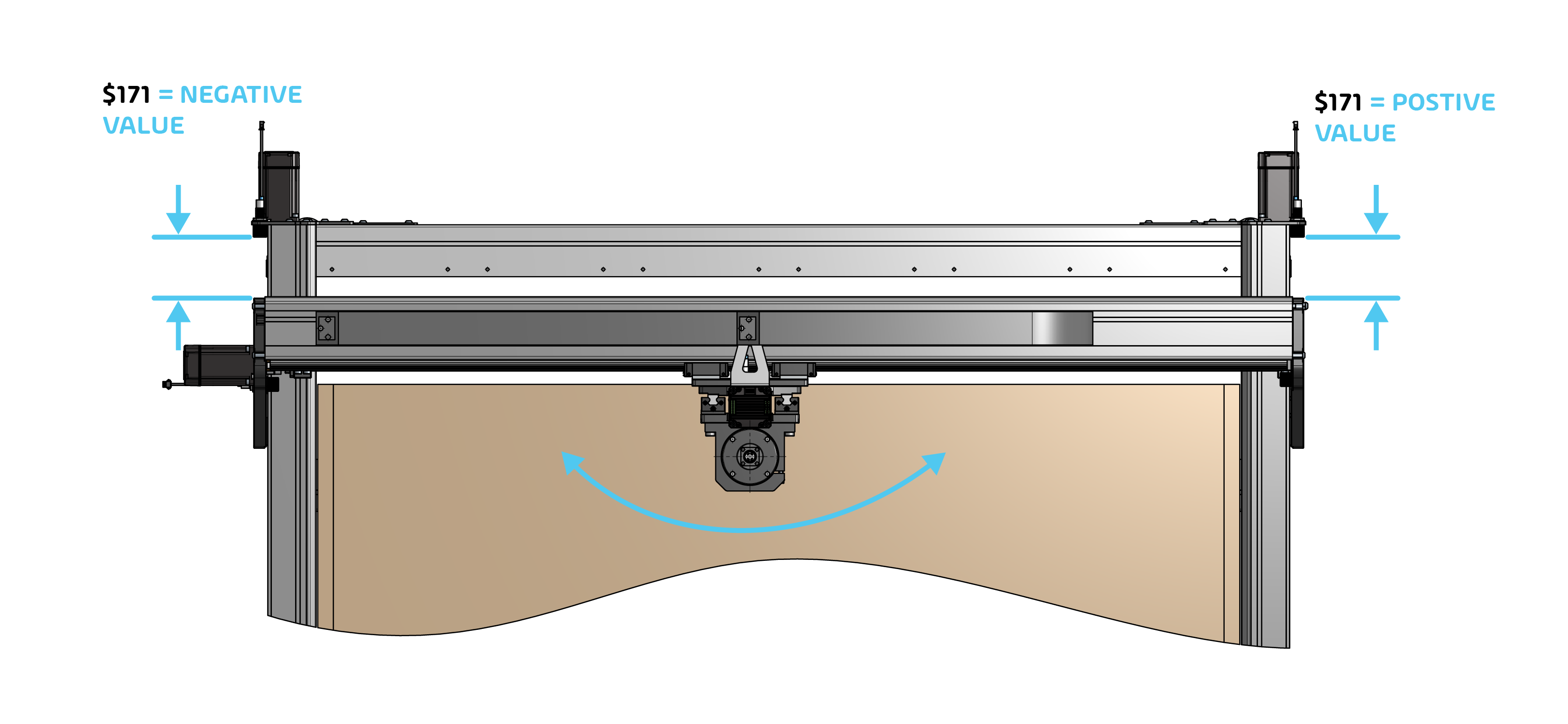

X-Y axis squaring
The AltMill is set up by default to use ‘dual homing’ in the Y-axis direction. This makes it possible to easily adjust the squaring of the machine in the XY directions, as well ensure the machine automatically squares itself every time the homing cycle is run. Out of the box, the machine is likely to be nearly perfectly square, but in some cases, small adjustments are needed.
1. To figure out how square your AltMill is, you can use gSender’s built in XY Squaring tool, found in Tools. If your machine is not square, this tool will inform you of some distance that either the left or right Y-axis gantry should be moved forwards or backward.
2. Once you have this distance value,  go to Config. Under Homing/Limits, scroll to find Y-axis dual homing offset.
3. Input the distance value:
  • Setting a positive value will cause the right side of the machine to stop slightly forward after every homing cycle (turning the whole gantry clockwise).
  • Setting a negative value will cause the left side of the machine to stop slightly forward after every homing cycle (turning the whole gantry counterclockwise).
4. Press ‘Apply Settings’, then turn OFF/ON the controller to have the change take place.

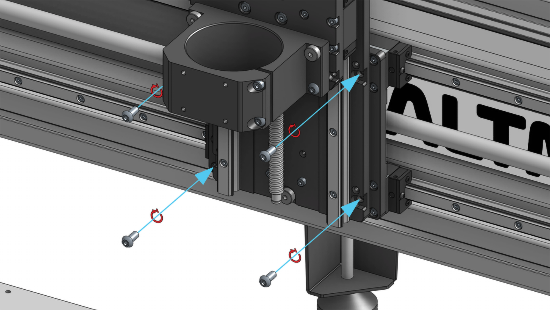

Tilt
1. Swap the left shoulder screw, to use the  ‘Eccentric Bushing’, and extra M6-25mm button head cap screws inside this hole instead. Slightly loosen all four screws securing the spindle mount to allow the mount to pivot.
2. To finely adjust the tram of the spindle, use the small end of the included AltMill wrench to carefully rotate the hex of the eccentric bushing as shown below. Depending on where the eccentric bushing is angled, turning the wrench will cause the spindle to move some small amount.
3. For very fine adjustment, it may sometimes be necessary to gently knock the top of the spindle with a small rubber mallet, or the back of a screwdriver handle. Once finished, simply tighten all four screws.

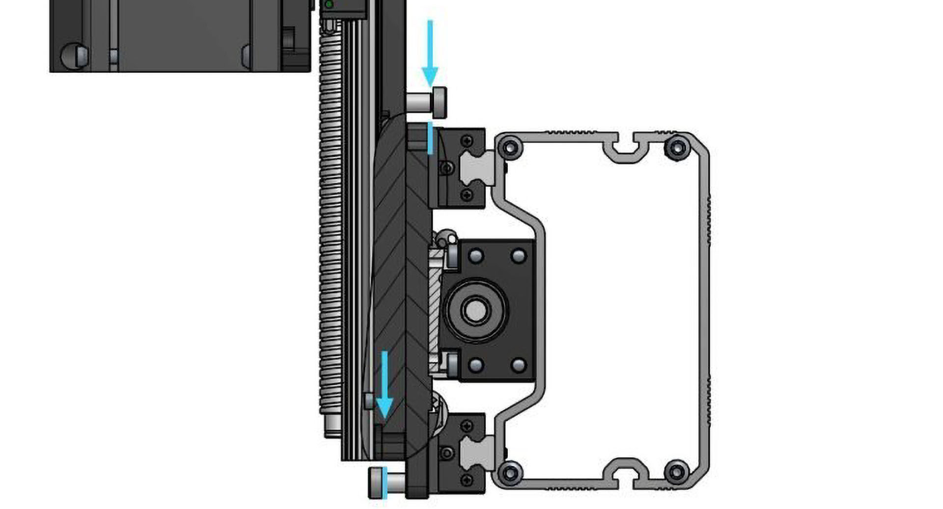

 Nod
Warning – Do not use eccentric bushings to tram in the nod direction!
This cause misalignment between the ballscrew and the motor, which leads to premature wear on the motor.
Please follow the instructions below for the correct method to tram in the nod direction.
1. Loosen the 2 shoulder bolts, don’t remove them
2. Loosen the 4 mounting screws
3. Use shim stock or a cheap set of feeler gauges for your adjustment
4. To adjust:
  • To tilt the spindle forward, shim beside the 2 top screws in between the plates
  • To tilt the spindle backward, shim beside the 2 bottom screws in between the plates
5. Tighten the screws and shoulder bolts
