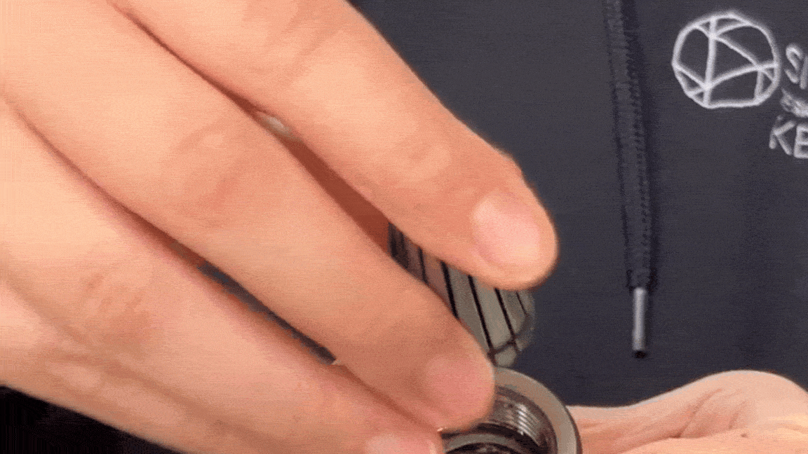

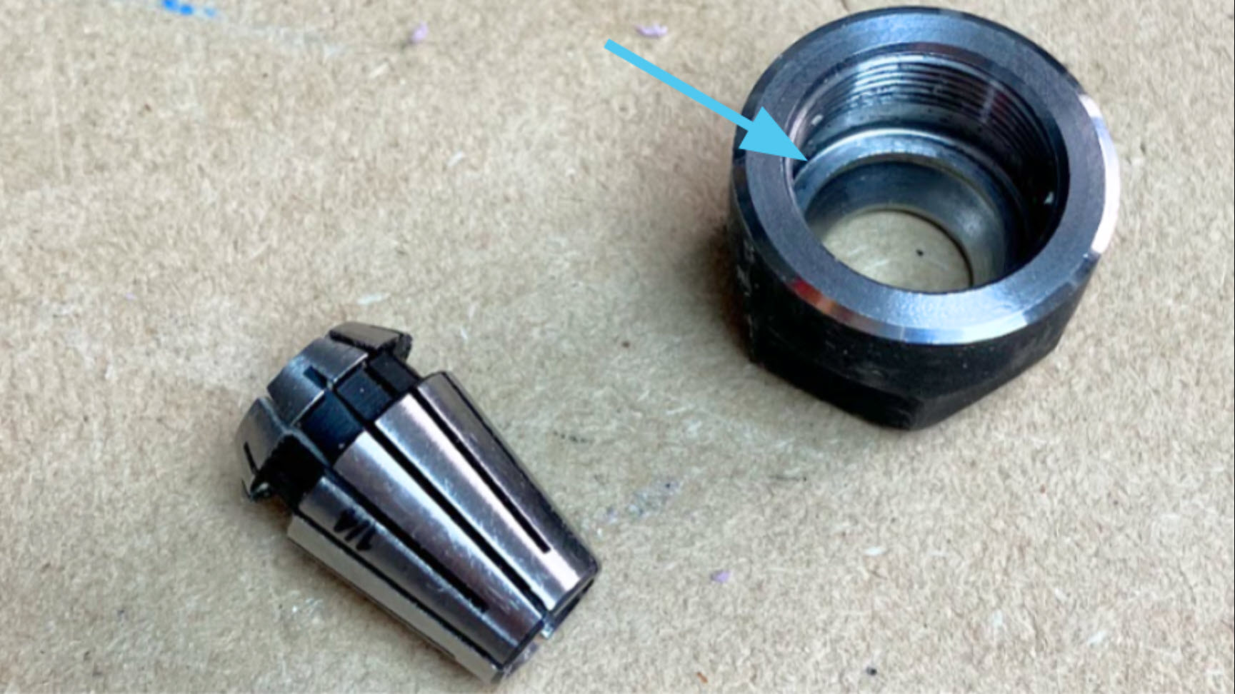

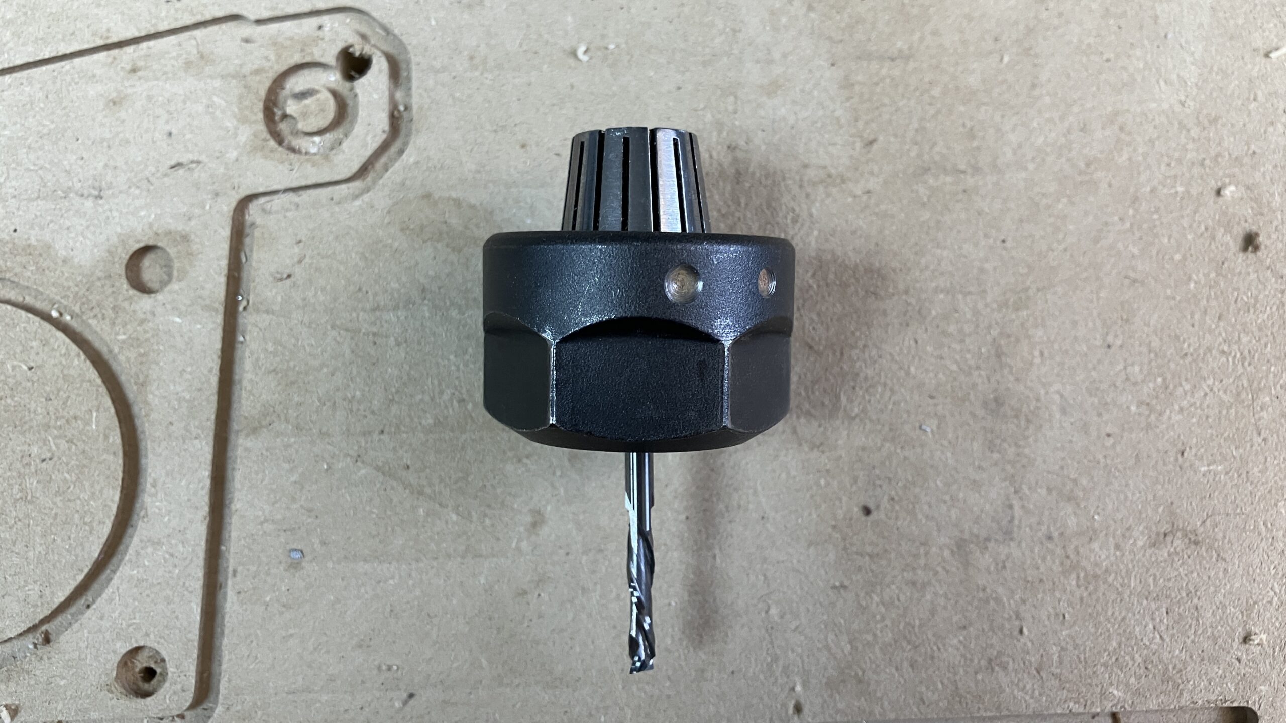

An ER collet is assembled differently from a regular collet. By design, the collet is captured in the nut by an eccentric groove. If the collet is not captured by the nut, it can cause cutting performance and noise issues. It could also get stuck in the spindle shaft.
To assemble:
  1. Press the collet into the nut until it clicks, then check that the face of the collet sits flat on the nut.
  2. Insert a cutting tool into the assembled ER collet

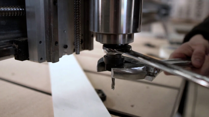

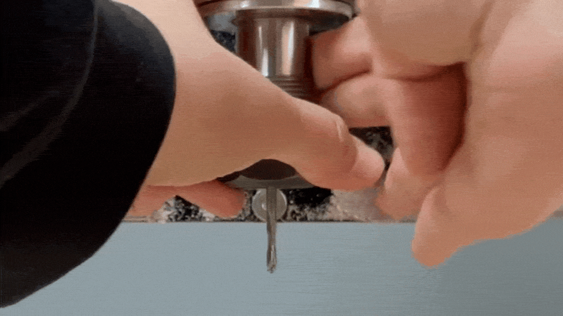

  3. Hand tighten the assembled tool and collet onto the spindle.
  4. Use the provided wrenches to fully tighten the tool and collet, by bringing the wrenches together.

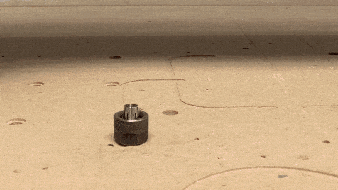

Removal
To switch out the collet, use the other collet to push out the installed collet from the nut.

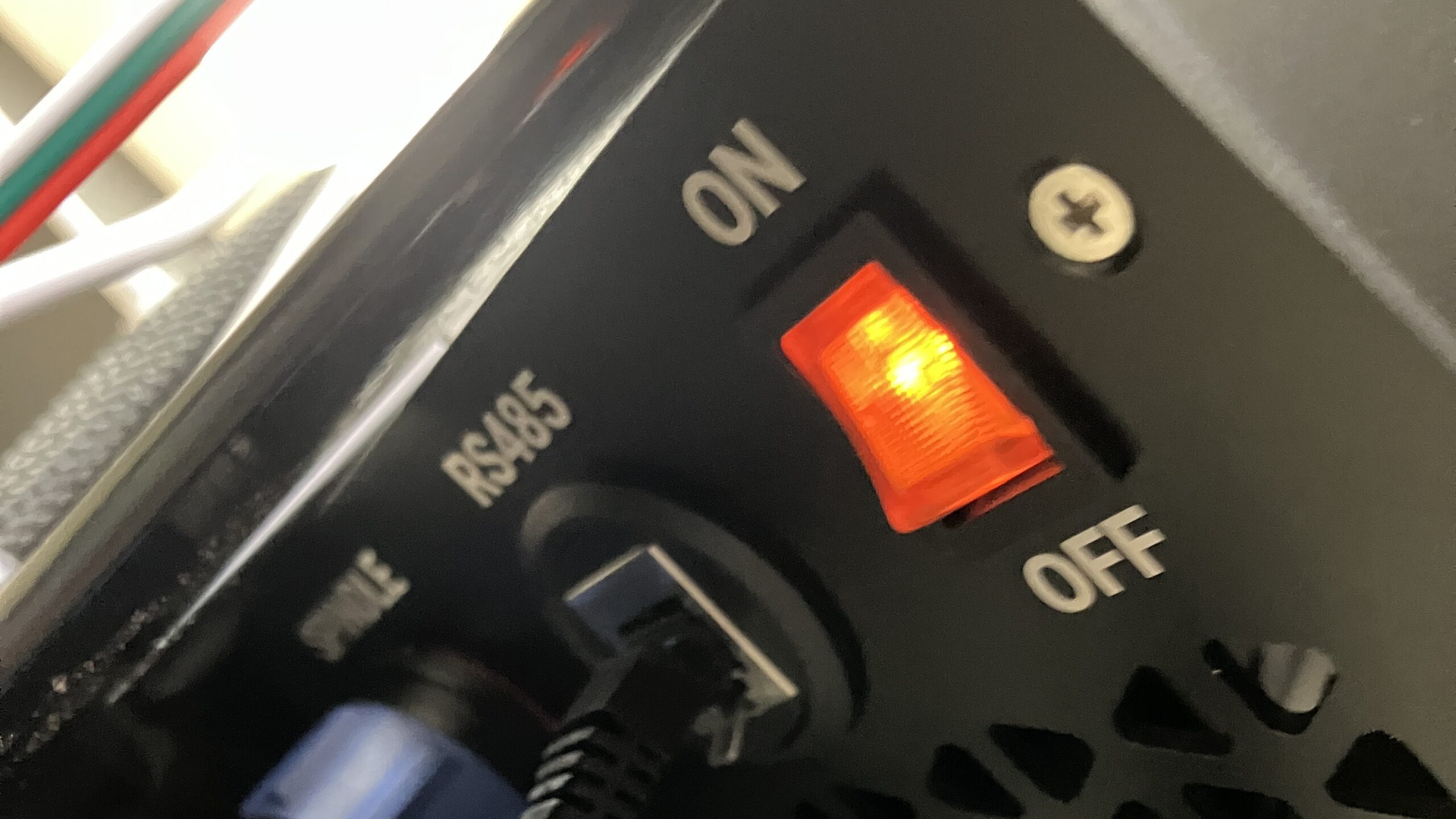

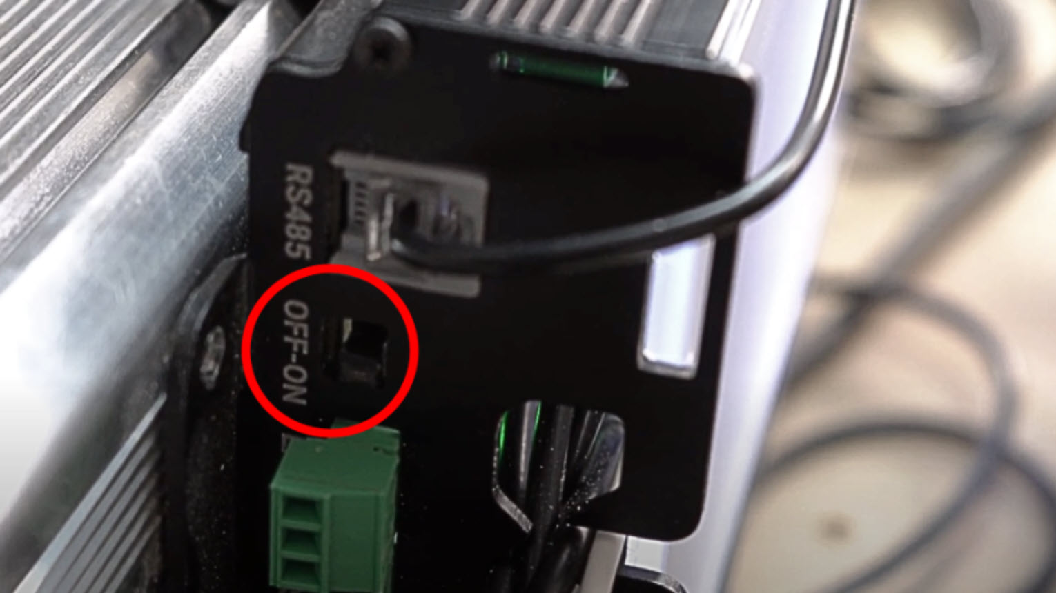

Your VFD needs to “handshake” with the SLB/SLB-EXT controller, to begin communication between the two systems. Therefore the VFD and controller need to be turned ON in the correct order — even if they’re both ON at the same time, it doesn’t mean they will go through the handshake.
Assuming the SLB/EXT controller is plugged into power but turned OFF:

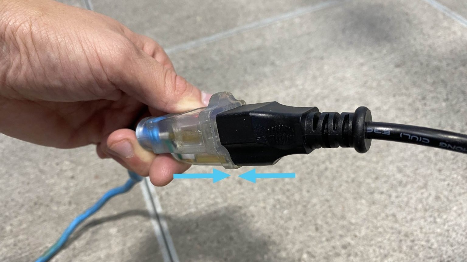

  1. Plug the VFD into power.
  2. Turn the VFD power switch ON, the VFD should flash with red text.
  3. Then turn ON the controller using the toggle switch.
This is the correct order of events to avoid alarms and VFD communication issues.

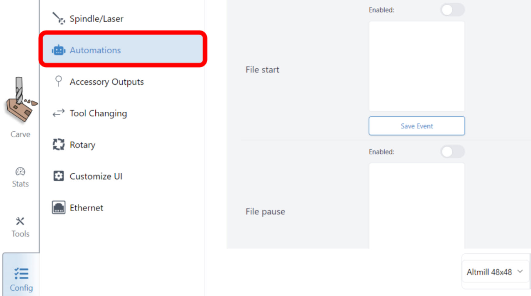

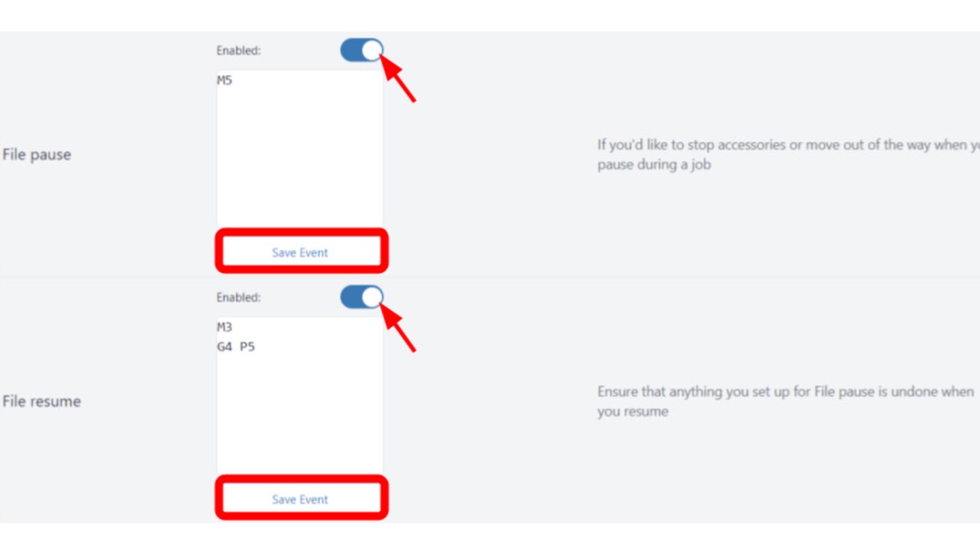

Since gSender does not automatically stop the spindle when the job pauses, nor start up the spindle when the job resumes, some users may find it helpful to create Automations to safely pause and resume their job.
  1. On gSender, go to Config. On the left sidebar, select Automations.
  1. We recommend inputting the following set of commands:
    File Pause
    M5 – Stops the spindle when you pause the job
    File Resume
    M3 – Spins up the spindle to the previous programmed RPM, counterclockwise
    G4 P5 – Gives 5 second dwell time for the spindle to get to speed
  2. To put these automations into effect, set the toggles to Enabled, and then press Save Event.
For a more in-depth explanation about Automations, please see this article on the gSender resources page.
