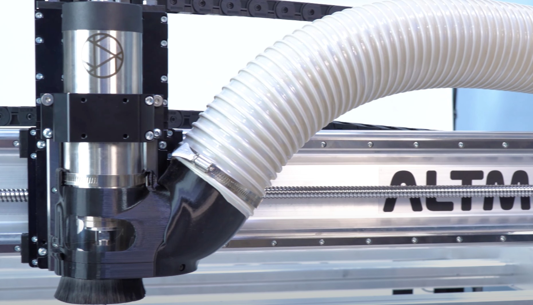

Below are the video instructions for assembling your dust shoe.
Clear Cut Dust Shoe
For the ATC version of the Clear Cut Dust Shoe, please see this page.
Usage guidelines:
  • You can remove the bottom section of the dust shoe when changing out your tool
  • If you are using the Clear Cut Dust Shoe on the LongMill, please note that machine travel may be reduced
80mm Dust Shoe
Usage guidelines:
  • We recommend to take off the dust shoe when surfacing, since the machine is moving to its limits the dust shoe can get damaged
  • Feel free to adjust the dust shoe using the hose clamp. We recommend positioning it so that it faces along the Y-axis so it does not interfere with your cutting jobs
