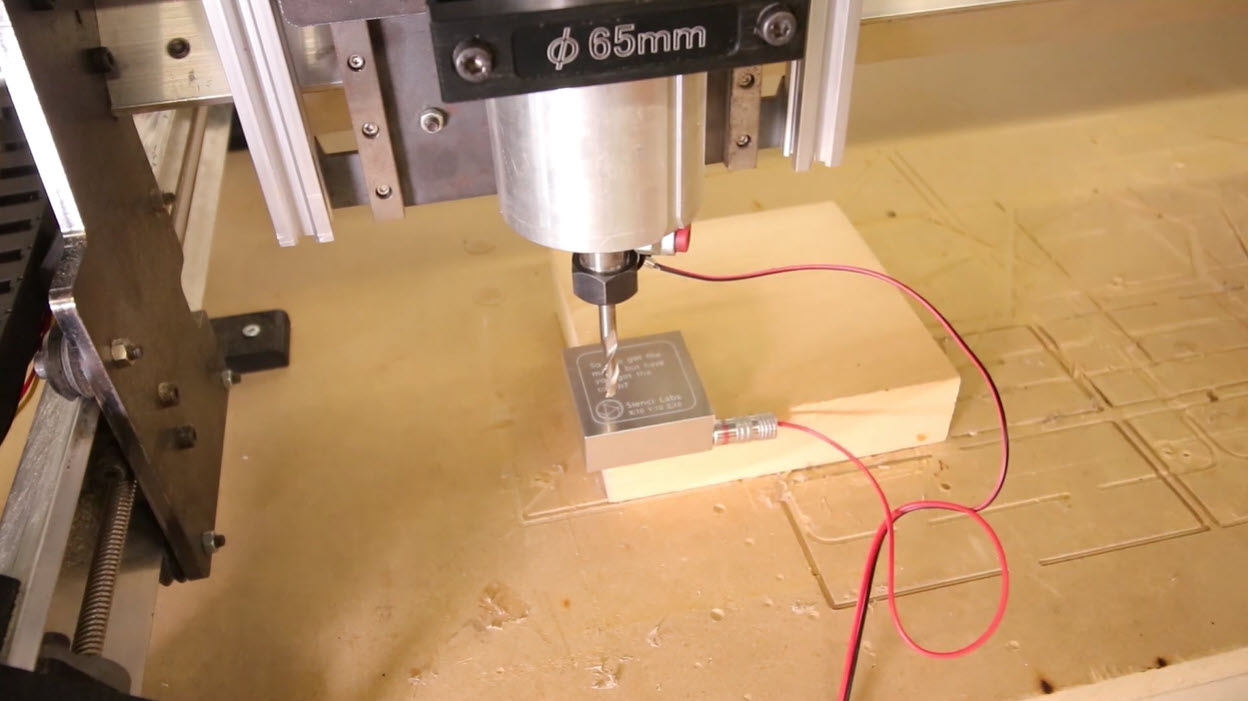

  • Make sure the magnet is on the router’s collet nut, and the banana plug is in the block.
  • Place the touch plate on the front left corner of your material. Make sure that both of the inner faces of the touch plate are contacting the edges of your material.
  • Install your tool, in this example we have a 1/4″ end mill.
  • Jog your machine to position the cutting tool about 10mm (½”) above the circular logo on the touch plate.
1/4″ end mill positioned for an XYZ probe

  2. Press the ‘Probe’ button and you’ll get a pop-up window to confirm bit position and electrical connection.
    You can either bring the touch plate to the end mill or touch the banana plug and magnet together. Make contact a few times just to confirm there is conductivity, as the red circle should flicker to green, and a blue ‘Start Probe’ button appears.
  3. Press ‘Start Probe’ – the machine will move to probe three sides of the touch plate, twice on each side. There should not be any crashing or abrupt movement.
  4. Once the process is over, remove the touch plate components from the machine then press the blue ‘XY button in the Go column. The bit should move to the front left corner of the stock material. Press the blue ‘Z’ button in the Go column. The bit should move to the material’s surface.
  5. If the probing was unsuccessful, then you will see an ‘ALARM’. To bring it out of the alarm state, press the pulsing ‘Unlock’ button in the middle of the visualizer. An unsuccessful probing cycle can result from an incorrectly positioned probe or starting too far outside the circular logo. Be sure to verify your setup before attempting another probing cycle.
