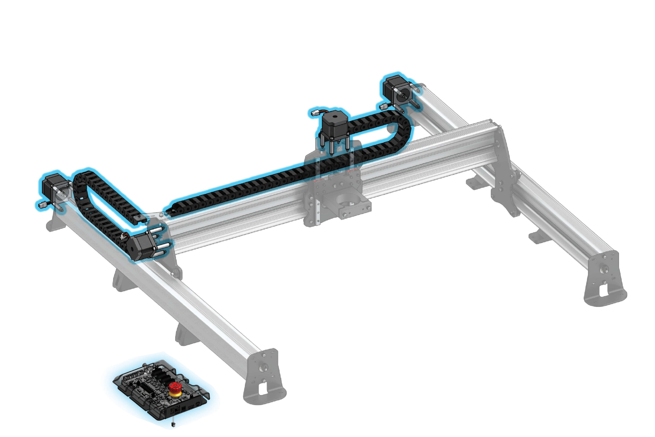

Switching to the Closed Loop Stepper Motors (CLSM) from the open loop motors is easy. The main difference between the open loop and the closed loop motors is that the open loop motors lack positional feedback making them prone to “skipping steps” under load. With closed loop motors there is a feedback system that helps in monitoring their positions which enables them to self-correct errors, improve accuracy and operate more efficiently.

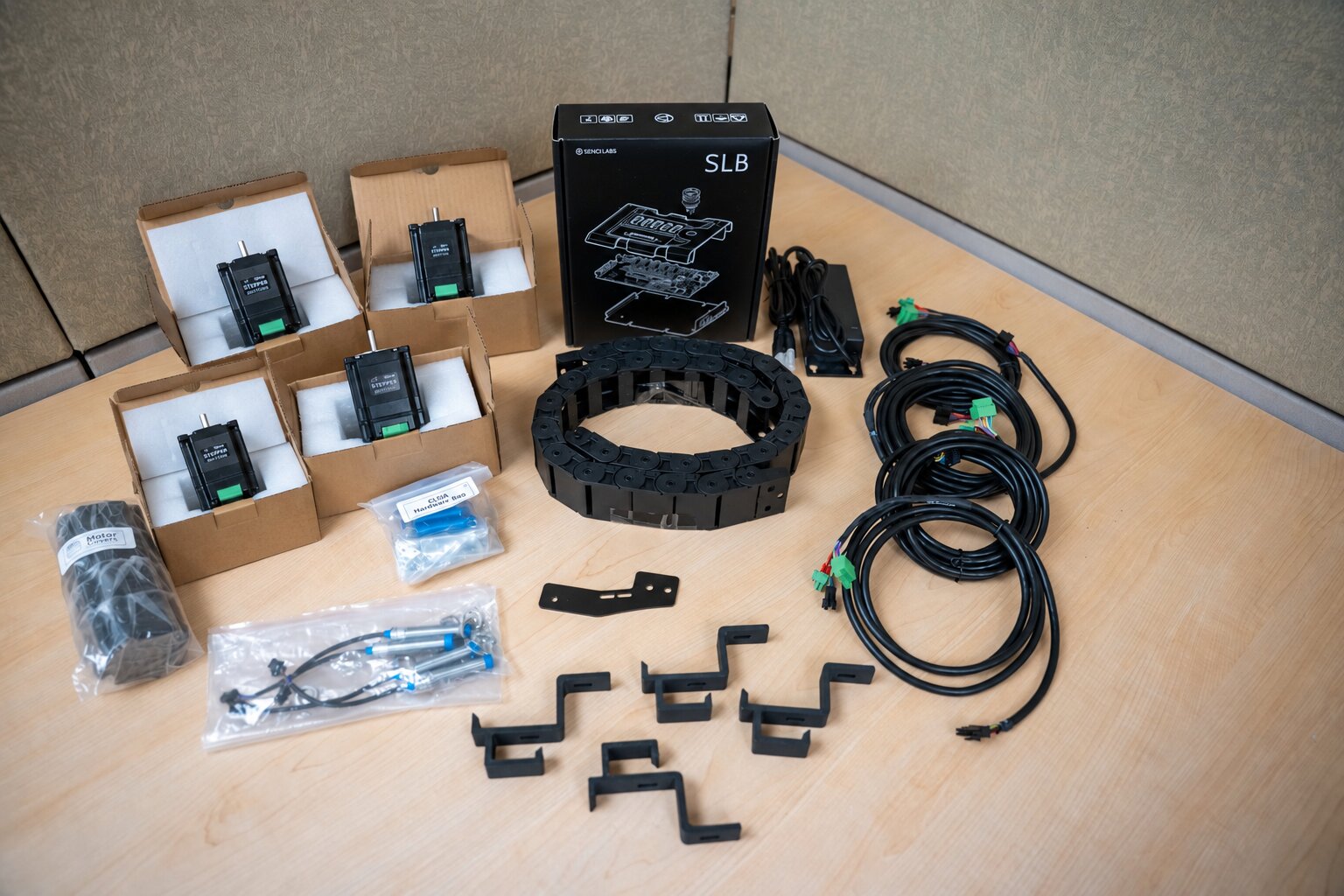

Your upgrade kit will include a new SLB-EXT, 4 closed loop motors, 4 inductive sensors, a new 48 volt power supply and more! Check out the list below and contact our team if any parts are missing.
The following components are included in the upgrade kit and are shown together in the photo below:
- NEMA 23 Motors (x4)
- Motor Covers (x4)
- 40 mm blue aluminum standoffs (x16)
- SLB-EXT (Includes E-stop)
- 48 VDC power supply
- Larger Drag chain 18×26
- Drag chain bracket
- Drag chain holder mounts (x4)
- SLB EXT 3D-printed rail mounts (x2)
- Inductive sensors (x4)
- Inductive sensor bracket (x2)
- Motor cable set (X cable: 1.8 m, Y1 cable: 1.4 m, Y2 cable: 2.7 m, Z cable: 3.65 m)
- M5x10mm hex head screws (x2)
- M5x12mm socket head screws + washers (x10)
- Hex nut (x1)
- Nylock nuts (x2)
- M5x55mm socket head screws (x4, for dust shield addon)

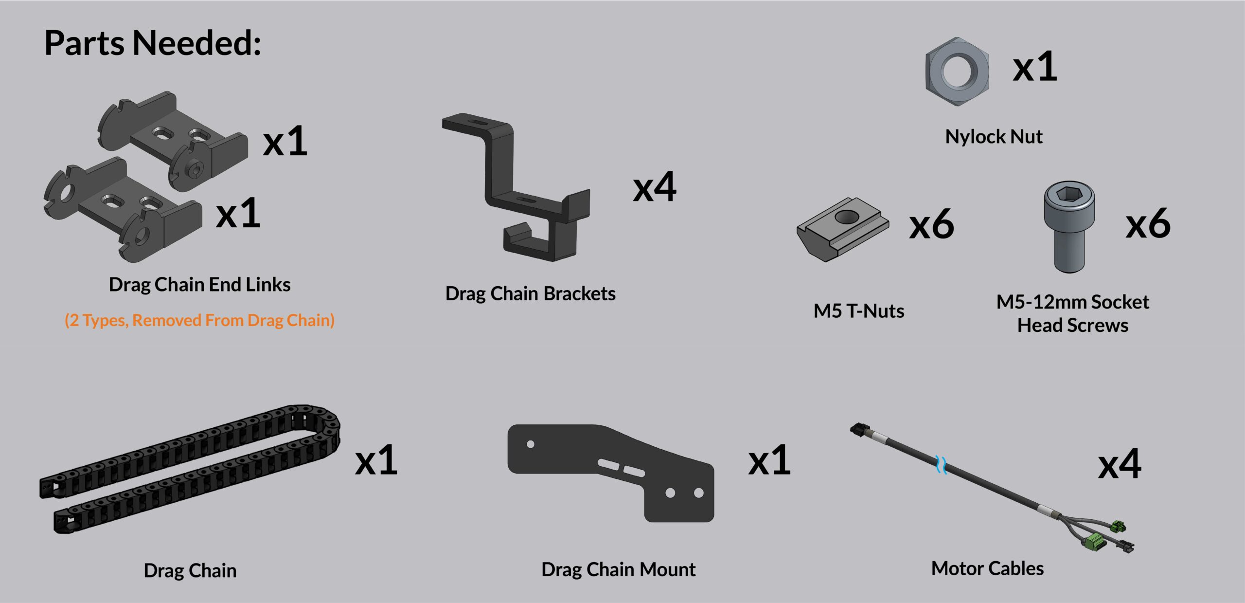

With the new, larger drag chain in hand, remove the end links, so we can install them separately, then have an easier time when it comes to reconnecting the drag chain. This can be done with a small flat head screwdriver.

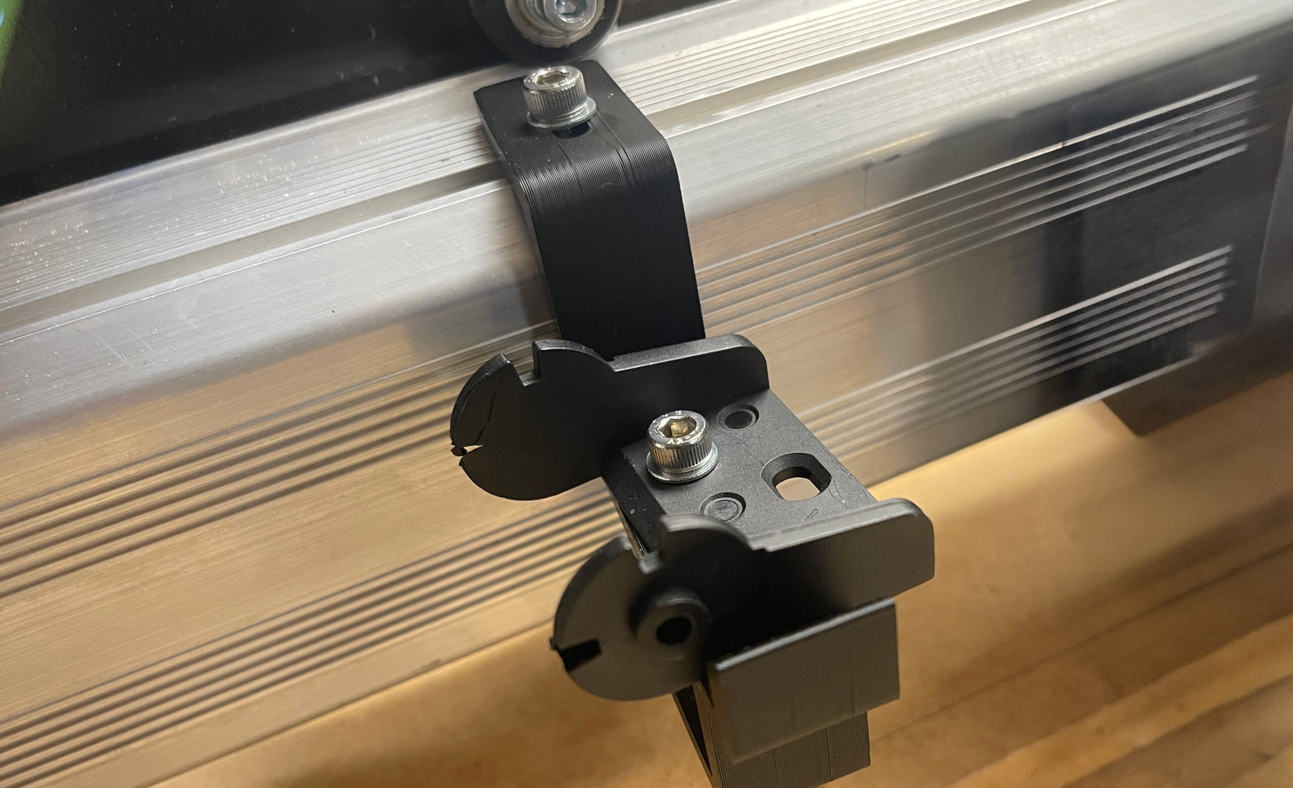

Grab the drag chain mount, 2 x M5 T-nuts and 2 x M5-12mm screws and attach the new black drag chain mount to replace where you old silver one was. You can re-use your M5 T-nuts in this step if you wish.
Now you can use another M5-12mm screw to secure the drag chain end link that has open ends. This hole is threaded, so no need for a nut here.
Moving to the Y-axis where the old drag chain was, move to the back and slide 4 M5 T-nuts into the rail. We will be using these to support the 4 drag chain brackets. Place a washer down, then an M5-12mm screw will hold down the bracket. Space them out evenly, using fewer if you have a smaller footprint.
Now we can attach the final drag chain end to the last drag chain bracket with an M5-12mm screw and the nylock nut.
One tip that can help out in this step is to put the drag chain end on before you put the bracket onto the rail as pictured above.
Slide the bracket into place and tighten down the M5-12mm screw.
Clip the drag chain onto each drag chain clip.

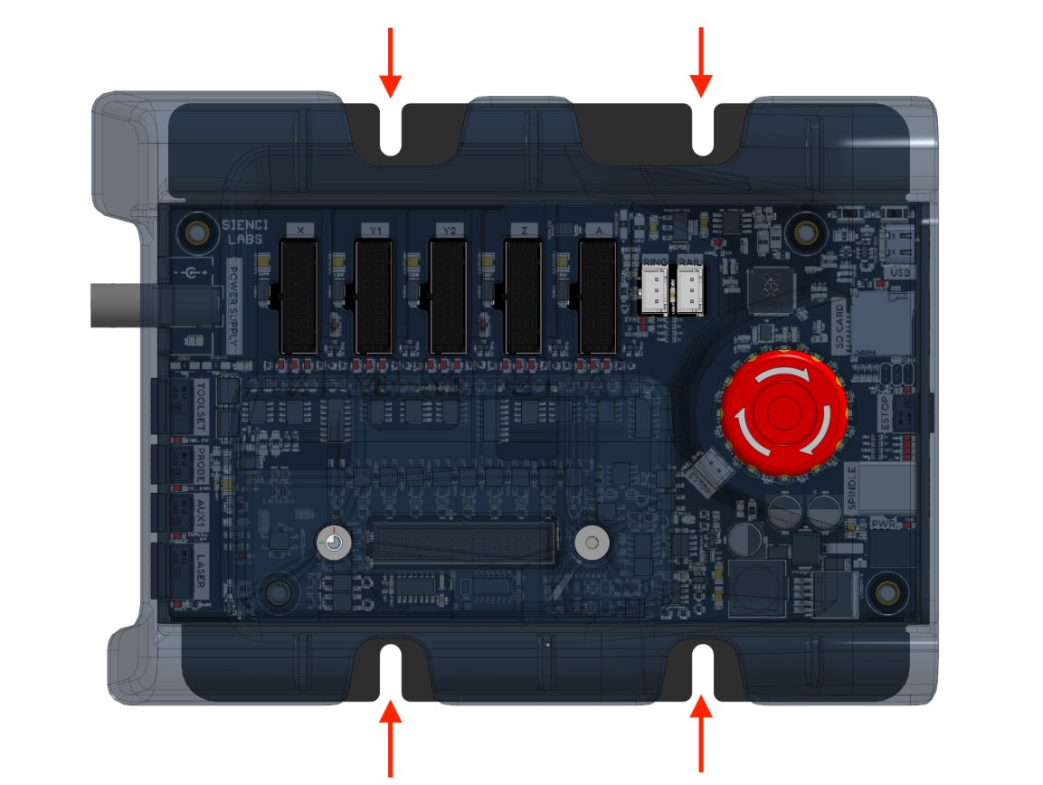

To begin this section, let’s mount the board to the rail. Grab both SLB EXT mounting brackets and slide them onto the back of the case. You may notice that they are slightly angled. This is by design and allows you to slide them easily onto the case, while clamping the case to the rail when tightened.
Space them out evenly, then tighten them down onto the rail using the M5 T-nuts and M5 12mm screws.

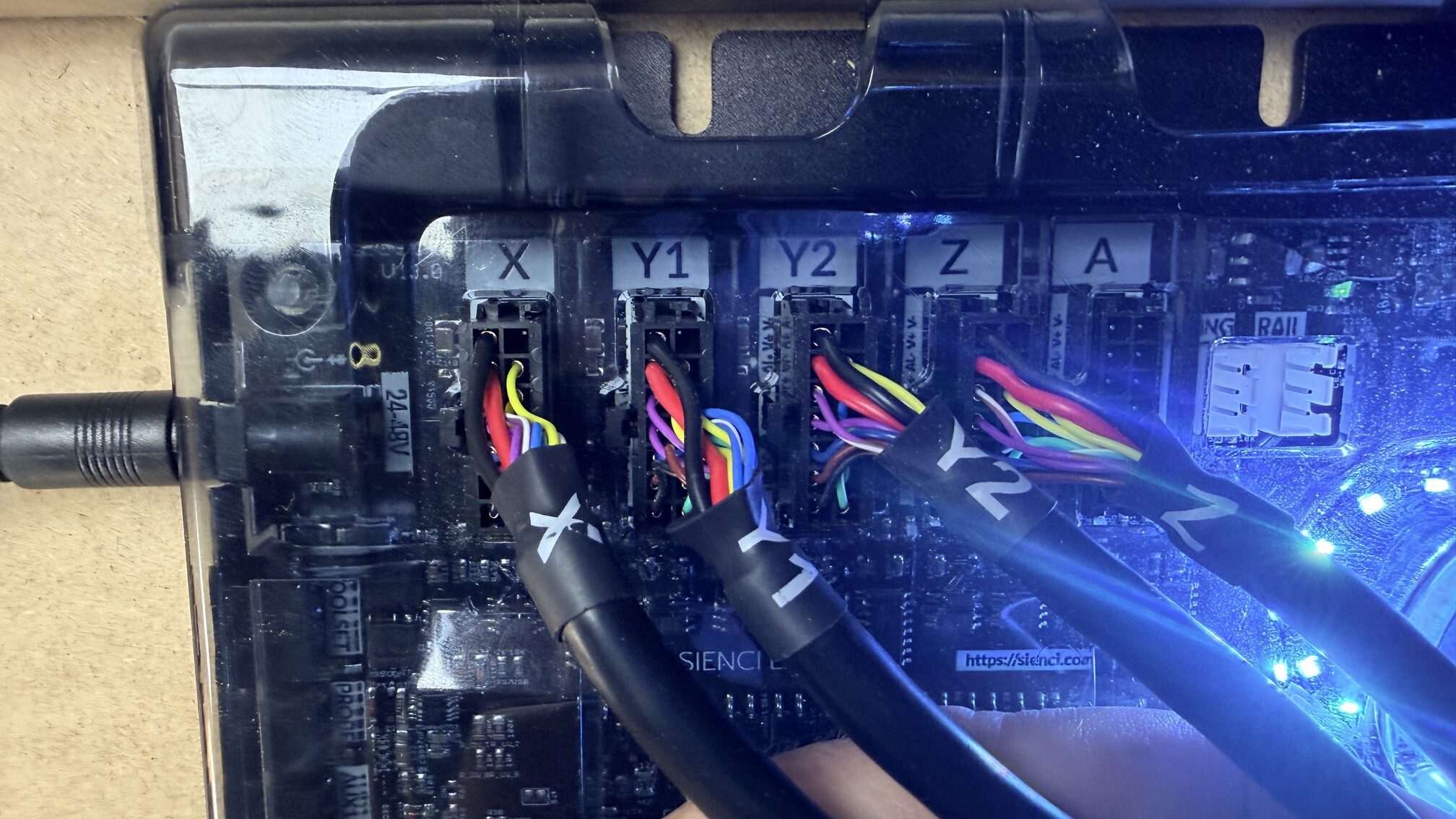

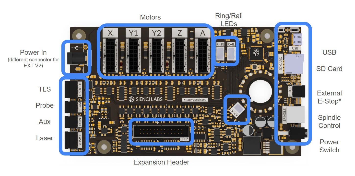

Fit the Z-axis and X-axis wire harnesses into the top cut out of the enclosure on the left side. Plug the sensor and motor control connectors into their respectively named ports.
Plug the two-pronged motor power connectors into the left most power ports. The power ports all supply the same output and therefore the connectors are able to be plugged into any, however, for installation purposes we recommend you to plug into the two leftmost ports while installing X and Z.
Fit the Y1-axis and Y2-axis wire harnesses into the bottom cutout of the enclosure on the left side. Plug the sensor and motor control connectors into their respectively named ports. It is important that you do not mismatch the control connector from one harness with the sensor connector of the other when plugging into one pair of Y1 or Y2 ports. If installed incorrectly you will encounter an alarm during operation.
Plug the two-pronged motor power connectors into the two rightmost power ports. The power ports all supply the same output and therefore the connectors are able to be plugged into any, however, for installation purposes we recommend you to plug into the two rightmost ports while installing Y1 and Y2 power.
