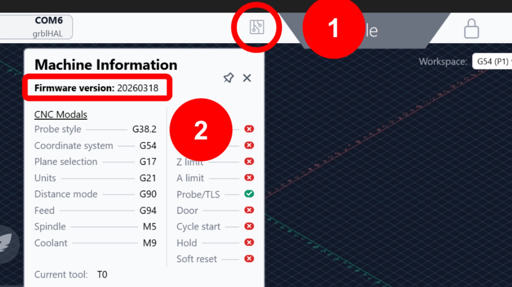

At the top of the screen, press on the circuit board icon for Machine Info. Verify which firmware version you have.
Download the correct setup file for your firmware version:

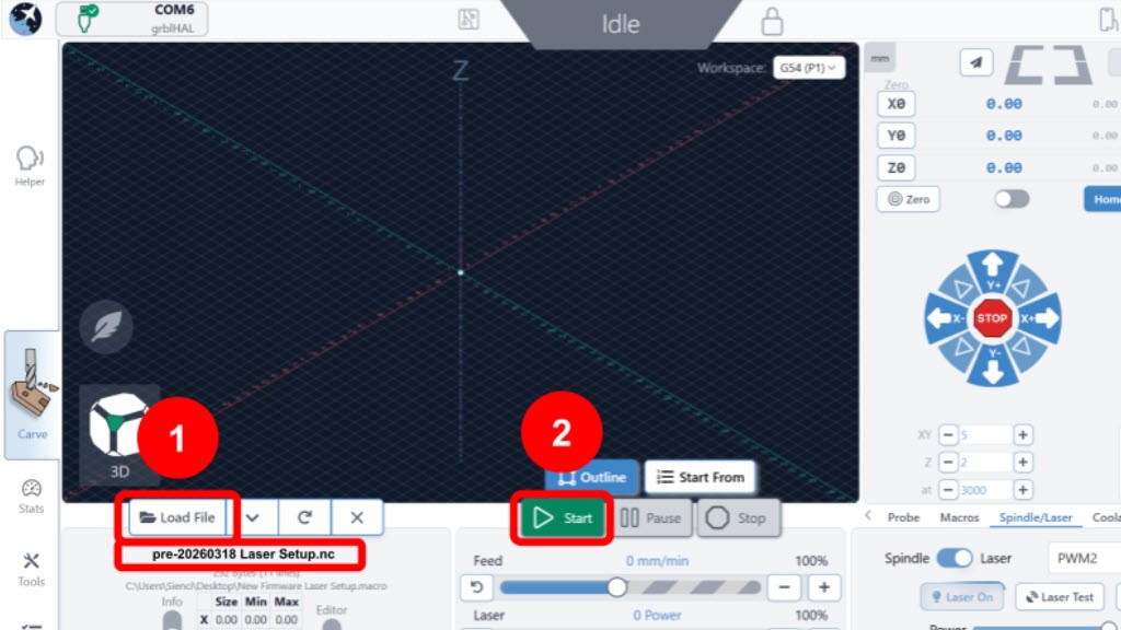

Load the file into gSender, then press Start.

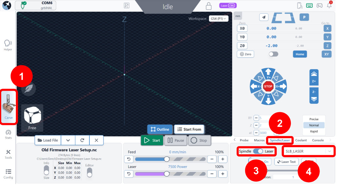

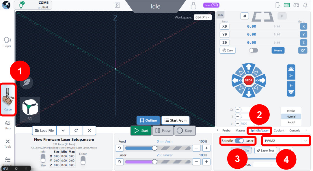

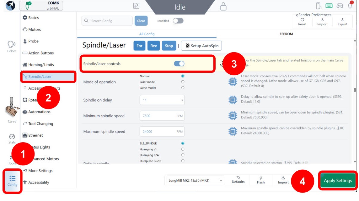

The file will take a few seconds to finish. Once it is done, go to Config. Select the Spindle/Laser heading. Toggle ON the Spindle/laser controls. Then press Apply Settings.
Go to the main Carve screen. Under the Spindle/Laser tab on the right side, toggle to Laser. Depending on what options are available, you can select either SLB_Laser or PWM2.

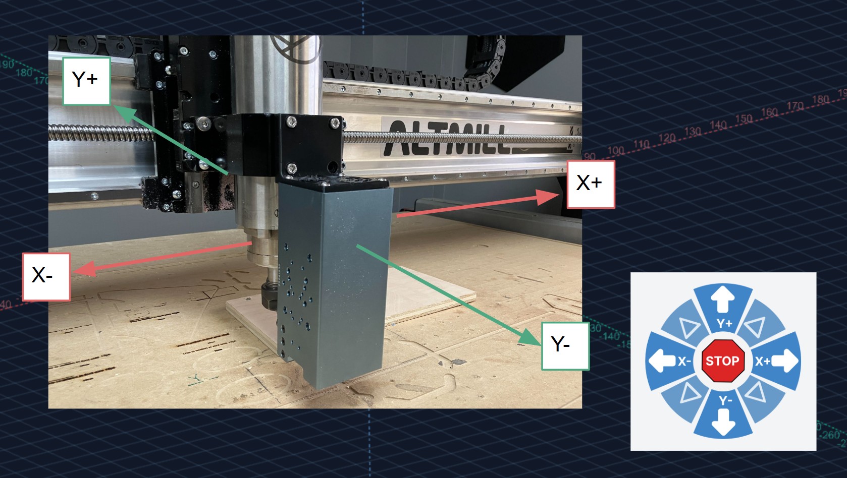

Laser Offsets
To easily zero your laser job, we recommend setting up your “laser offsets”, which is the distance and direction your laser is mounted in relation to the spindle/router. You would zero with your spindle/router as normal; the laser offsets will automatically apply when you switch into Laser mode. Then machine will know where the laser is and start the job at the right spot.
You only need to set up the laser offsets once!

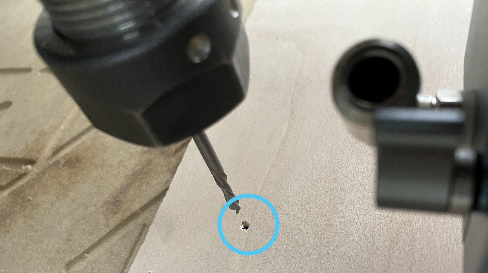

  1. Make sure you have an end mill installed to your spindle/router.
  2. Secure a scrap piece of wood. Make sure it is large enough – we will use this to mark our spindle/router position and laser position.
  3. Set your XY zeros on gSender. The blue coordinates should turn to O.
  4. Mark the zero position on the wood with a pencil.
  5. If you aren’t wearing them yet, wear your laser safety glasses!
  6. Turn ON the laser at low power (1-2%) to mark a pin hole on the wood. Then turn OFF the laser.
  7. Jog the machine in the X and Y axis to hover the end mill directly above the pinhole. Try to be as accurate as possible.
  8. Check the blue X and Y coordinates on gSender, you should see number values, possibly with negative signs (-). Write these values down without the negatives.
  9. Determine the offset value by checking the position of the laser with respect to the spindle.
    Example:
    If the laser is mounted in front of the spindle, it is the in the -Y direction. So the Y offset value is the number value with a negative sign (-).
    If the laser is mounted to the right of the spindle, it is in the +X direction. So the X offset value is the number value WITHOUT a negative sign.
  10. To enter the final offset values go to Config. Under Spindle/Laser find the Laser X Offset and Laser Y Offset settings. Input your values there.
  11. Press Apply Settings and turn OFF/ON your controller to have the changes take effect.
