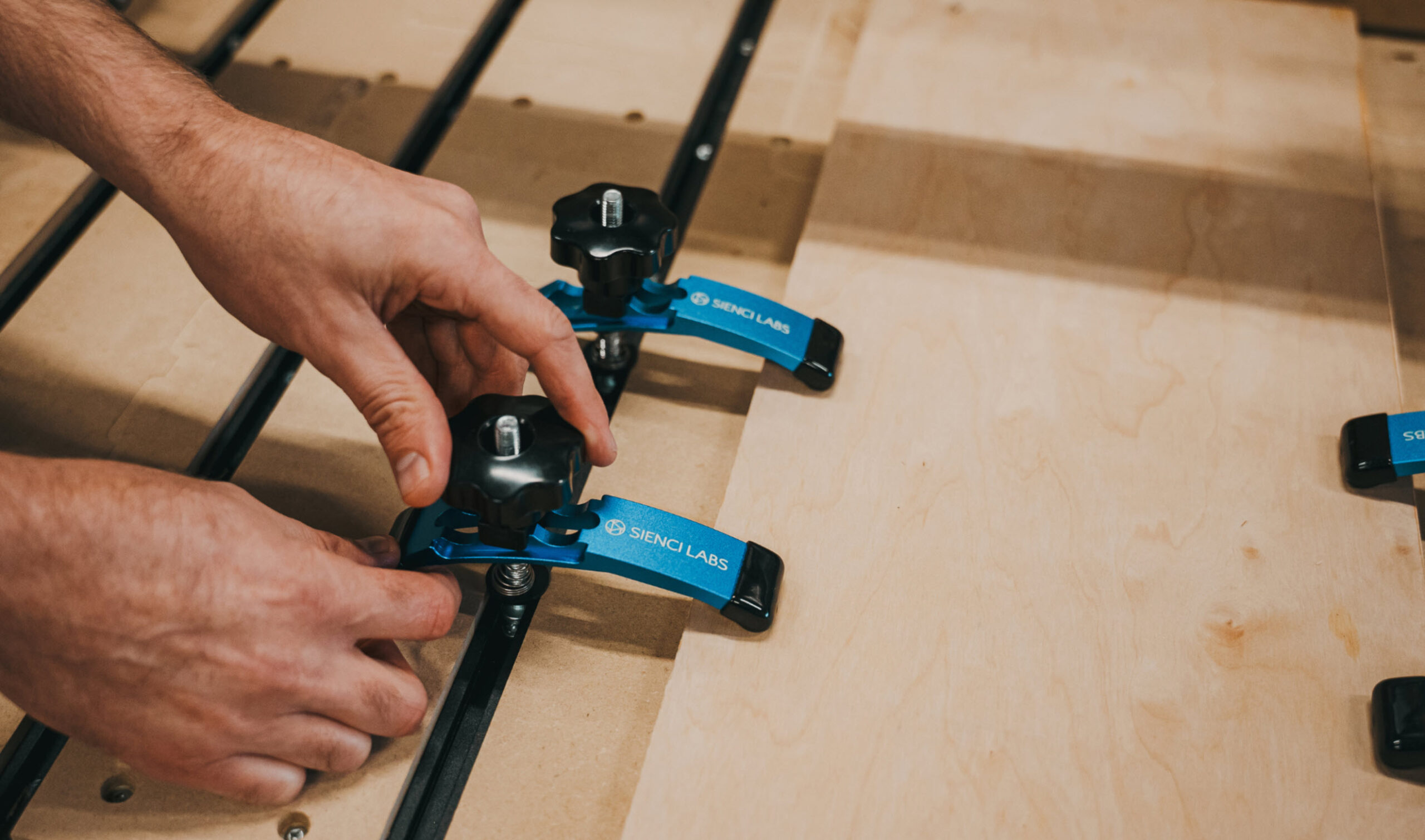

The T-Clamp System
T-clamps are simple and reliable workholding tools that are used alongside T-Track tables, holding down metals, plastics and woods at varying different thicknesses. These are ideal for holding down small to medium sized pieces of material and also leverage their plastic ends in case you cut a little closer to the clamp than you expected.
To use the T-Clamps:
  1. Slide the hex bolt head through the t-track so that the entire clamp is on the table.  You may need to adjust the bolt and knob to have it fit onto the table.
  2. Place your workpiece onto the table.
  3. Move and adjust the clamp to push down onto the workpiece, ensuring that the clamping end is lower than the bolt end. Tighten both bolts until snug. Position the clamps so that there is enough space for your cutting job on your workpiece.
  4. Push your material to check if it is secured onto the table. If not, use more T-clamps or other workholding methods.
