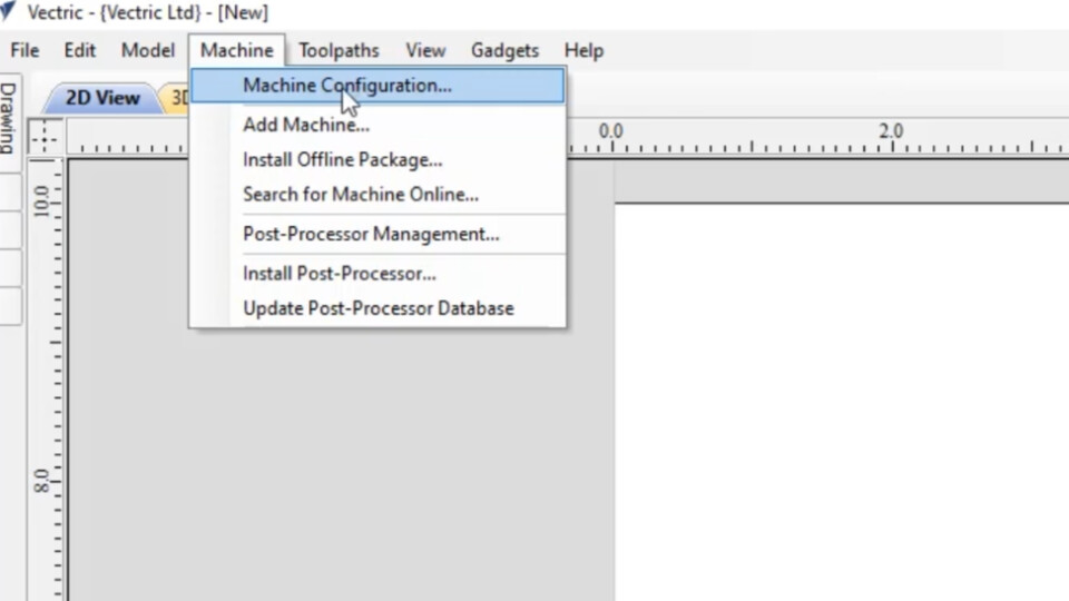

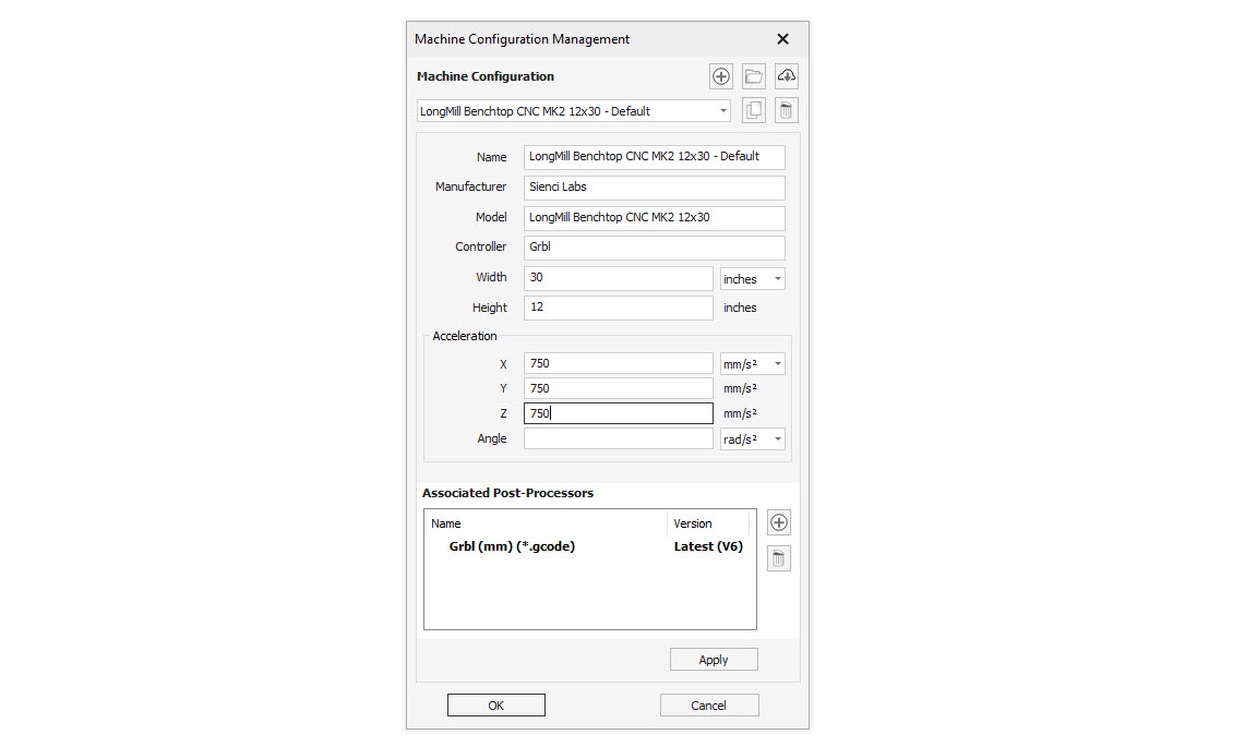

Vectric Machine Configuration
If you are using Vectric VCarve, you can create a custom machine configuration file so you can assign a default post-processor for your CNC. Go to Machine, and in the drop down select Machine Configuration.
For the latest version of VCarve, please input all the LongMill accelerations as 750mm/s² and AltMill accelerations as 1500 mm/s². If not using these CNCs, consult your manufacturer for your recommended motor speeds.
