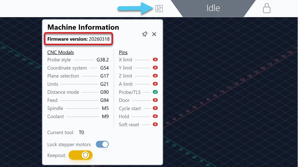

  4. Check your controller firmware by clicking on the machine information icon, and verifying version 20260525 is installed.
    If not, please update by following the instructions here, or watch the firmware update video below, then come back for the next step.

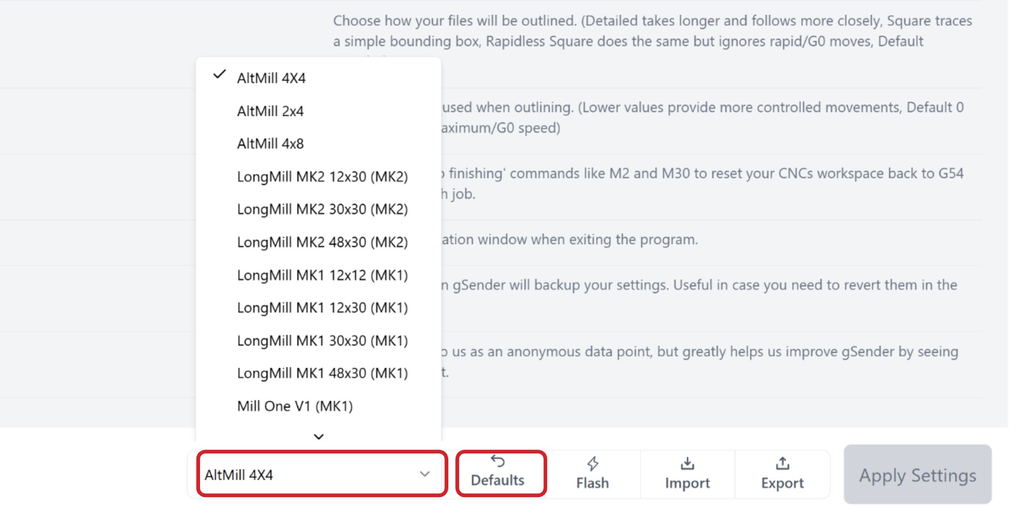

  5. Apply the appropriate machine profile in gSender. Make sure you turn OFF/ON the controller to have any changes take effect.

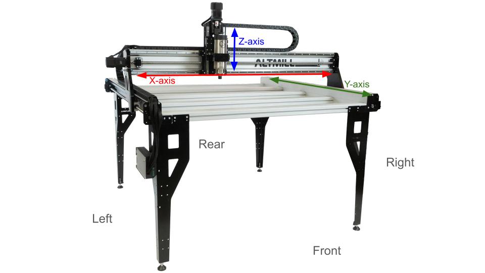

  • Machine orientation follows this photo:

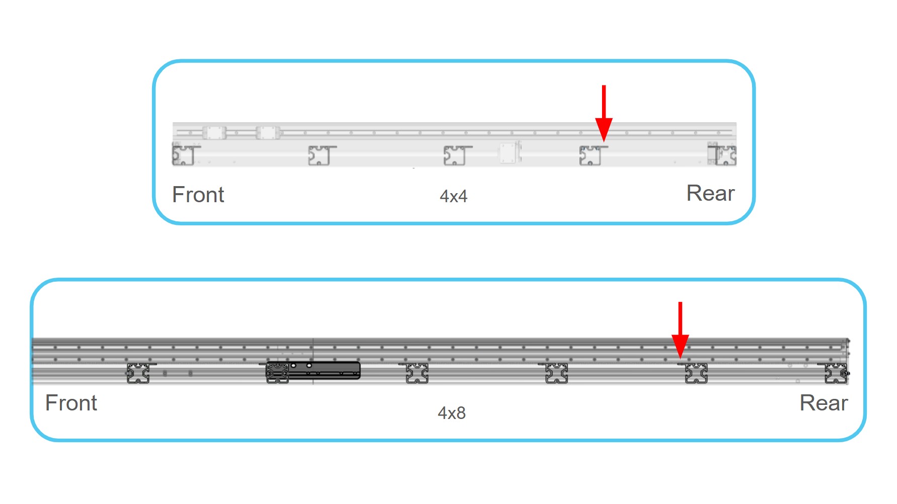

  2. Verify that the second-to-last crossbeam on your AltMill is oriented correctly. The flange should face the rear of the machine, unless you have a 4×8 machine, in which case it should face the front.
