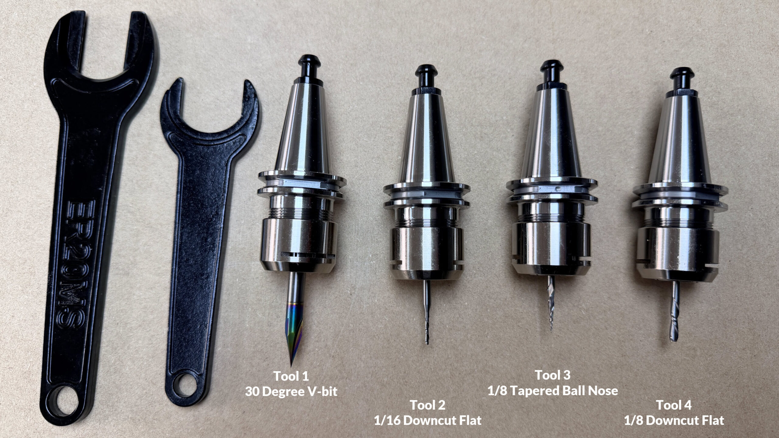

Tools for This Project
We’ll load the following end mills into the tool holders, then place them into the rack. Confirm their positions are correct once loaded. Feel free to swap out different bits if you don’t have the ones we’ve selected for this project. Just make sure you tweak the tool and toolpaths in the files found above before running your project!
Tool 1 (leftmost position)
1/4 30° V-bit for engraving the fine text
Tool 2
1/16″ downcut end mill for pocketing large blocky text (1/8 shaft)
Tool 3
1/8 Tapered Ball Nose for fun times and fine text
Tool 4
1/8″ downcut end mill to cut out the cookies

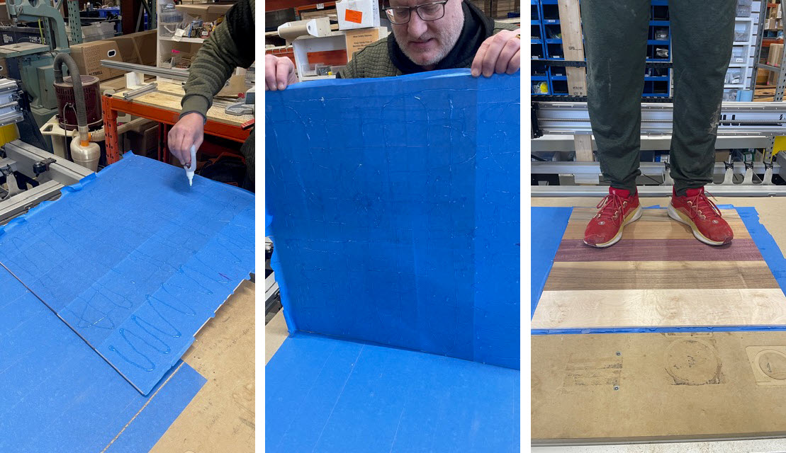

We’ll use the tape-and-glue method for workholding in this project. If you’re unfamiliar with this approach, see the Fundamentals of Workholding for a quick overview.

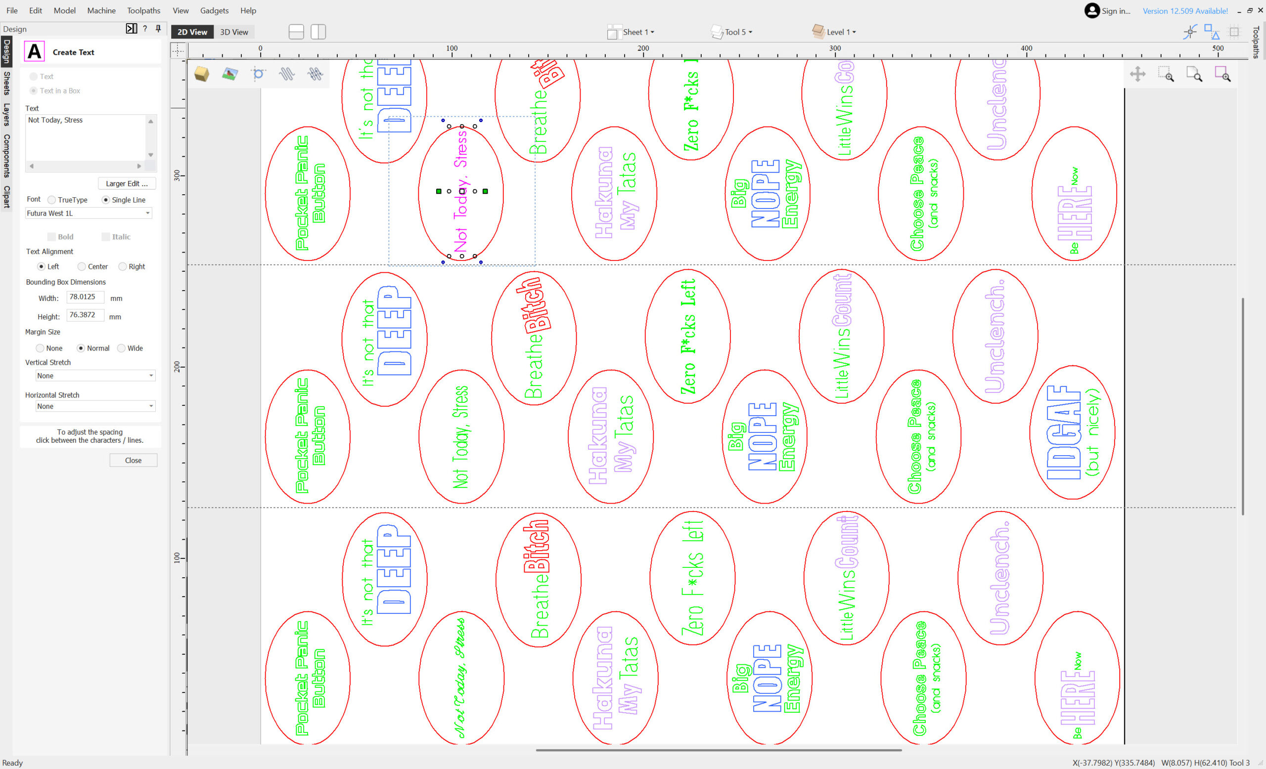

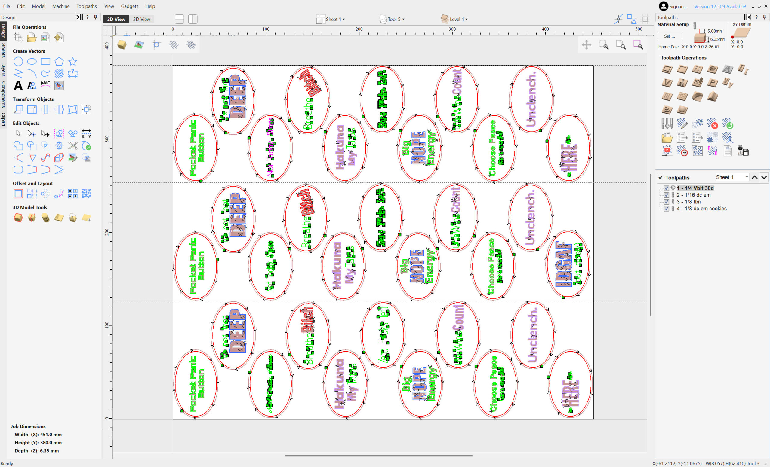

We are using Vetric’s V-Carve Pro for the design and toolpath sections of this project. We’ve lined up the boards and placed offsetting circles (cookies) into the design. Next we added our text, sized it down and rotated it 90 degrees to fit our cookies.
We’ll keep everything simple and clean. This is a function test, not a design challenge.
Creating Toolpaths

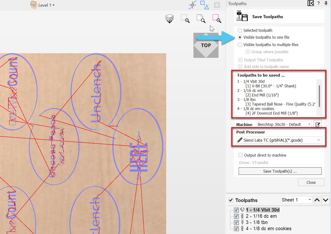

This design incorporates more tools and toolpaths than you would usually use. Remember, we are testing out the new ATC system, not being as efficient as possible here. We have 4 toolpaths planned, let’s check them out.
  1. We’ll select the single line text and create a profile toolpath using Tool 1. We’ll set a conservative depth. Light engraving is ideal for this first run. Ensure you have the Machine Vectors set to ON.
  2. Select the large text and the 1/16th bit with a pocket toolpath.
  3. Use the 1/8 tapered ball nose bit for the smaller text with a pocket toolpath.

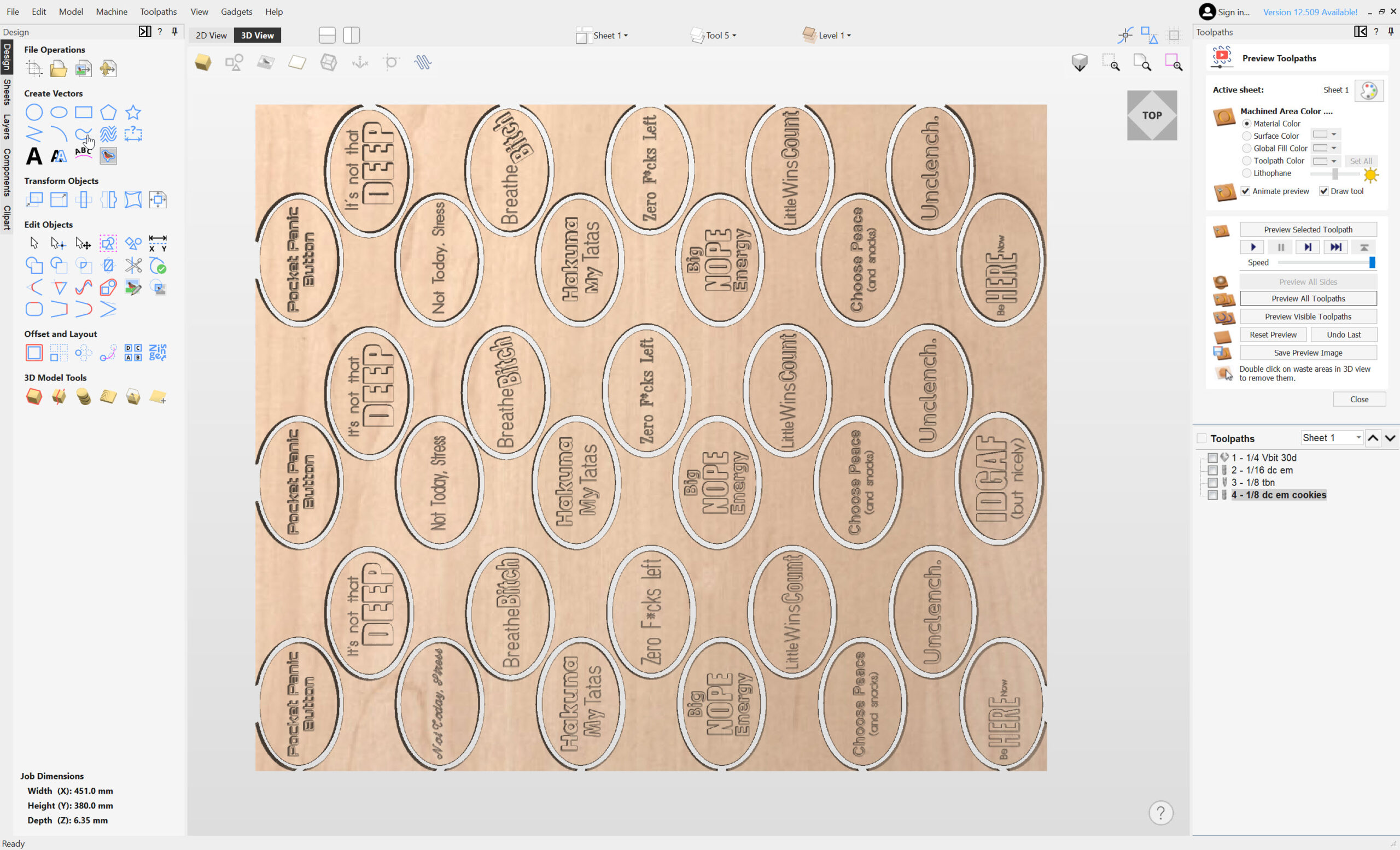

  4. Finally, we’ll create the profile toolpath for the cookie circle using Tool 4. We’ll cut outside the vector and through the full material thickness. We’ll be using the tap/glue method, so no need to add tabs to hold the parts in place.The engraving should run before this profile cut.
I’ve named each toolpath with the corresponding tool number, in the order I’d like them to carve. Let’s preview all of the toolpaths!

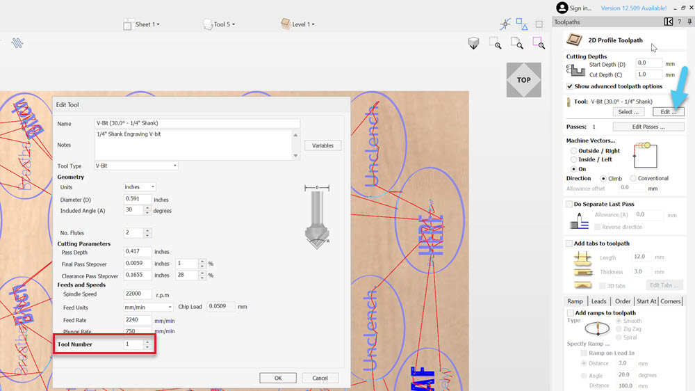

Tools & Numbers
We have all of our toolpaths created and our tools chosen, so let’s ensure the tools are setup with the correct tool numbers. Double click on your toolpath, then hit the edit button to bring up your tool. You can select the tool number you want in the bottom of the edit tool section.
Repeat this for each tool/toolpath, 1 through 4.
Now that we’ve confirmed each tool has a unique tool number, we can save all toolpaths to one file. Then we’ll export using the Sienci post-processor.

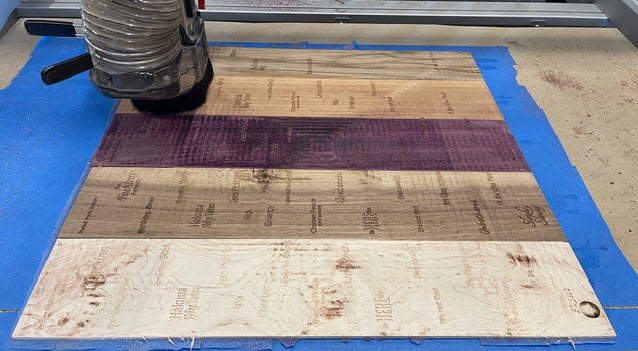

  1. Set up any workholding to secure your material on the wasteboard. In these pictures we are using the tape/glue method, with 5 boards! Read more about Workholding.

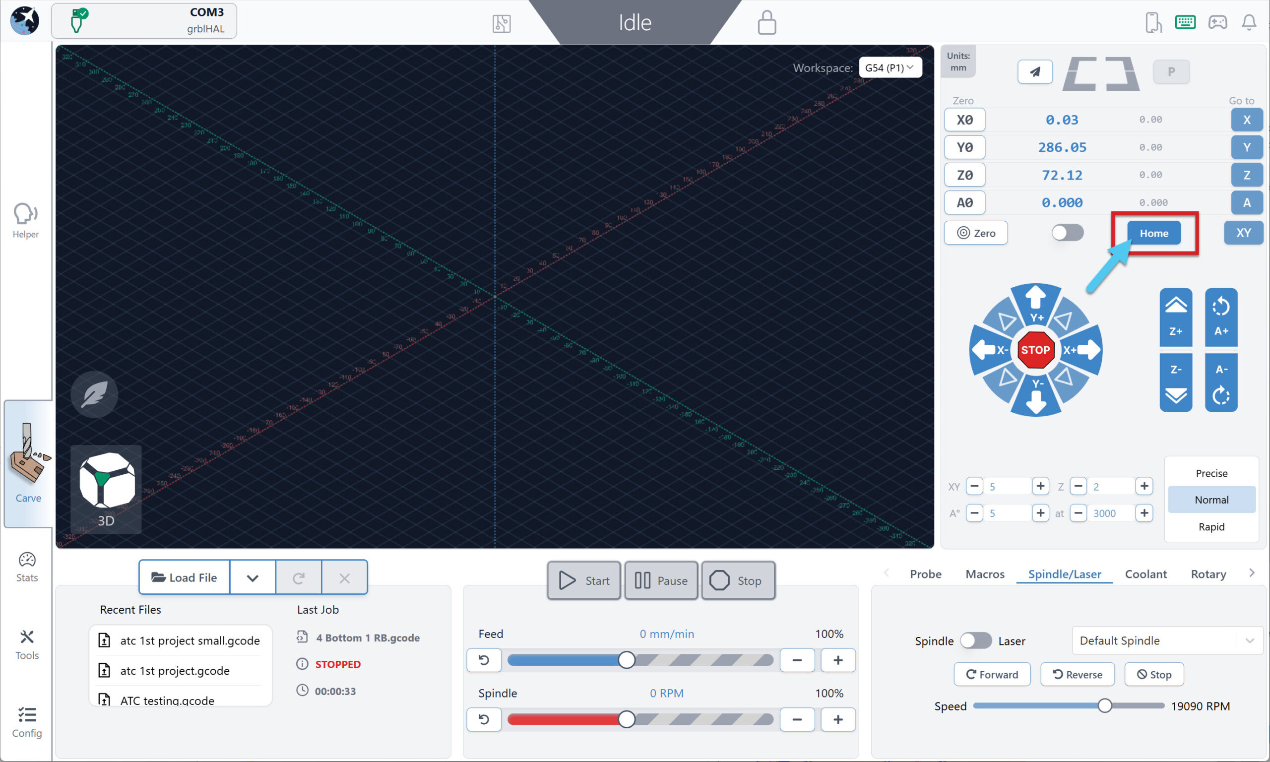

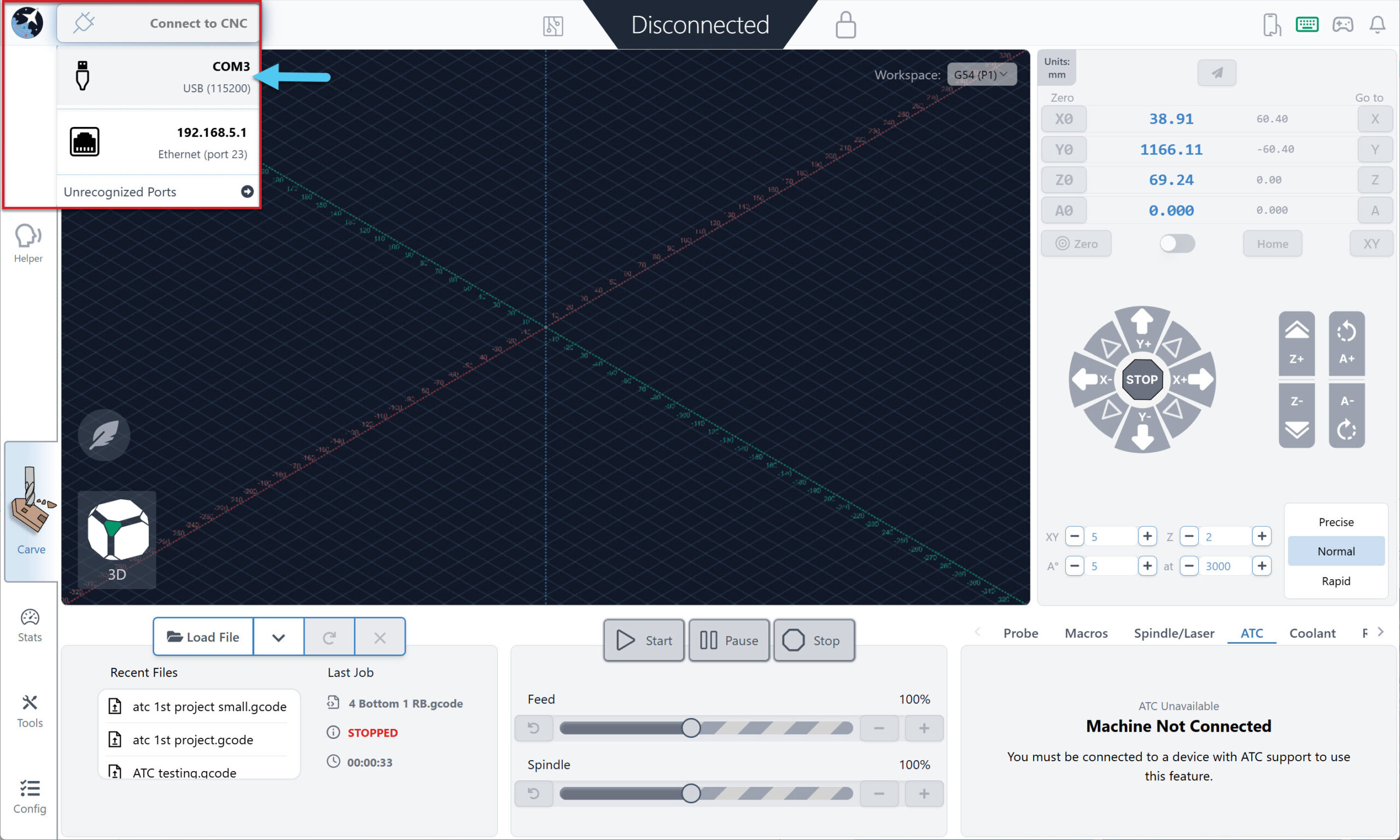

  2. Connect to gSender via USB.
  3. Home the machine.

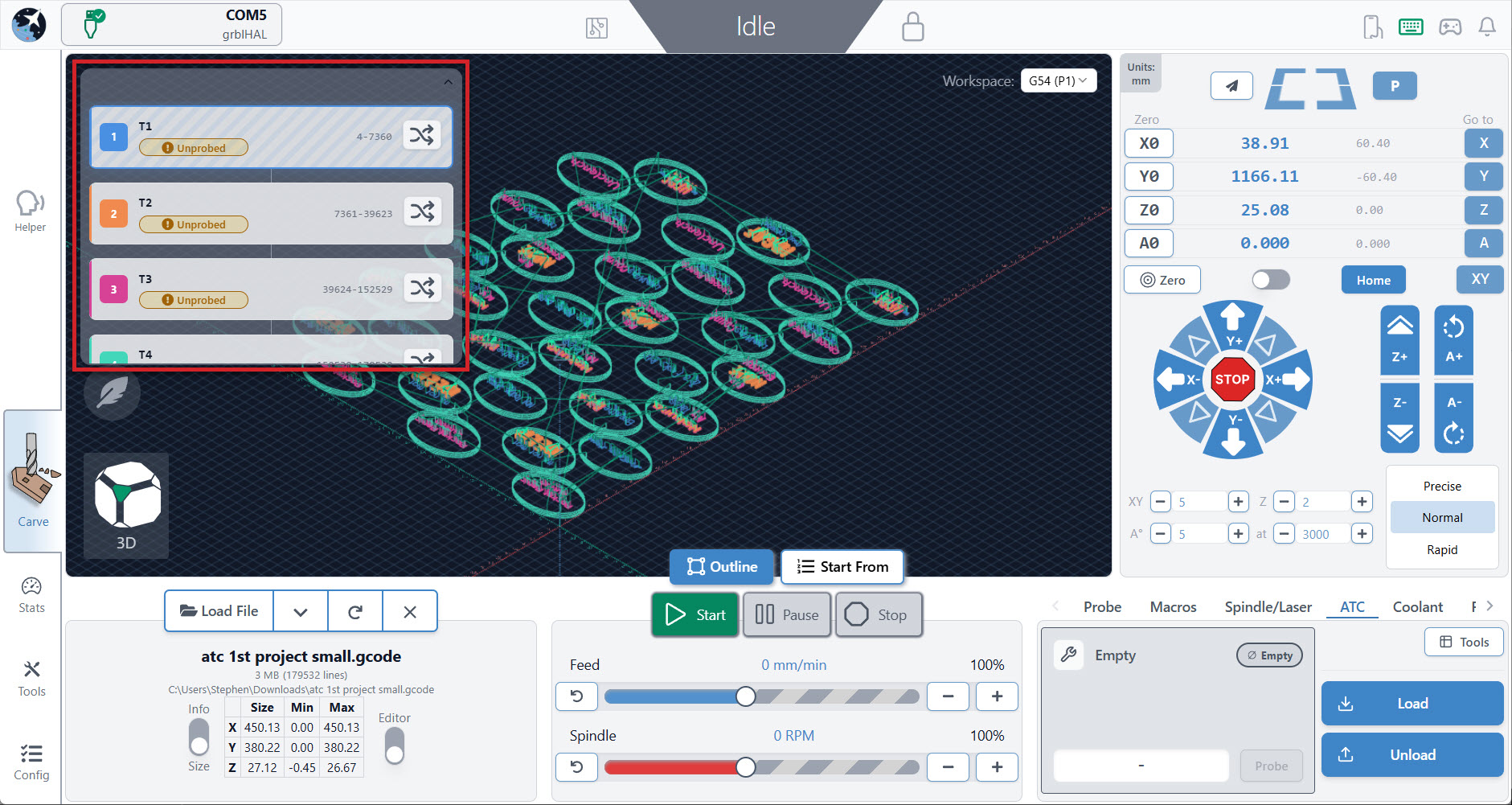

  4. Load your job onto gSender.
    • Use the Load File button to select your g-code file
    • You should see a “Tool Timeline” with the different toolpaths highlighted in various colours, corresponding to the toolpath colours on the visualizer

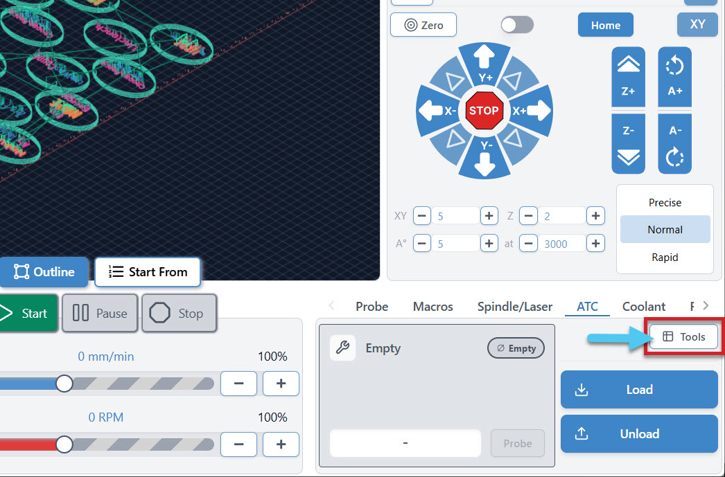

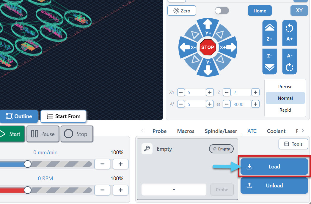

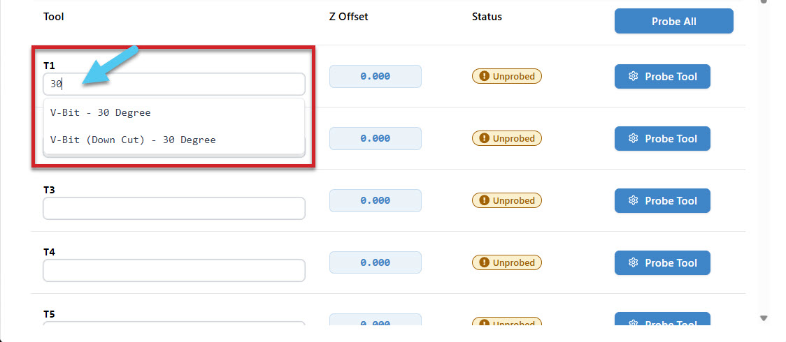

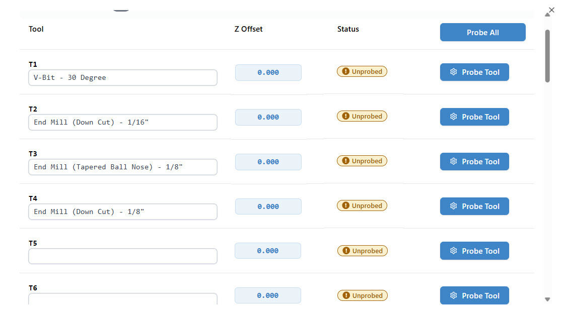

  5. Navigate to the carve page and the ATC tab on the far right corner. Hit the Tools button.
  6. This brings up the Tool table that allows you to specify each tool name by typing it in, or selecting one from the drop down menu.
  7. Once the tool name is complete, you can hit the probe tool button on the right side, and run a probe of the tools length, but you don’t need to! For now, your default settings are setup to probe each tool after it’s been picked up, so you don’t need to probe them all now. The probe measurements will all be stored, to be used later once we set our project zero. We have named all 4 tools and can now exit this screen.
  8. Load a tool onto the spindle to set our project zero with.
    • Choose a tool from your rack that has a symmetric, flat end, like a standard flat end mill
    • Press Load and select the correct tool number
Note: You can hold the load button down to trigger a manual load. You will see the button scroll loading up, once complete you are in manual load mode!
  1. Remove the bottom of the dust shoe so you can see the end mill and Jog the machine to where you want the job to start on your material, then use the X0 and Y0 buttons to zero each axis. We’ve set the design file to zero on the wasteboard, as we are cutting through material. Ensure you set your Z0 to the wasteboard, not the top of the project. If you don’t, you will be cutting in air!

    We are about ready to start cutting! Check the Tool Timeline to see if the order of toolpaths and their tool number are correct.

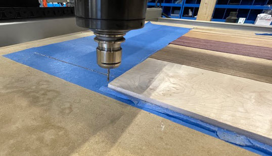

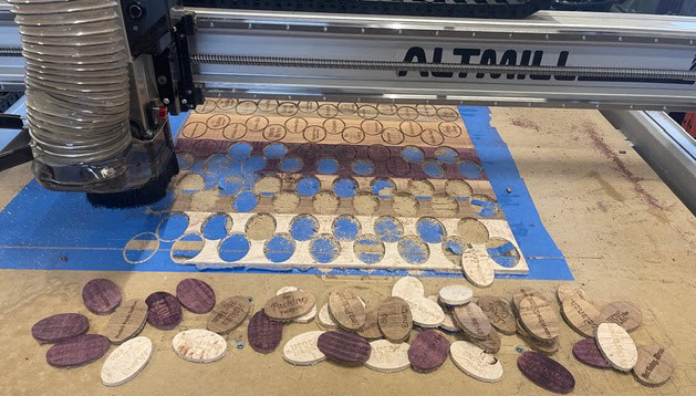

    Friendly reminder to turn on your dust collection at this point! When we start the program, the machine will begin with the V-bit. Once complete, the spindle will stop, return to the rack, perform the tool change, and pick up the 1/16 downcut end mill, tap on the tls then, continue the cut.

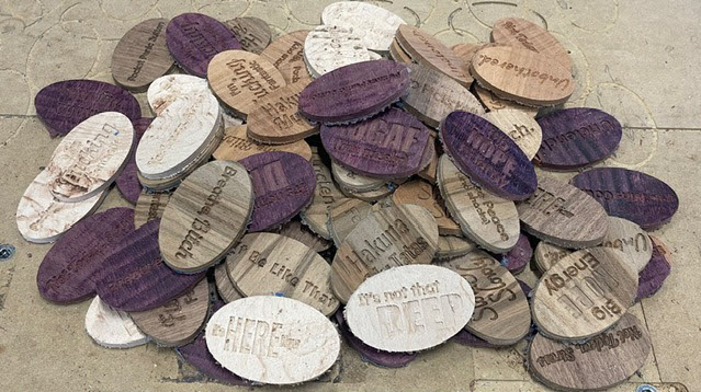

    We’ll watch the first tool change closely. We should see a smooth release and pickup with no hesitation or vibration. We won’t interrupt the process unless something clearly goes wrong. Pictured is our test run of 5 boards!

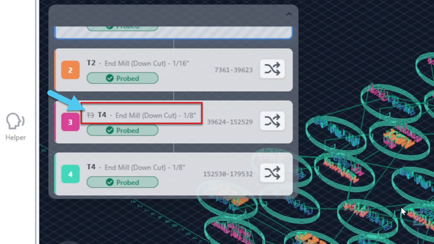

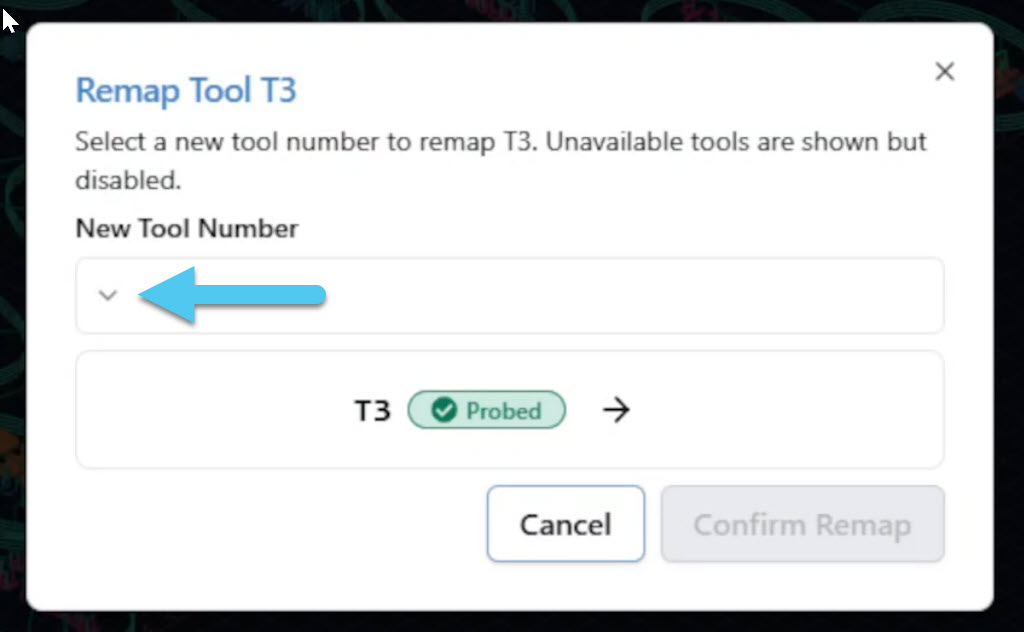

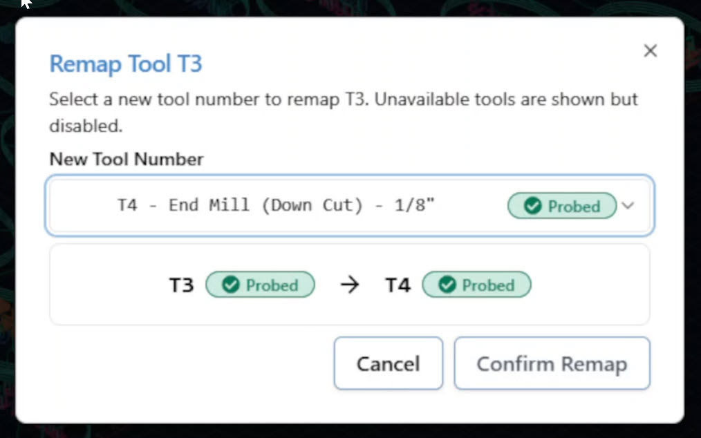

You may find that you have made a mistake with your tool numbers/placement in the tool rack. If you want to swap out a tool, without manually changing the placement, you can remap on the software side!

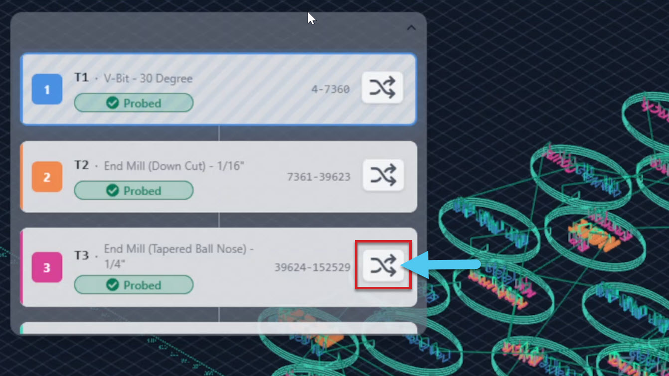

  1. On the tool timeline, press the remapping button for the tool you want to remap. In the image below we are remapping tool 3.
  2. This will bring up a popup that allows you to select a new tool in the dropdown menu.
  3. Select the tool you want, and you will see it ready to confirm your selection.
  4. Once successfully remapped, you can see the edit in the tool timeline is reflected and now tool 3 is using tool 4, without swapping out the tool holders physically.
After Cutting
Once the job is complete, we’ll lightly sand the edges. We can leave the cookies natural, paint-fill the engraving, or apply a clear finish.
The final look is up to you. What matters here is that all tools ran correctly and the tool changes happened automatically.
