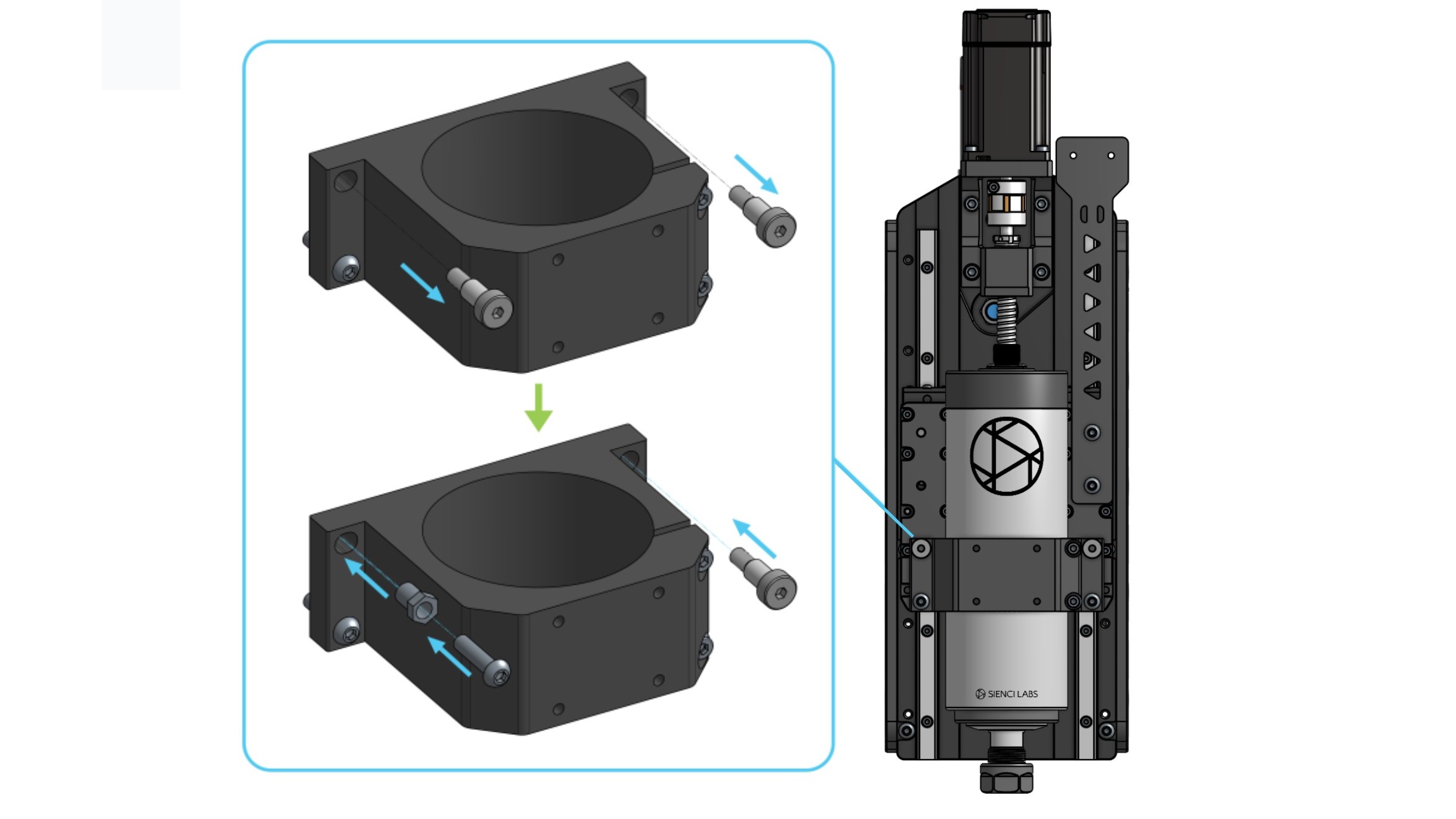

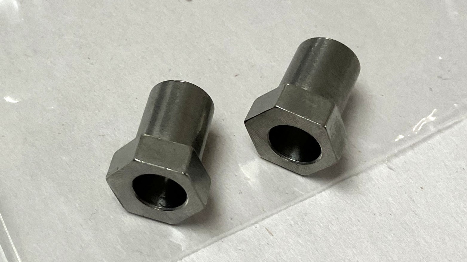

1. Take out the bag of eccentric bushings that came with your machine.
2. Swap the left shoulder screw, to use one (1)  eccentric bushing, and an M6-25mm button head cap screw inside this hole instead. Slightly loosen all four screws securing the spindle mount to allow the mount to pivot.
3. To finely adjust the tram of the spindle, use the small end of the included AltMill wrench to carefully rotate the hex of the eccentric bushing as shown below. Depending on where the eccentric bushing is angled, turning the wrench will cause the spindle to move some small amount.
4. For very fine adjustment, it may sometimes be necessary to gently knock the top of the spindle with a small rubber mallet, or the back of a screwdriver handle. Once finished, simply tighten all four screws.

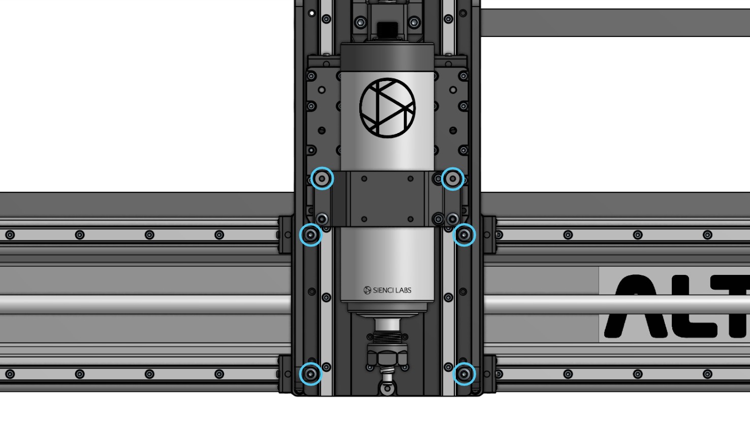

1. Jog the machine upwards to access mounting screws.
2. Loosen the 2 shoulder bolts, and the 4 mounting screws. Do not remove them.
4. Use shim stock or a cheap set of feeler gauges for your adjustment.
To adjust:
  • To tilt the spindle forward, shim beside the 2 top screws in between the plates
  • To tilt the spindle backward, shim beside the 2 bottom screws in between the plates
5. Tighten the screws and shoulder bolts.
