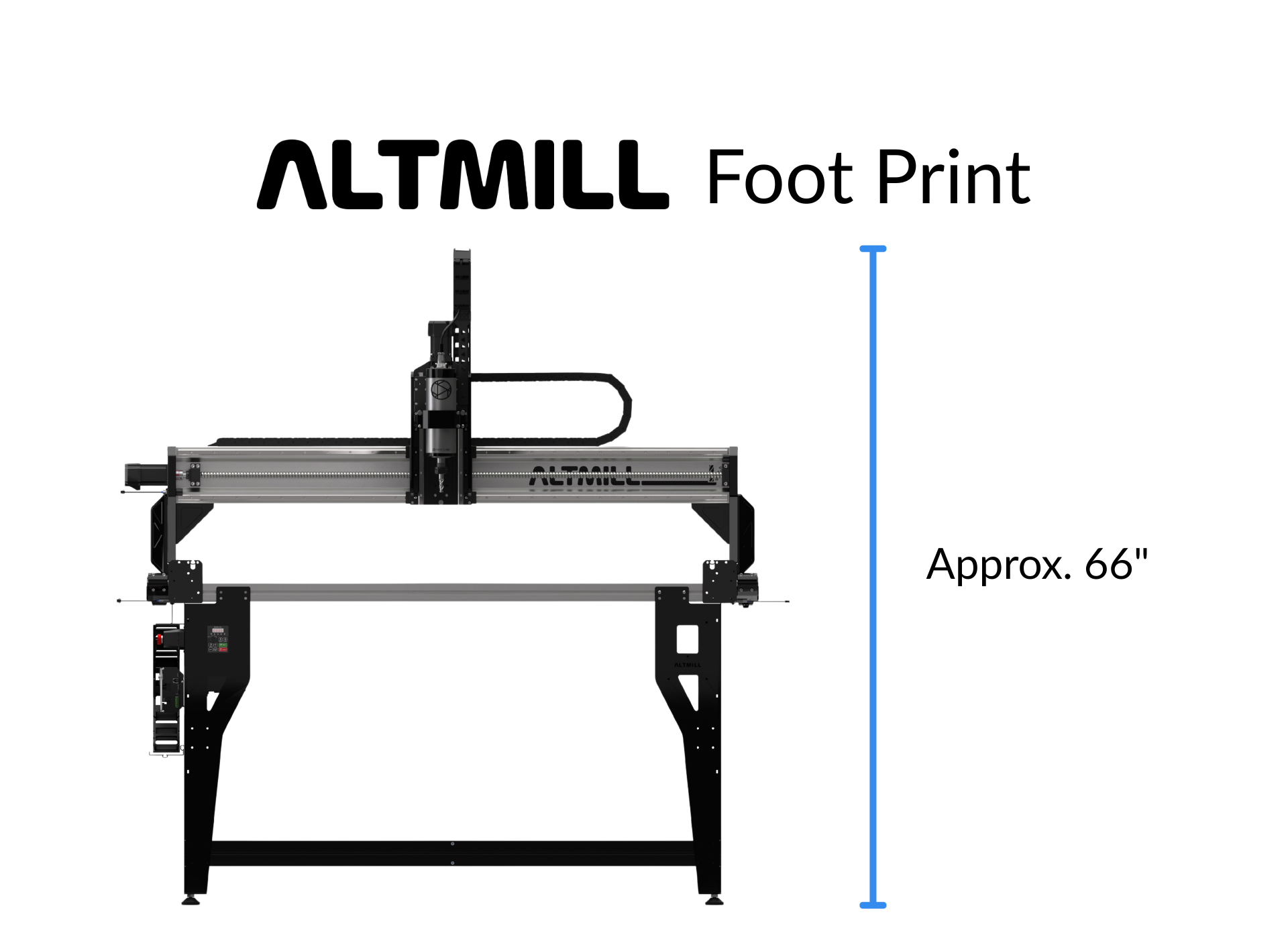

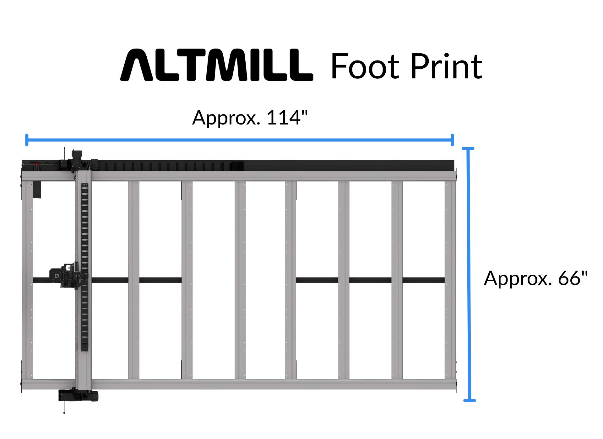

- Ensure that you allocate at least 6’x12’ of space for assembly
- When assembled, position the machine so you can load 4’x8′ sheets from the ends and sides of your machine
- Do not put the rear end of the machine against a wall, since the Y-axis drag chain will extend back by ~14” when jogged to the back.

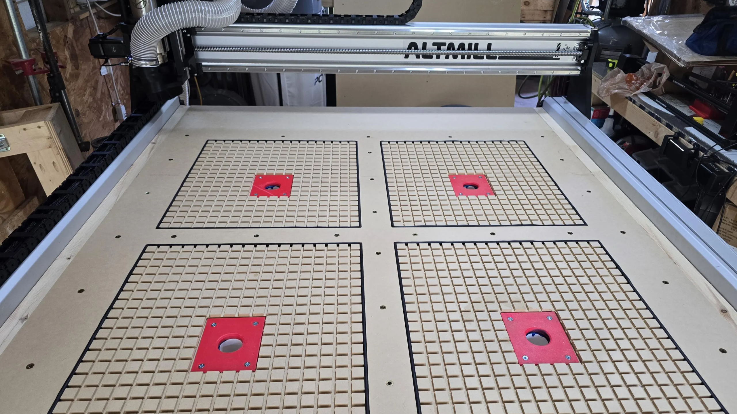

Workholding
The AltMill 4×8 comes with a sturdy frame that you can mount a table surface and wasteboard to. The ¾” thick MDF sheet (purchased separately) will act as the table surface. The wasteboard is mounted on top of the table surface, and can be fully customized to suit your application, allowing for various workholding options to be implemented. The article here explains the most common workholding options used in consumer-level CNCing. If you are planning to load 4×8 sheets, a vacuum table may be the best option as it can provide equal clamping on the entire surface of the material, minimizing warp and therefore improving the repeatability of the cuts.
Vacuum table design by boricuahastaenlaluna (Emanuel Ortiz) on Etsy
