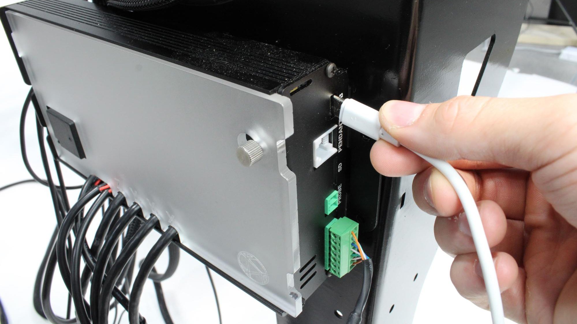

5. Remove the front cover of the controller to access the control board. Plug the motor connectors from the motor cables, paying special attention to the axis-specific sensor and signal ports. Plugging the cables into the wrong axis ports will cause issues!
6. Route the cables through the opening on the right side of the controller enclosure, then put the front cover back on.
7. Plug in the other end of the spindle cable into the bottom of the VFD, minding the keyed features. Turn the ring on the connector to fully secure the spindle cable.
8. Plug in the VFD power cable into the bottom of the VFD, and to the appropriate electrical outlet in your shop.
9. Plug the E-stop cable into the E-stop and controller.
10. Plug the RS14 (signal) cable into the RS485 port at the controller and bottom of the VFD.

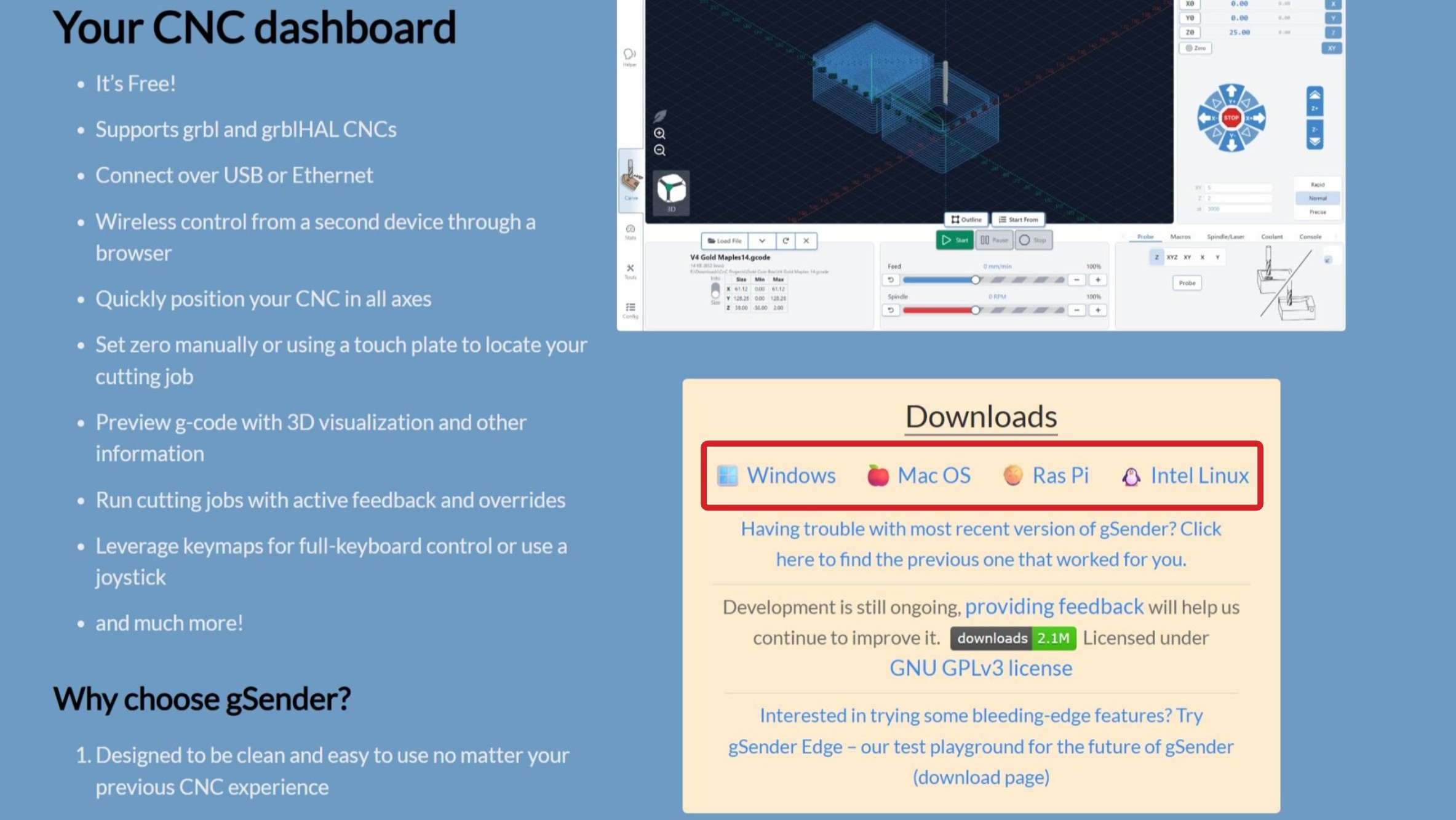

2. If you haven’t yet, download gSender.
For detailed, step-by-step instructions on how to download and install gSender, go to this page.

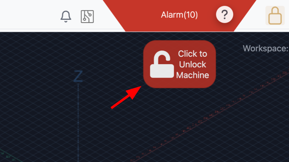

5. You will see a E-stop alarm. Clear the alarm by pressing and releasing the E-stop button, then press the red “Click to Unlock Machine” on the screen.

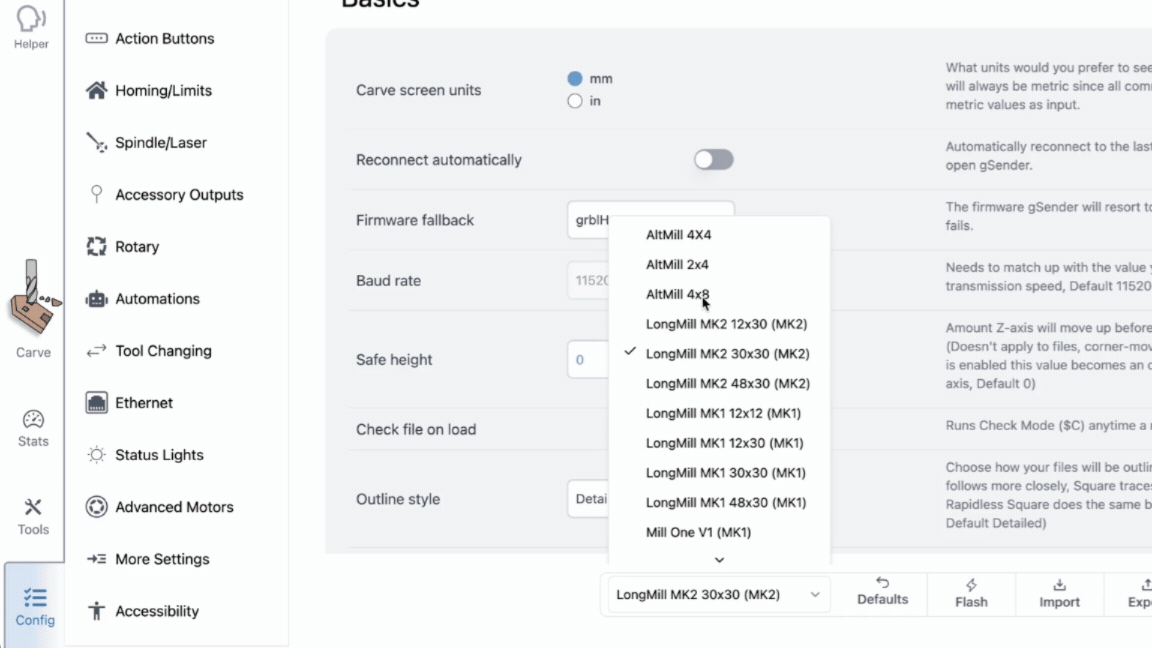

4. Go to Config, then at the bottom use the dropdown to select AltMill 4×8, then press the Defaults button. Press Restore Defaults, then turn OFF and ON your controller to have the changes take effect.
