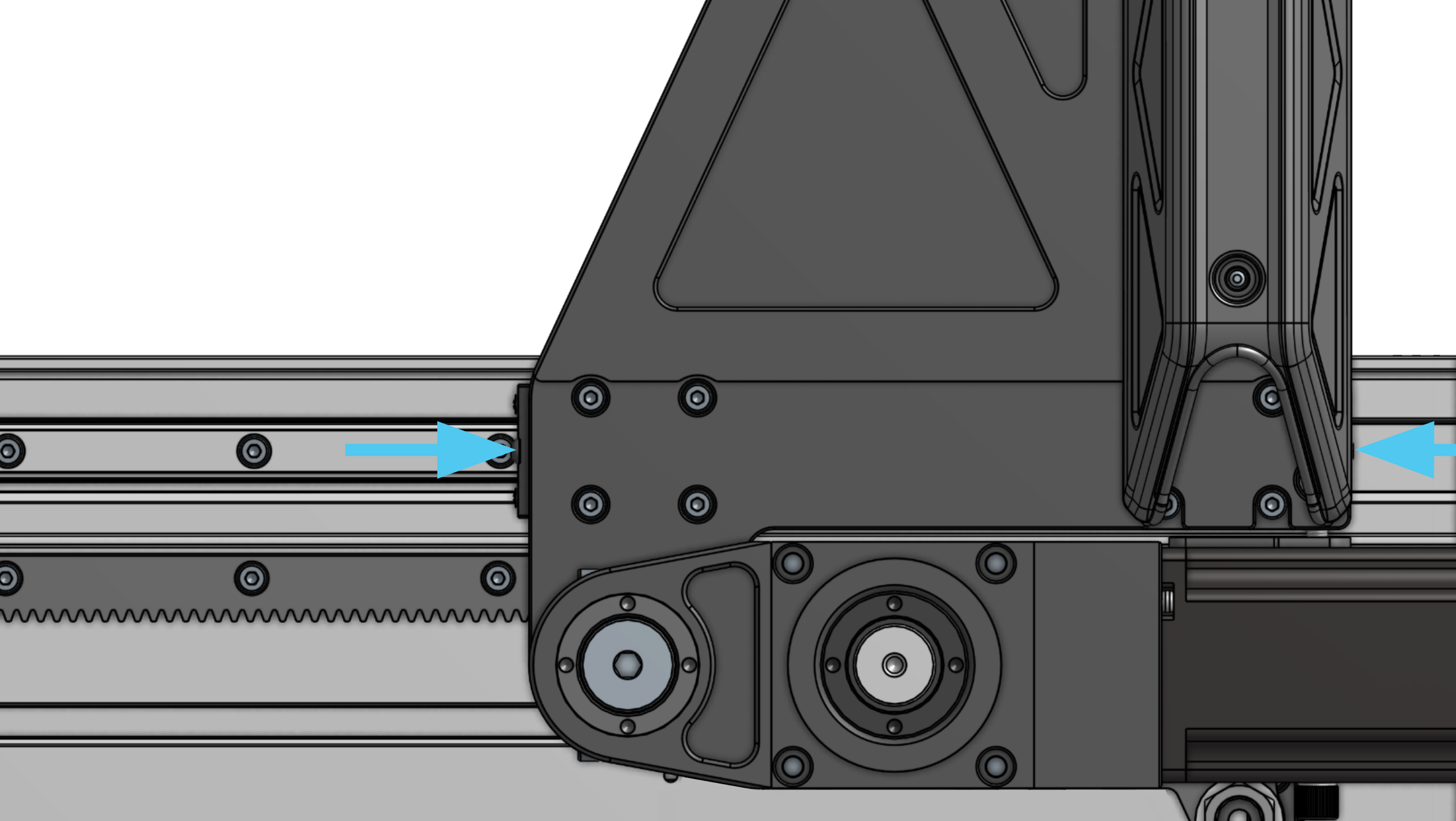

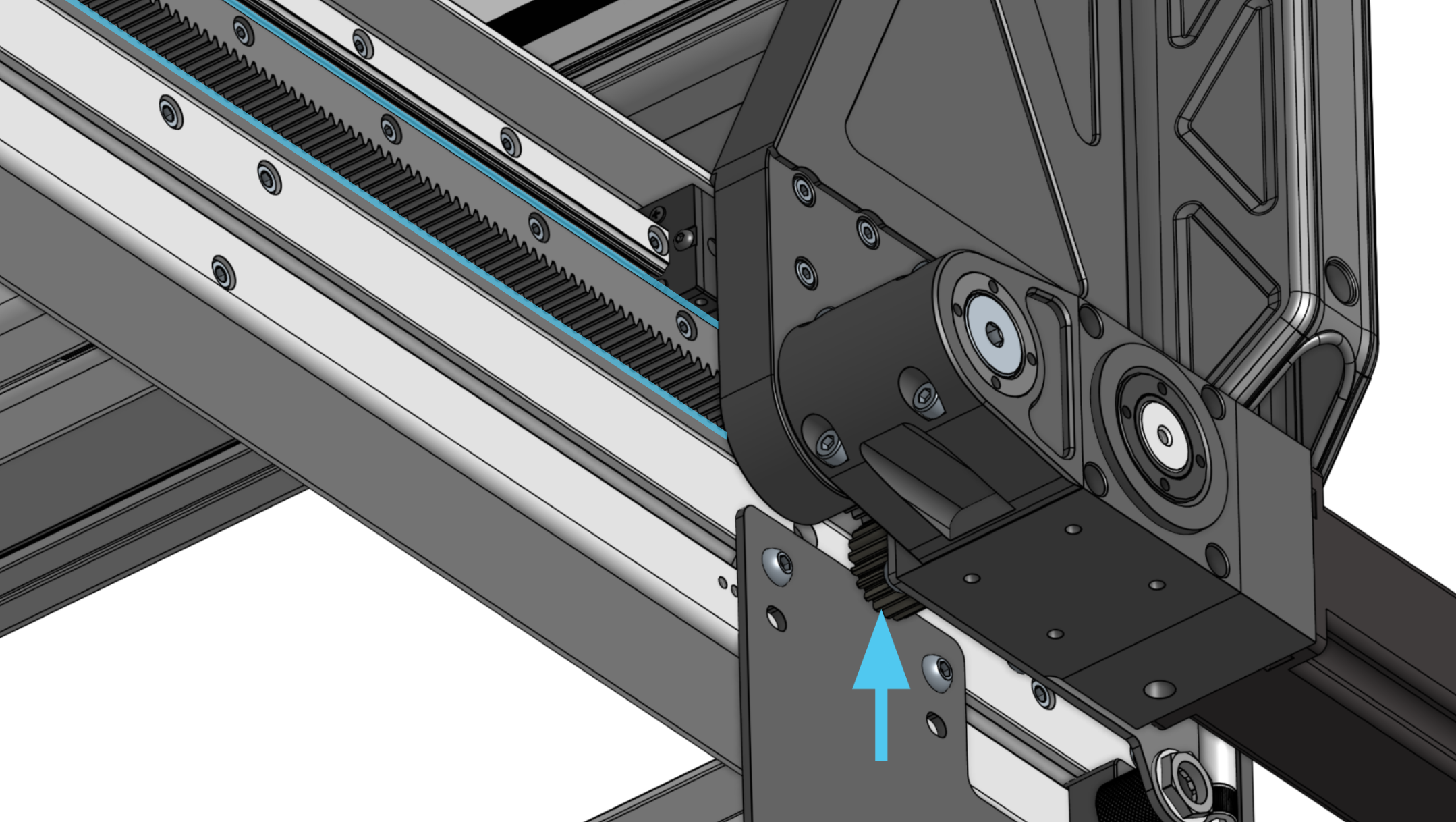

Wipe down the linear guide rails, blocks and ball screws with shop towel to remove dirt and excess grease. If there is rust, scrub down with Scotch Brite. Remove debris from the ball screw by using a soft brush to get into the threads. Jog the machine to access the entire rail for thorough cleaning. Use nylon wire brush to clean the rack and pinion (you do not need to remove the housing, the pinion should be accessible from the bottom of the Y-gantry).

Rack Lubrication
Do this every 160 hours of usage. If you are running the machine 8 hours a day, 5 days a week, you should be greasing every 4 weeks.

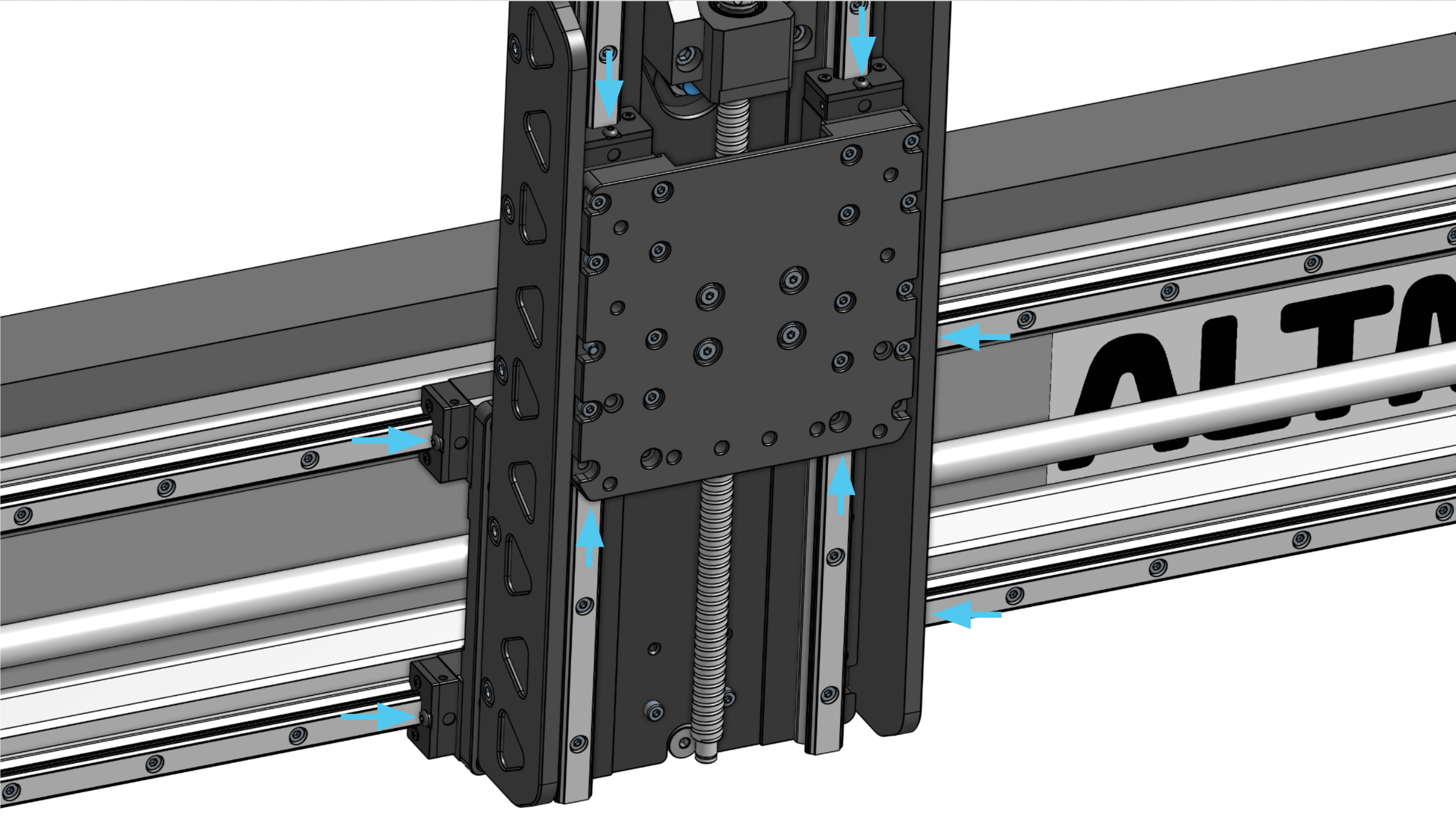

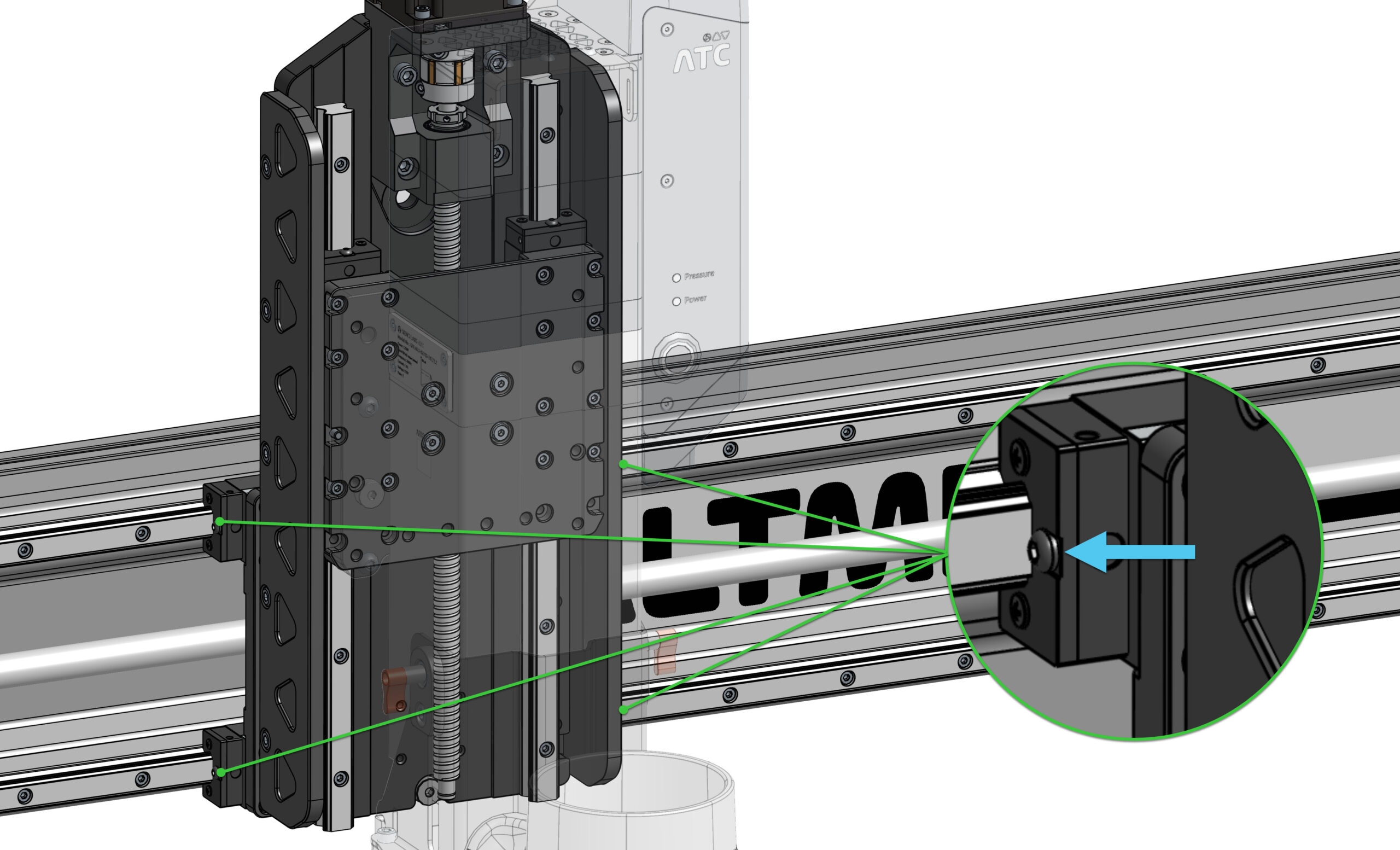

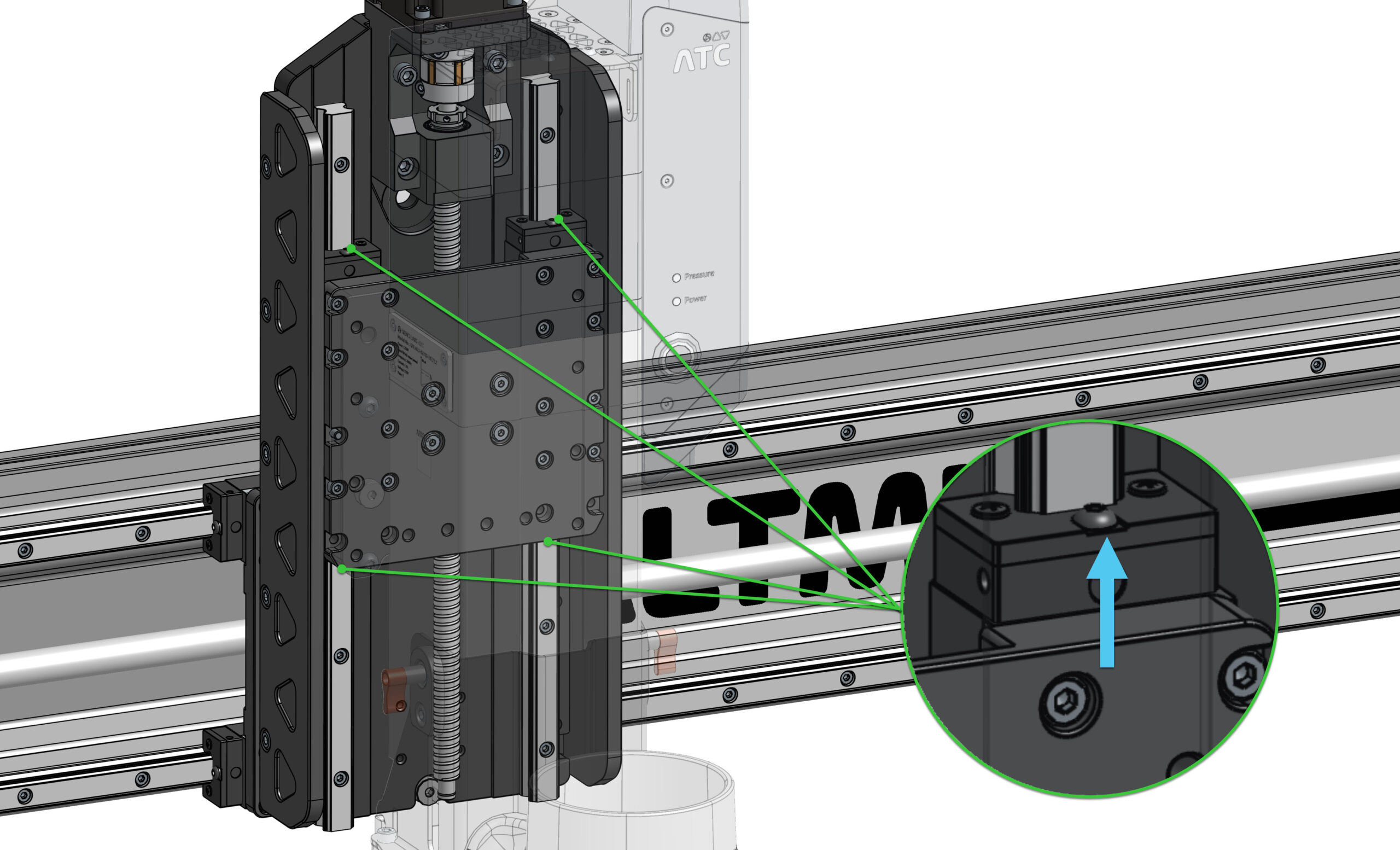

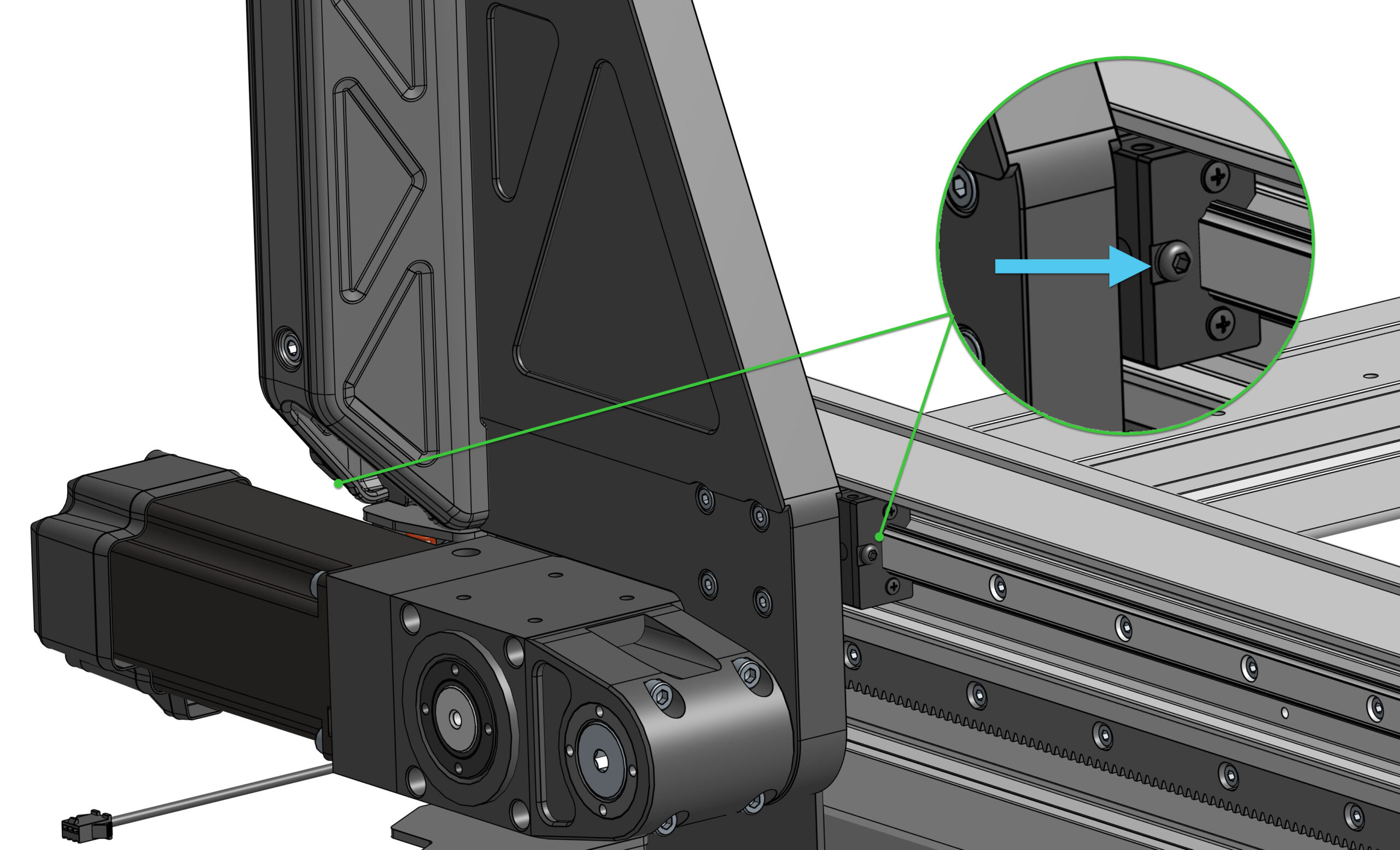

Linear Guides Lubrication
If you used 3-in-1 or Mobil Vactra #2 oil in the past, feel free to continue using that on the linear guides. Otherwise, follow the instructions below for the grease gun with lithium grease:

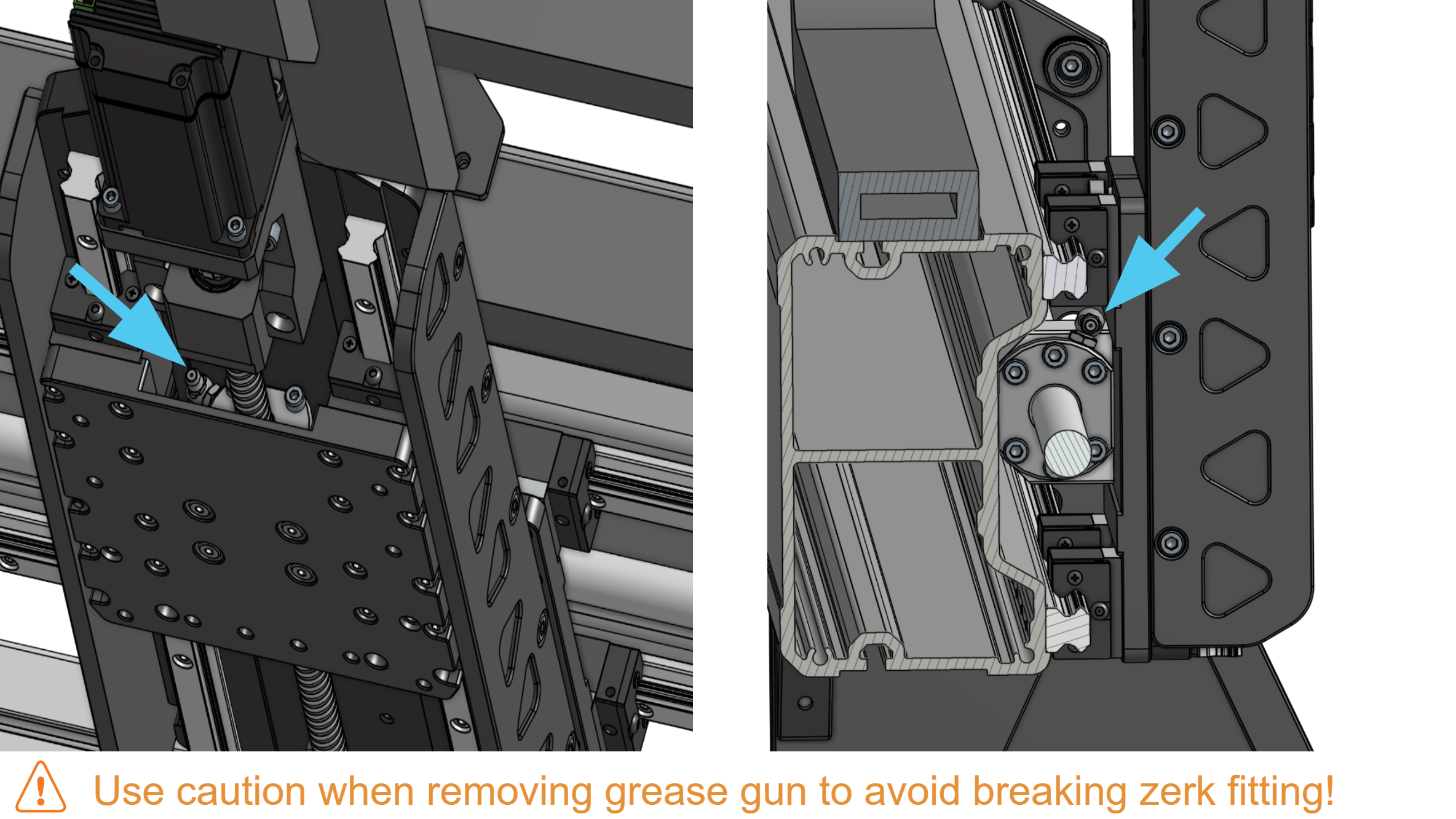

1. For the Z-axis, first jog to the top to get access to the screws
2. Remove one (1) screw from each linear guide block using the Allen key. See below for locations on each axis.
3. Push the nozzle firmly against the hole, and slowly pump until a small amount of grease comes out between the block and rail.
4. Wipe with shop towel to remove the excess.
5. Refasten the screw.
6. Jog to each end of the axis, to fully distribute the grease.
7. Repeat the above steps for each axis.
