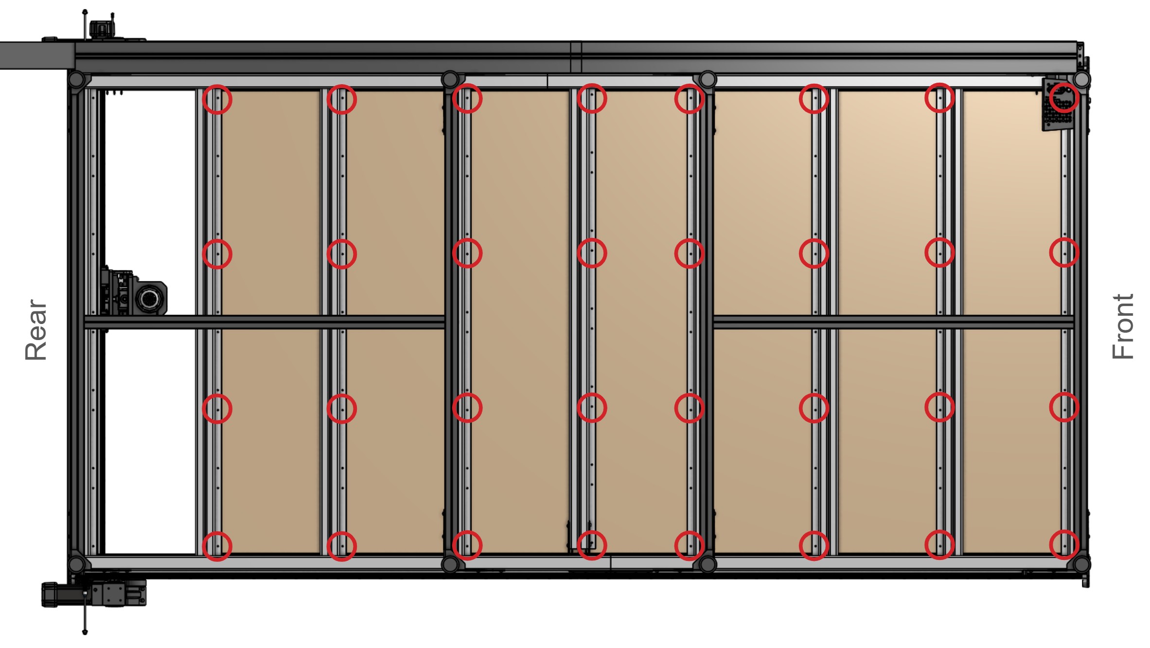

1. Prepare the MDF by cutting it to size based on your table configuration:
5’x10’x¾”
Default – 51.75″x98″
Joinery – 51.75″x95″
4’x8’x¾”
Use one (1) full sheet. Optionally, cut extra from a second sheet to reach the second-last crossbeam.
2. Lay the MDF sheet on top of the AltMill, centered between the left and right of the table, while lining up to the front of the table.
3. From underneath the table frame, install ¾” long #6 or #8 wood screws through the holes in each crossbeam and into the MDF sheet. Use the four (4) holes per crossbeam as shown.

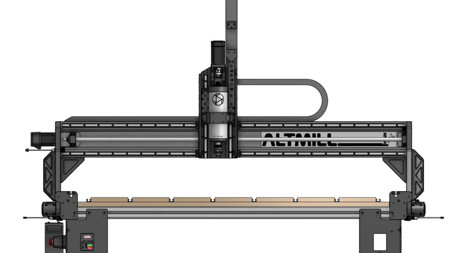

1. If you are installing the T-track set as part of your wasteboard, use another MDF sheet and cut the length to match your table surface.
2. Once cut to length, cut seven (7) ‘slat’ pieces that are ~6.125” wide.
3. Lay all 7 slat pieces and 8 T-track sections onto your table surface, lining these up with the front edge of the table.
4. Use ¾” long #6 or #8 wood screws to secure the T-tracks, and 1 ¼“ long #6 or #8 wood screws to secure the slats into the MDF table surface. You’ll want to create a recess in each slat for the heads of the wood screws, so that they sit below the top surface, as we will be surfacing these slats later on.
Once finished, you’re ready to move on to surfacing!

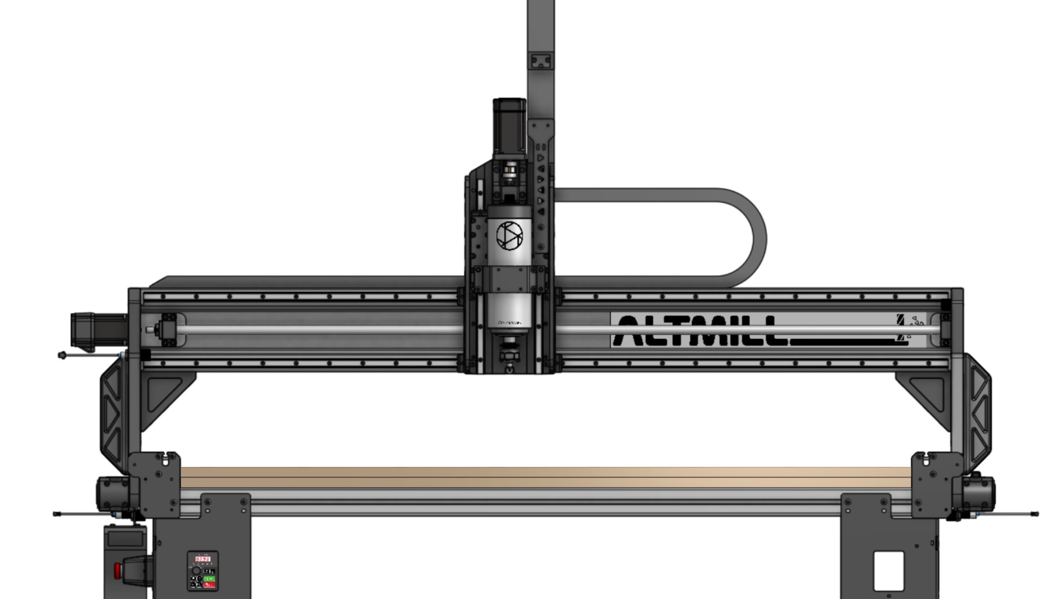

Sacrificial Sheet Installation
1. Use the second MDF sheet and cut it to size, matching the table surface.
2. Lay this MDF sheet onto the table, and secure this with wood screws placed in a grid pattern. Be sure to recess the heads of each screw below the surface of the MDF since we’ll be machining the top surface of these slats.
