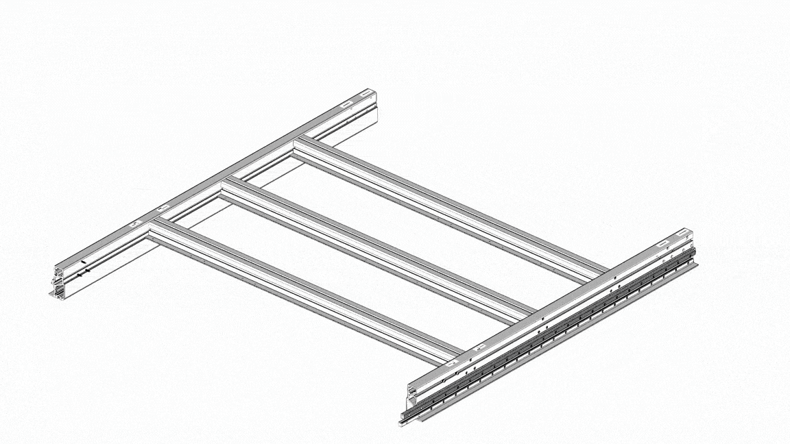

Crossbeams Assembly
1. Lay the Y-axis rails on the floor with the stickers facing up, in the correct orientation as noted by the stickers.
Y-rail Left Short           Y-rail Right Long
Y-rail Left Long            Y-rail Right Short
2. Rotate or flip the Y-rails so that the racks and the linear rails face outwards.
3. We will work on the front half of the table first, using the Left Long and Right Short rails.
Move the other rails to the side while you work on the front half. Make sure to keep their orientation.

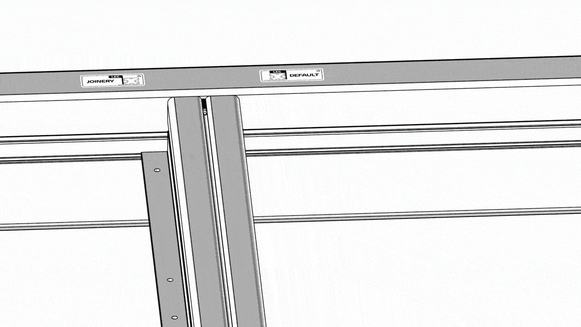

4. Lay out four (4) crossbeams between the 2 Y-rails. Orient the flange of the crossbeam so that it is pointed toward the table joint end of the Y-rails (where the linear rails and rack ends are staggered).
❗You will notice that there is one crossbeam that looks different, it has a metal bracket on it. Do not use this crossbeam until the next video, Joining the Tables.
‼️Depending on whether you’re doing default or joinery configuration, you will need to install the front crossbeam it at a different location, noted by the stickers.
5. Place the four (4) crossbeams onto the reference edge of one of the Y-rails, then loosely install M5-20mm XL SHCS into the crossbeam holes, three (3) at each crossbeam.
Move to the other side, and loosely install the screws.
Then finish fastening on both sides, using the supplied hex key, to avoid stripping the holes. Ensure that the crossbeams are contacting the Y-rail reference edge on both sides.

3. Place the two legs at the crossbeam closest to the table joint. The T-nuts from the legs should slip into the T- slot of the crossbeam and Y-rails.
❗If you are building in the  joinery configuration, install table legs on the other face of the crossbeam. This is noted by the sticker. You will need to flip the T-nuts and M6 screws on the flanges to make this work. You only need to do this once, for this set of legs.
