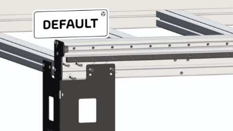

1. Use four (4) M4-18mm SHCS to install the flags onto the Y-axis rail at each corner.
Take note of the different flag positions at the front of the machine, depending on the default or joinery configuration.
2. Use eight (8) M4-18mm SHCS to install one (1) Y-gantry plate onto the linear guide blocks at the front of the machine.
Ensure the linear guide blocks are seated on the reference edge of the Y-gantry plate, then fully tighten the screws. Repeat for the other side of the machine.

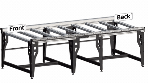

3. Place the X-axis rail assembly on the table, resting across the left and right Y-rails.
Ensure it is oriented correctly, the AltMill sticker should be upright and facing the front.
