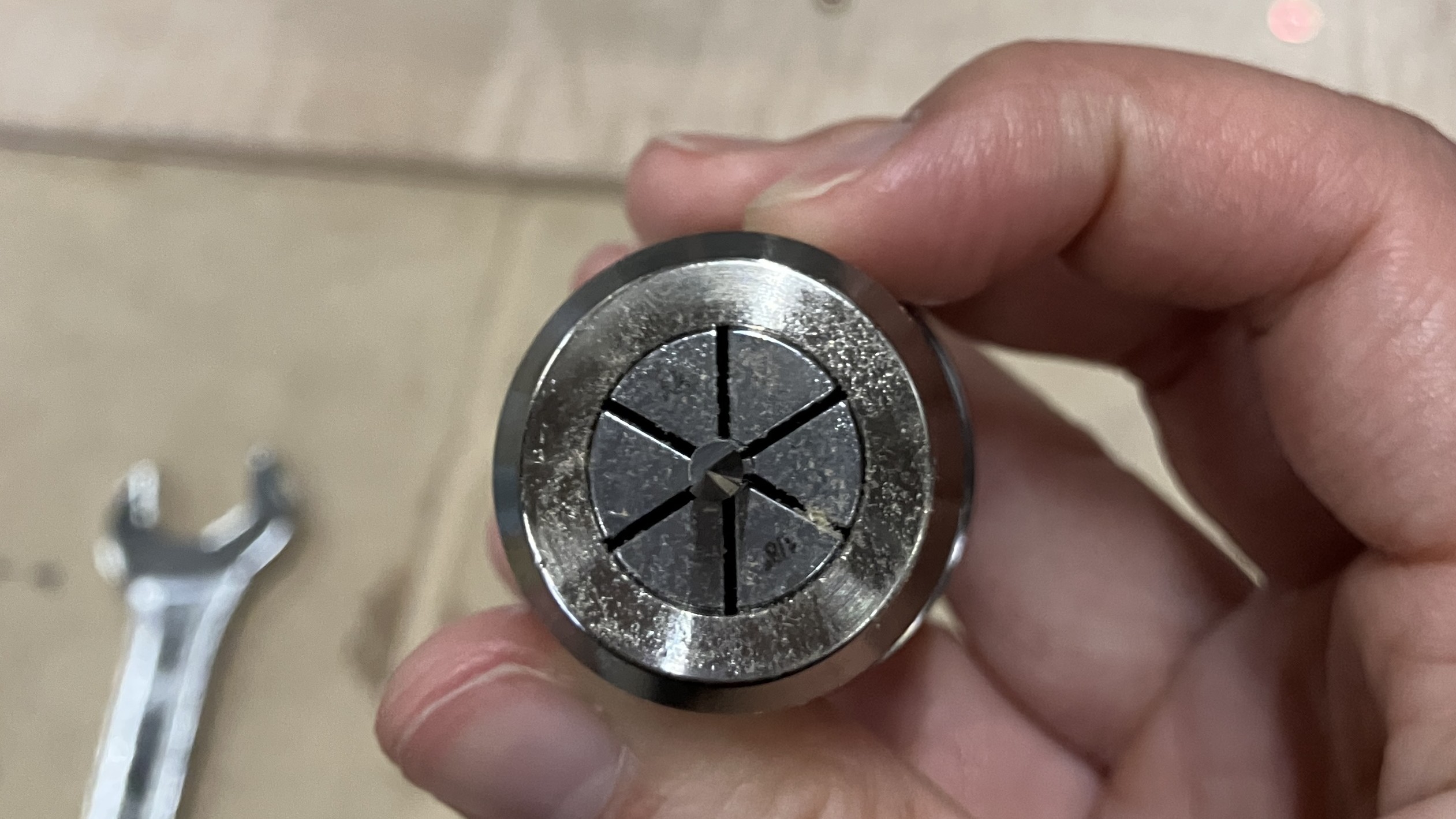

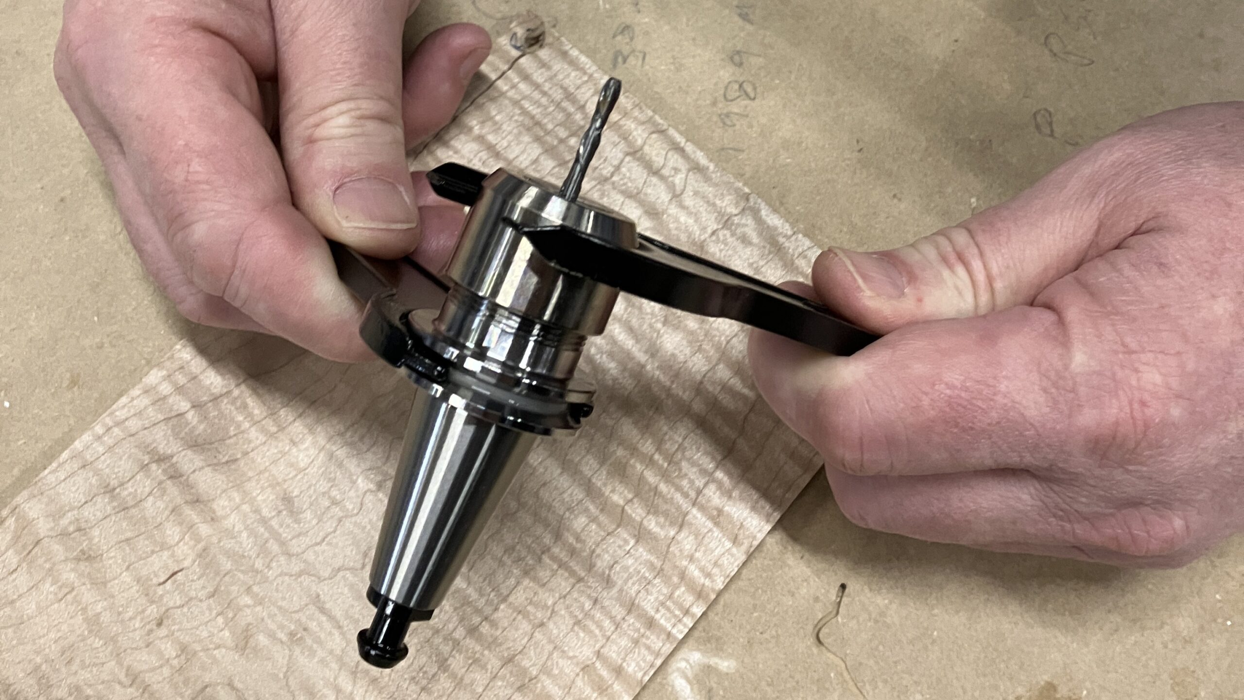

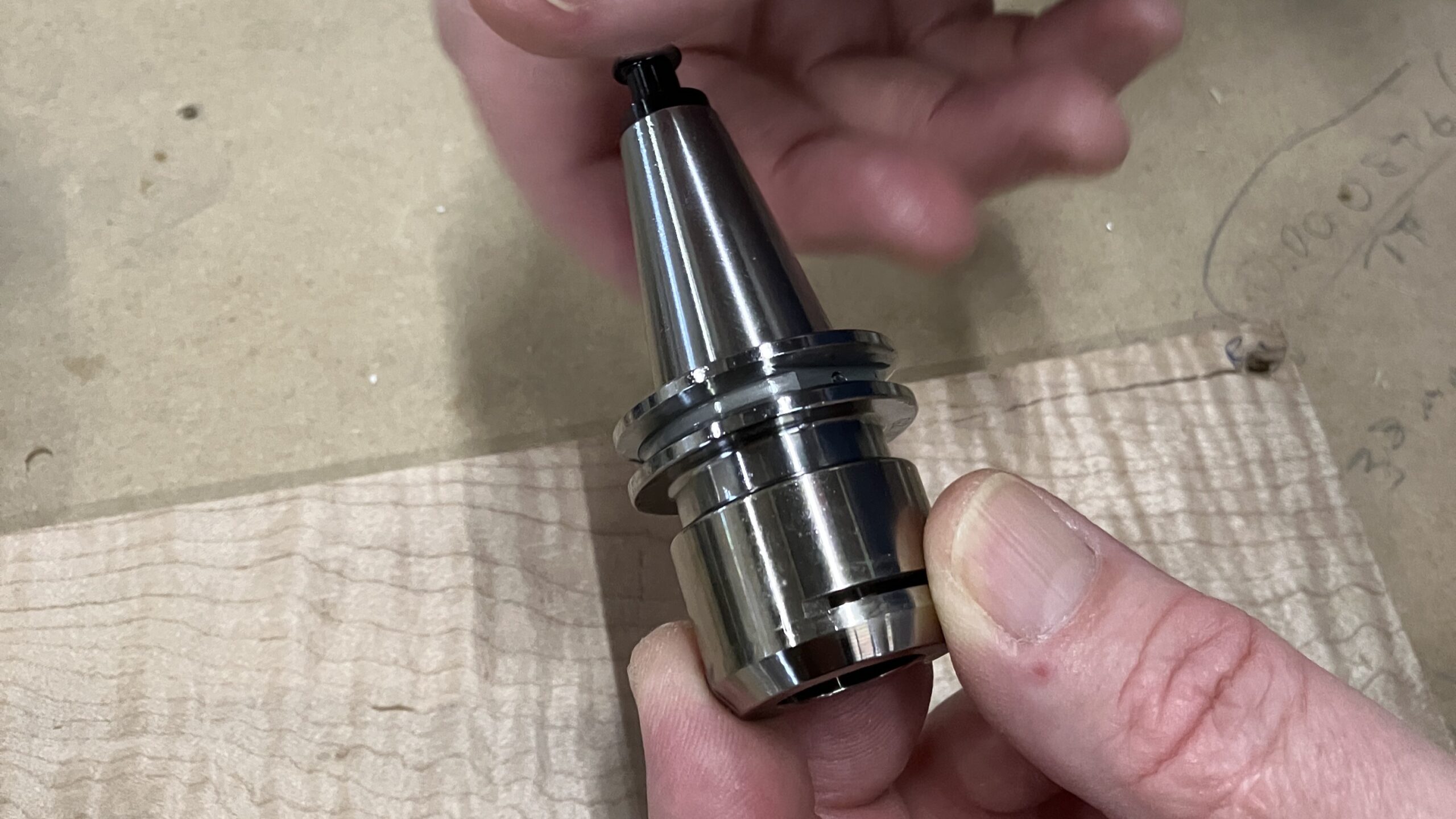

  1. Let’s get some tools loaded! Loosen the collet nut from each tool holder you are using. If secured tightly, use the set of wrenches that come with the ATC kit.
  2. Grab the bits that you plan to use for your first project. Insert them into ER20 collets. Your kit comes with ER20 collets that fit 1/8″, 1/4″, 3/8″, and 1/2″ tools.
  3. Seat the collet and bit into a collet nut, then secure them to a tool holder using the set of wrenches provided. Ensure the face of the collet is flush with the tool holder. Repeat for the remaining bits.
    Do not tighten collet nut without a tool

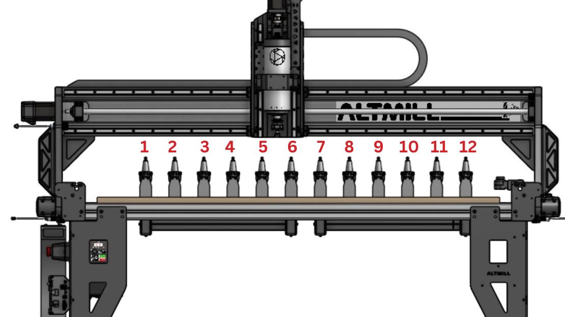

  4. Slide the assembled tools onto the rack, the bits should be facing down.
  5. To keep track of what tools you have on your rack, we suggest writing them down in a list, on a piece of paper. For example:
    Tool 1: 1/4" Flat End Mill
    Tool 2: 1/16" Compression Bit
    Tool 3: 22mm Surfacing Bit
    Tool 4: 1/8" Flat End Mill
    Tool 5: 30 Degree V-Bit
    Tool 6: 1/8" Tapered Ball Nose Bit
    ⚠️ Please note, Tool 1 is at left-most position on the rack, we count from left to right.

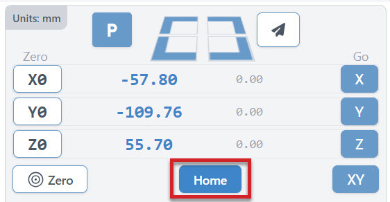

Run Homing Cycle
After connecting to gSender, home your AltMill – this is required to use your ATC.
If the limit switches are set up correctly and undamaged, you should be able to home successfully.

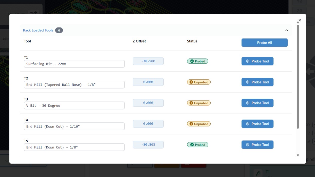

Set Up Tool Names

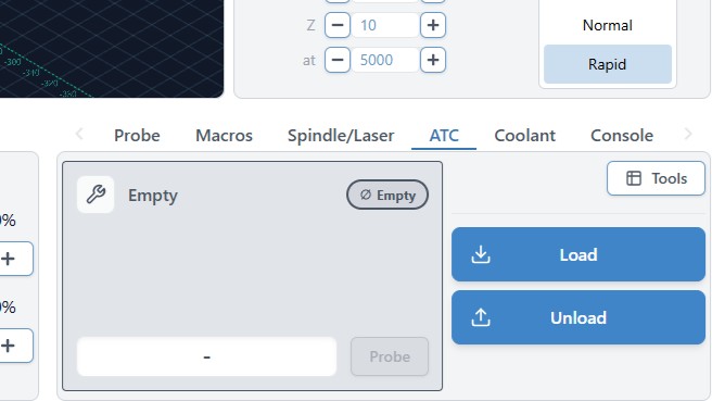

  1. You should see the ATC tab on the bottom right of gSender. Select the Tools button with the chart icon.
  2. Rename the tools to match what is on your rack, using the written list you have made. Renaming does not impact tool changing functionality. It is only there to remind you of what tools are on the rack.

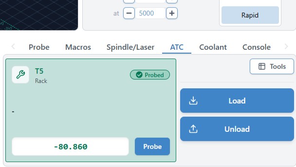

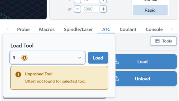

  1. Under the ATC tab, select Load.
  2. Using the dropdown, choose the tool number. In this example we want to load Tool 5 (T5) — the 5th tool on the rack, starting from the left. Press Load.
  3. The machine will move to Tool 5, grab it, then probe the bit using the TLS. You should now see T5 loaded on the ATC tab.
Congrats on your first successful tool change!

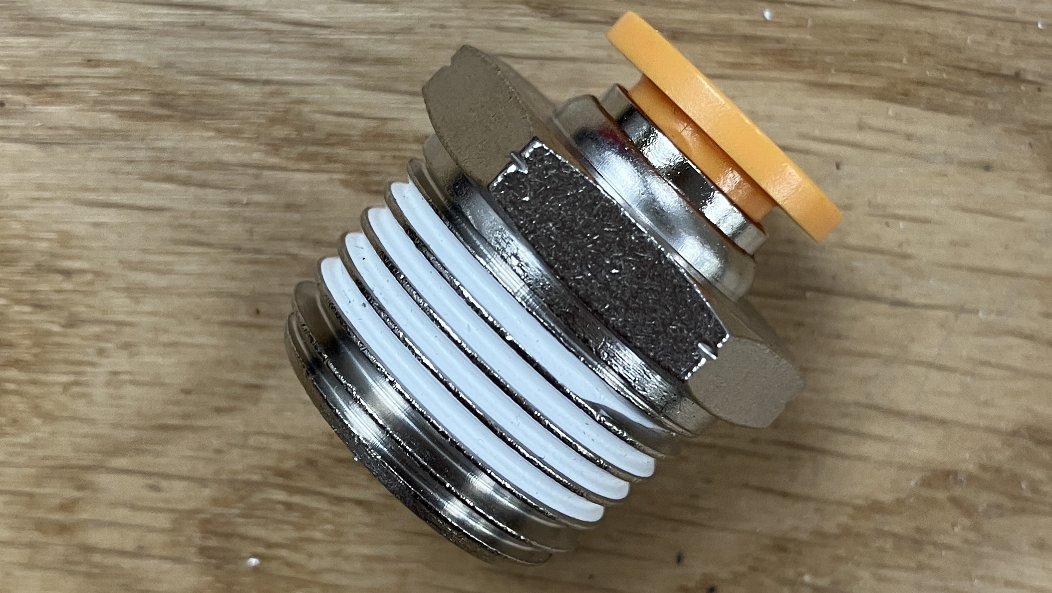

I have a leftover 1/2″ NPT straight fitting, why?
  • This fitting is included with all ATC kits as a courtesy. For those who have a third-party air filter regulator setup, you can use this instead of sourcing one yourself.
