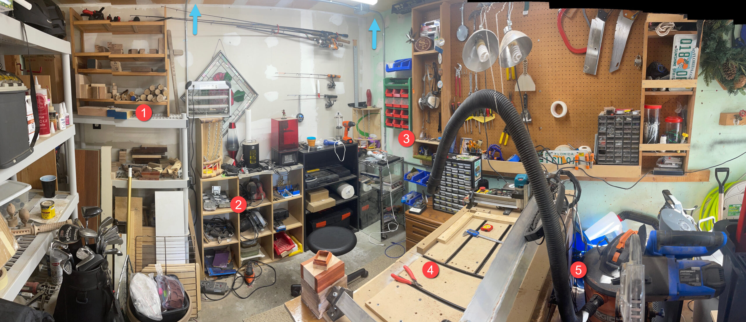

Let’s check out a full single car garage shop and explore some things to consider:
Note the two blue arrows indicating this shop has installed a separate power line on the ceiling
  1. Wood Storage
    You’ll need a space to store wood materials, whether it’s sheets of plywood, hardwoods, or other materials. It’s a good idea to designate a dry, organized area to prevent wood warping or damage and to ensure easy access during projects. Keep out spiders!
  2. Tools
    Over time, you’ll accumulate a variety of hand tools, sandpaper, clamps, and accessories. Make sure you have proper storage for these tools near your CNC machine to ensure quick access. Having access to a power bar is also very handy.
  3. Bits
    Having the original containers for bit or a small shelf or storage bin will help avoid misplacing or damaging small, delicate items like your cutting tools. The shop pictured above has carpet down to prevent any dropped bits from breaking too.
  4. Table
    Your CNC machine will need a sturdy, flat table or workbench to rest on. You may want to plan for extra space on the left side of your table to allow you to mount the controller or E-stop button. Note that the new AltMill includes a table!
  5. Dust Collection
    CNC projects generate a lot of dust, so a proper dust collection system is essential. This could be a small vacuum setup like pictured above, or a dedicated wall mounted dust collector to keep your workspace clean and prevent damage to your machine and electronics, like pictured below.
