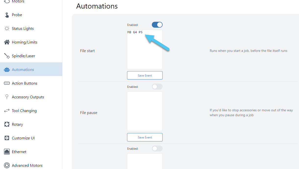

A powerful feature to control your accessories automatically (like turning on/off a spindle or vacuum) or to run movement macros that are custom to your machine. ‘Program Events’ (formerly “Start/Stop G-code”)’ in gSenders settings automatically apply g-code to your cutting job at the start, end, or if you stop, pause, or resume the job. The ‘Stop’ event is there to ensure that “ending g-code” is always run even if you have to stop a job prematurely. You can also toggle these on and off if you don’t want them run for specific jobs.
Three massive perks to setting up automations this way are:
  1. There’s no need to get into the weeds customizing your CAM post processor
  2. gSender is able to send code when you pause, resume, or emergency stop your machine, all of which a g-code file on its own would never be able to do
  3. This additional amount of control will make your CNC safer to use
For example, if you were to add M3/M5 commands to your CAM post processor to control your spindle but then chose to pause your job midway to check something, then most CNCs wouldn’t know to stop spinning your spindle or retract it since g-code files can’t carry this information; this is where gSender is able to the heavy lifting.
For the text-box of the situation you want the action to happen, type in the g-code commands you wish to run, then press the ‘Update‘ button to save it. For example, if you installed an IOT relay to turn your router and vacuum on and off and wanted to make sure they were enabled for every job you ran, you could add:
  • M8” for Start and Resume
  • M9” for Stop and Pause
  • If you wanted to add a delay to give your vacuum or router time to fully turn on, then you could add “G4 P5” after the M8 for a delay of 5 seconds (you can customize that delay to your equipment)
  • If you wanted to keep the vacuum and router running during a pause, then you don’t need to add “M9” to Pause
  • All this can also apply to automatically control a spindle, where you’d instead use “M3” and “M5“, you can also add a delay with “G4 P#
  • If you want to raise the Z-axis on Pause and lower it on Resume, you could also add:
    • “%global.move=modal.distance” then “G91 G0 Z-5” for Pause to move 5mm out of the way
    • “G91 G0 Z5” then “[global.move]” for Resume to move back down
