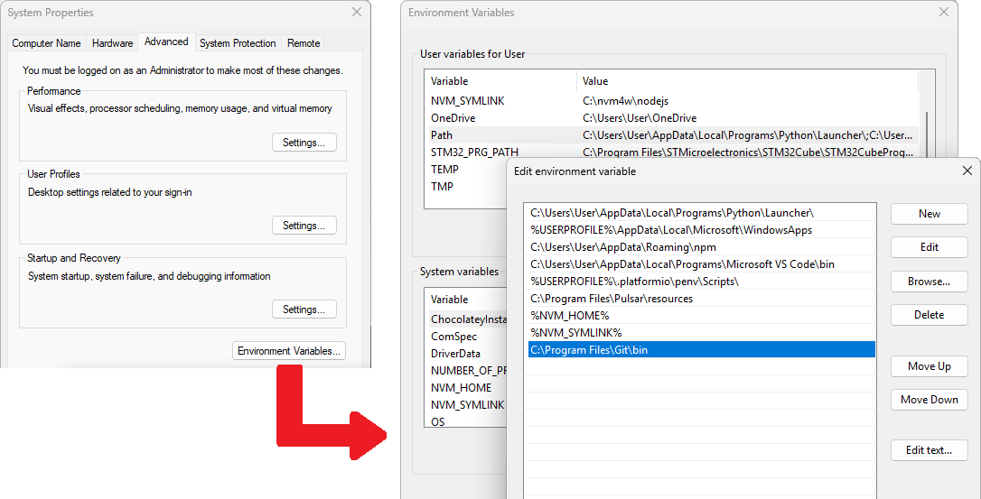

bash Command Not Found on Windows
  • Problem: When running yarn commands (e.g., yarn run dev, yarn clean, yarn prepare), you may see an error like 'bash' is not recognized as an internal or external command, operable program or batch file.
    This occurs because several package.json scripts invoke bash -c "...", which isn’t supported natively in Windows Command Prompt or PowerShell.
  • Solution:
    • Run from Git Bash (Recommended):
      The easiest and most reliable solution is to use the Git Bash terminal that comes with Git for Windows.
      Open Git Bash (search for it in your Start Menu) and execute all yarn and other gSender commands referenced in this documentation, from within that terminal. This ensures full compatibility with commands used in the build scripts
    • Add Git to System PATH (Advanced):
      If you prefer using PowerShell or Command Prompt, you can make bash available system-wide:
      1. Search for “Environment Variables” in the Start Menu and select Edit the system environment variables.
      2. Click Environment Variables… → under System variables, find and edit Path.
      3. Add a new entry:
        C:Program FilesGitbin
        (or your actual Git install path).
      4. Save your changes and restart your terminal.
        After this, bash should work in PowerShell or CMD.

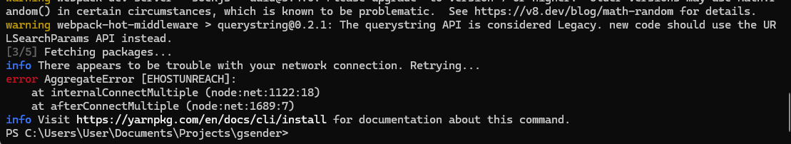

Node.js / Yarn Version Mismatches or Corrupted Installs
  • Problem: Errors during yarn install related to package resolution, node-gyp, or general build failures.
  • Solution:
    • Check Node.js Version: Ensure you are using Node.js 20.x as specified. Use node -v and nvm ls (if using nvm). If incorrect, switch using nvm use 20. Some community guides for Raspberry Pi may suggest Node.js 18.x, but the official CI uses 20.x.
    • Check Yarn Version: Ensure you are using yarn@1.22.22. Install globally with npm install --global yarn@1.22.22.
    • Clear Caches:
      yarn cache clean
      npm cache clean --force
    • Clean and Reinstall:
      rm -rf node_modules yarn.lock package-lock.json
      yarn install

Network Issues (Firewall/Proxy)
  • Problem: yarn install fails to download packages.
  • Solution: Check your firewall or proxy settings. Ensure npm and yarn are configured to use your proxy if applicable. npm and yarn needs access to the internet to download and install dependencies.
