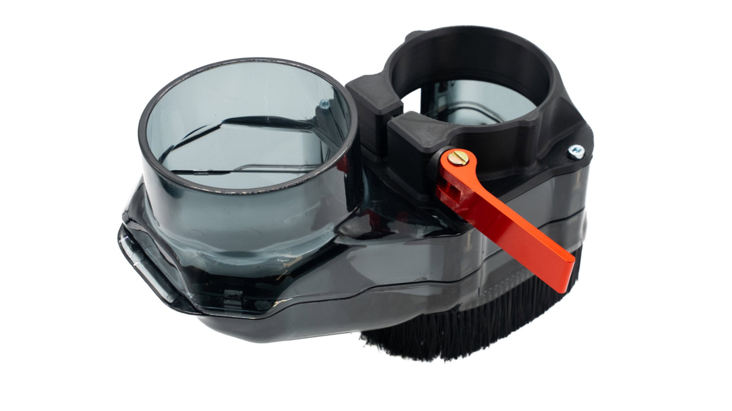

Clear Cut Dust Shoe
- Spindle diameter: Compatible with 80mm spindles
- Hose diameter: Compatible with 4″ standard hose
