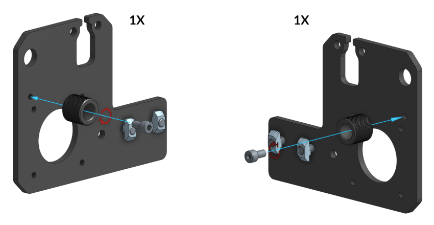

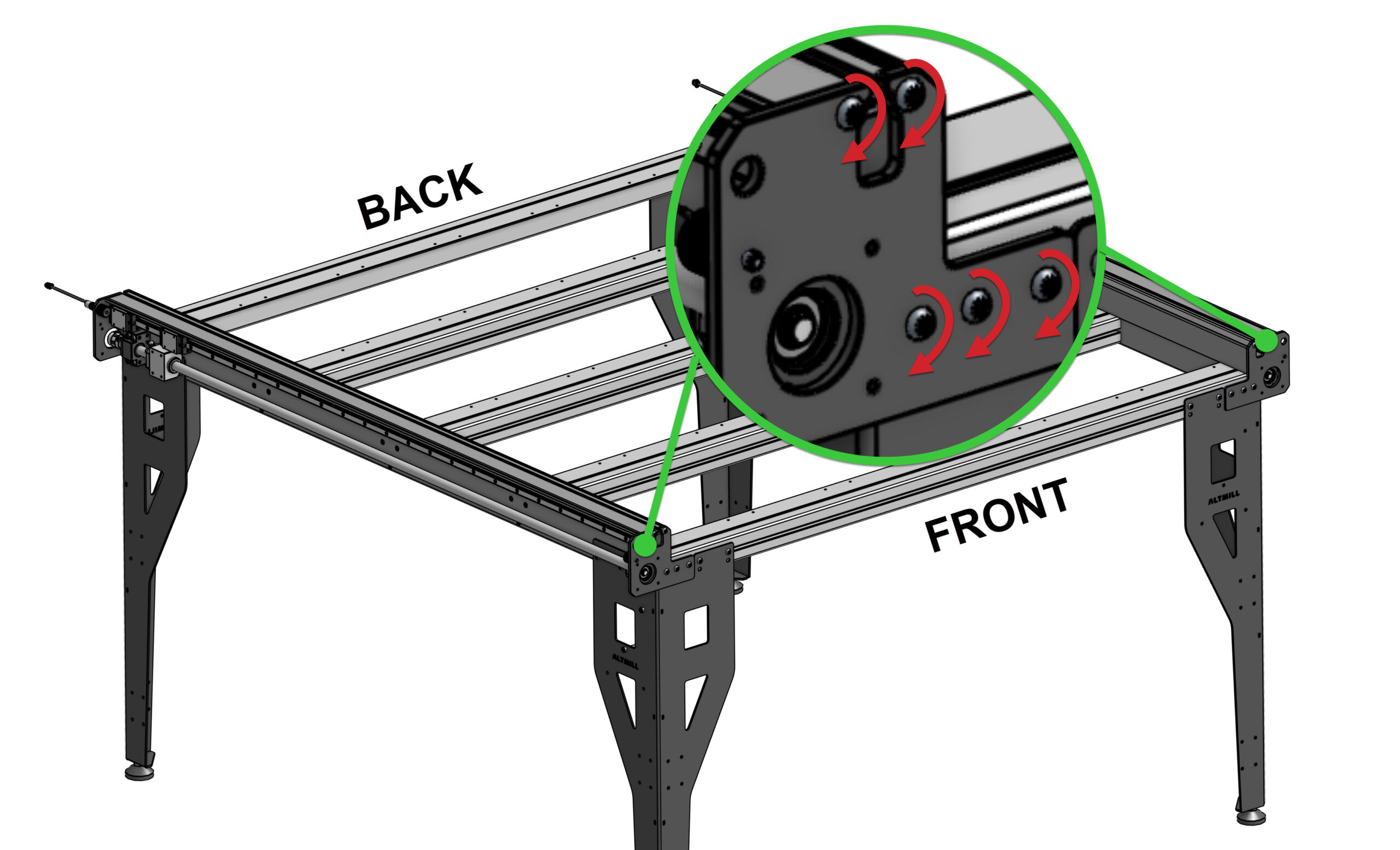

 End Plate Preparation
Thread two (2) M6-14mm button head screws into two (2) M6 twist-in T-nuts on each of the four (4) Y-axis end plates leaving the T-nuts loose. Note the orientation of the end plate when installing the T-nuts; match the face that will contact the crossbeam with the face the T-nuts are installed on.
Y-end plates, noting orientation of T-nuts
Integrated Sensor Bump Stops
Install two (2) integrated bump stops onto a pair of Y-axis end plates using two (2) M5-10mm socket head screws as shown.
Install all four (4) end plates onto the machine; the two end plates with bump stops should be at the front of the machine.

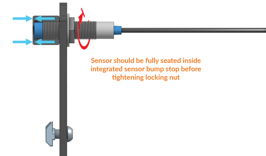

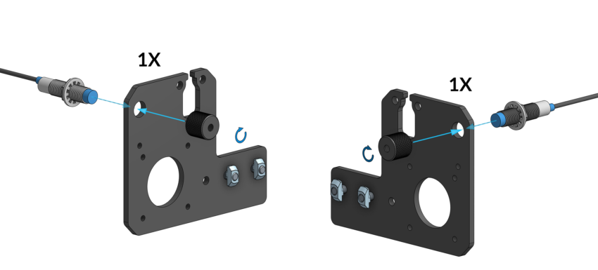

On two (2) inductive sensors, install a sensor nut, threading the nut roughly 20mm / 0.75 inches from the sensor end. Then insert a lock washer onto the sensor.
Inductive sensor preparation
Insert both sensors through the two (2) Y-axis end plates at the back of the machine. Ensuring the blue sensor tip is pointed towards the machine.
Install two (2) integrated sensor bump stops at the ends of the inductive sensors, to secure them onto the back end plates. Thread the bump stops over the end of the sensor until it bottoms out, only hand tightening these until snug. It is important that this bump stop is fully seated onto the ends.
Then, tighten the rear sensor nut with lock washer on the back of the sensor, to clamp it on the end plate.

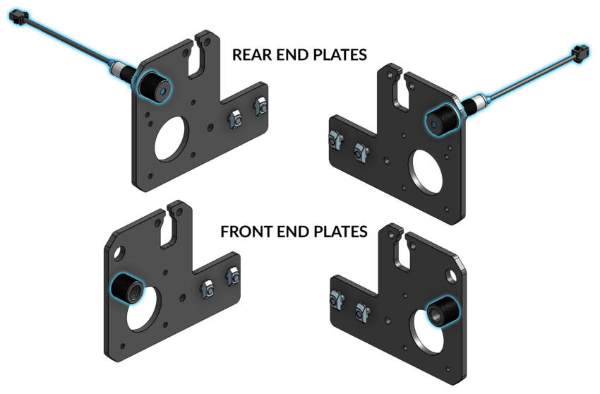

Once assembled, your end plates should look like the following image:
Assembled end plates
The end plates should be mounted on each corner of the machine, as shown below.
Y-end plate positions on AltMill
