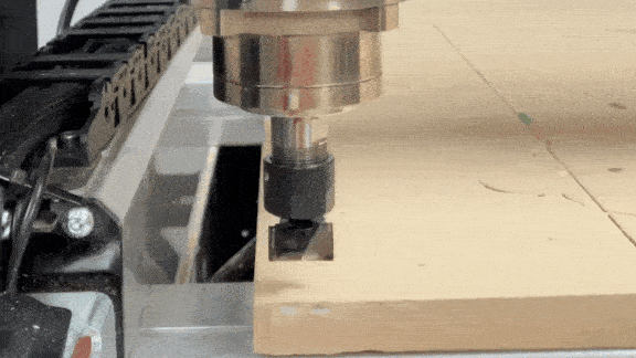

When surfacing, you will want a cutting tool specific to this process, called a surfacing bit. These are made for light passes but are usually larger in diameter, so they can cover a large area quickly while leaving a good surface finish. Larger bits can also reach further outside the cutting area of the machine. We typically use the 22mm surfacing bit we sell on our store.

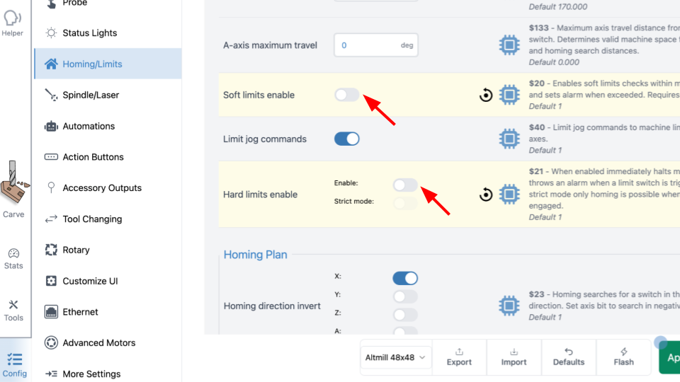

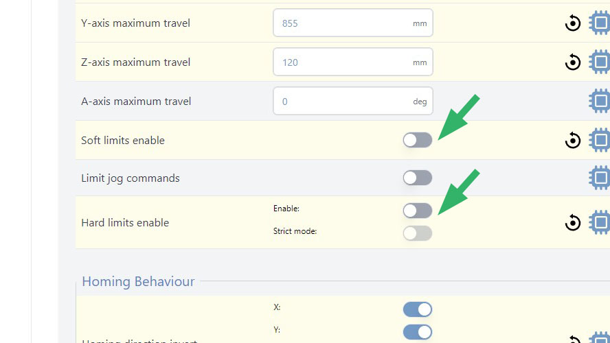

2. Open the Config tool, and under Homing/Limits, disable the hard and soft limits. You will get an Alarm 2 if soft limits are enabled and you won’t be able to surface you spoil board.

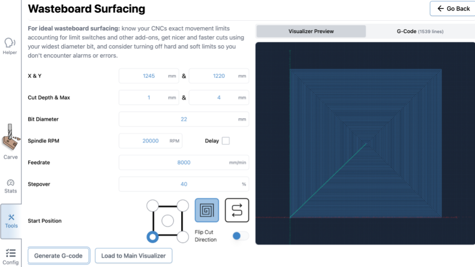

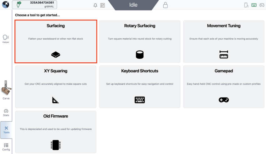

4. Navigate to Tools, then to Surfacing.
5. You will find the surfacing settings, please adjust them according to your needs.
X & Y: This is the max dimensions you wish to surface. These sizes will be determined by the size of your bit, and should only be used as a starting guide. If using a large surfacing bit, you may need to decrease the dimensions.
  • For 4×4 — 1245mm (49″) & 1220mm (48″)
  • For 2×4 — 1245mm (49″) & 650mm (25.6″)
Cut Depth: Keep this at 0.04in (1mm) or less, cutting any deeper with a large bit can result in an uneven surface
Max: this is the total depth of cut into your wasteboard. This is normally set to 0.04in (1mm). Greater depth is necessary if your board is very warped or has deep imperfections. If the Max and Cut Depth are set to the same value, the machine will perform only one surfacing pass.
Stepover: about 40% overlap, close passes (larger step over) will result in a longer cutting time and a smoother finish, whereas far passes may result in a rougher finish
Spindle RPM: A speed setting of around 20,000 RPM works well for MDF and other woods.
Feedrate: Setting your feed rate to 8000 mm/min should be suitable for the AltMill cutting MDF, however running this slower may produce a slightly nicer finish.
Start Position: We recommend to keep this at the bottom left corner of the square, which is the default setting. This means that the cutting will start at the bottom left corner of your wasteboard.

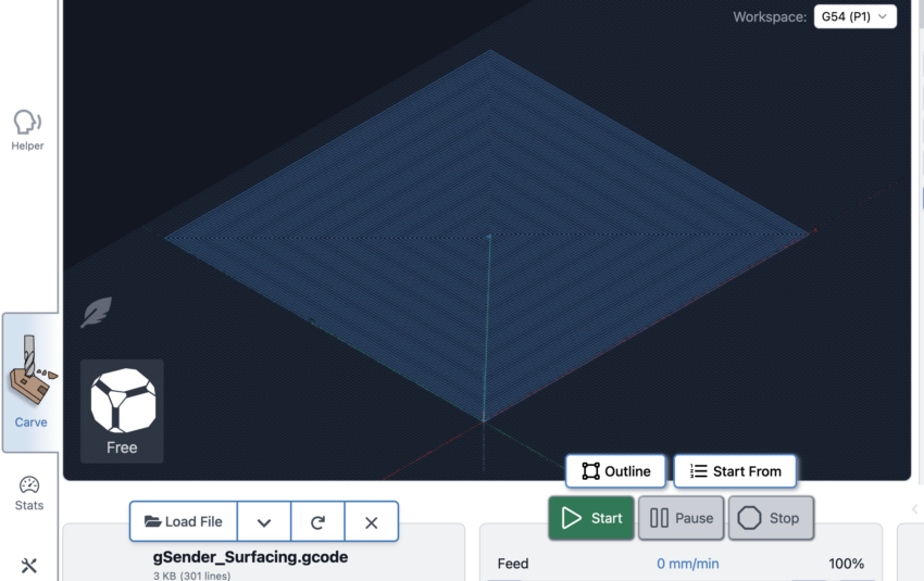

6. Once you adjusted the settings, you can click ‘Generate G-code’ to view the toolpath using the Visualizer Preview on the right side of the window.
7. Click ‘Run on Main Visualizer’ to load the file onto gSender.

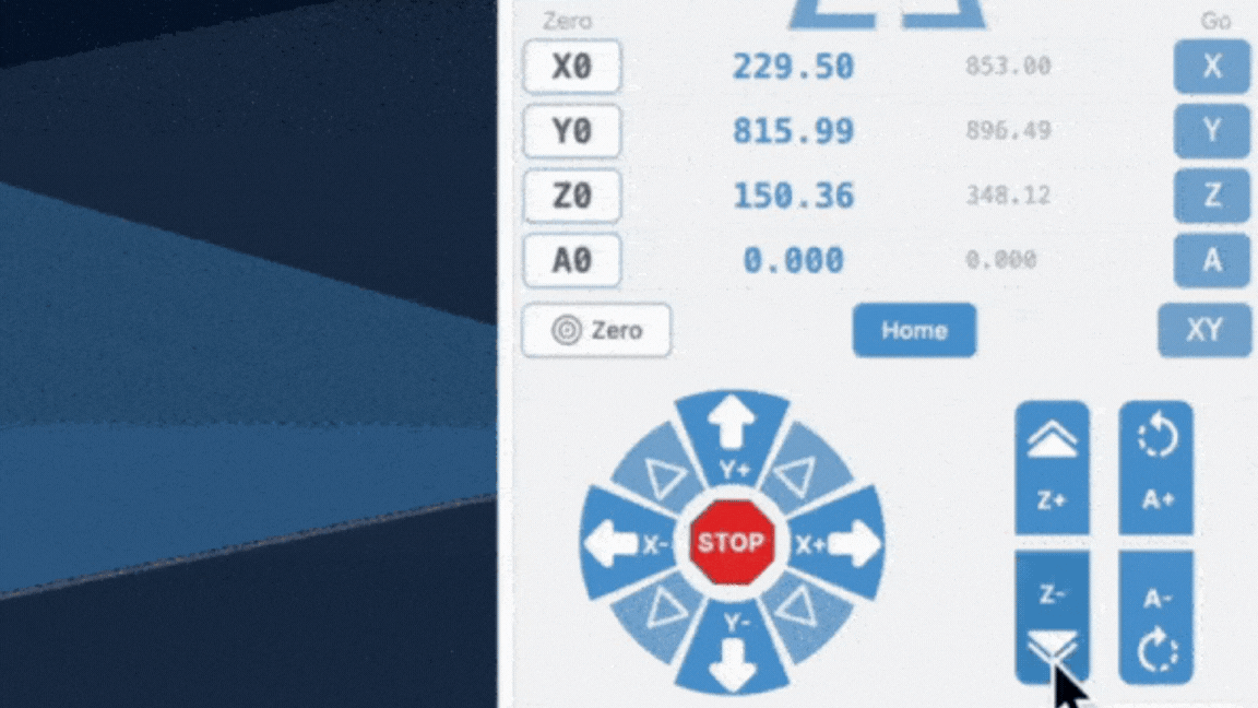

9. Zero your machine at the Start Position you indicated (by default it is the bottom left corner of the wasteboard). Otherwise your machine does not know where to begin cutting.
i. Jog the machine to the corner of the MDF wasteboard
ii. With the surfacing bit installed, jog the machine down in the Z direction, until the bit touches the MDF
iii. Press Zero OR press X0, Y0 and Z0 individually

12. Enable the Soft and Hard Limits

If you run into alarms related to soft or hard limits, first make sure you have homed your machine. Then try to run the surfacing job again.
If you still are seeing alarms please see this troubleshooting page.
