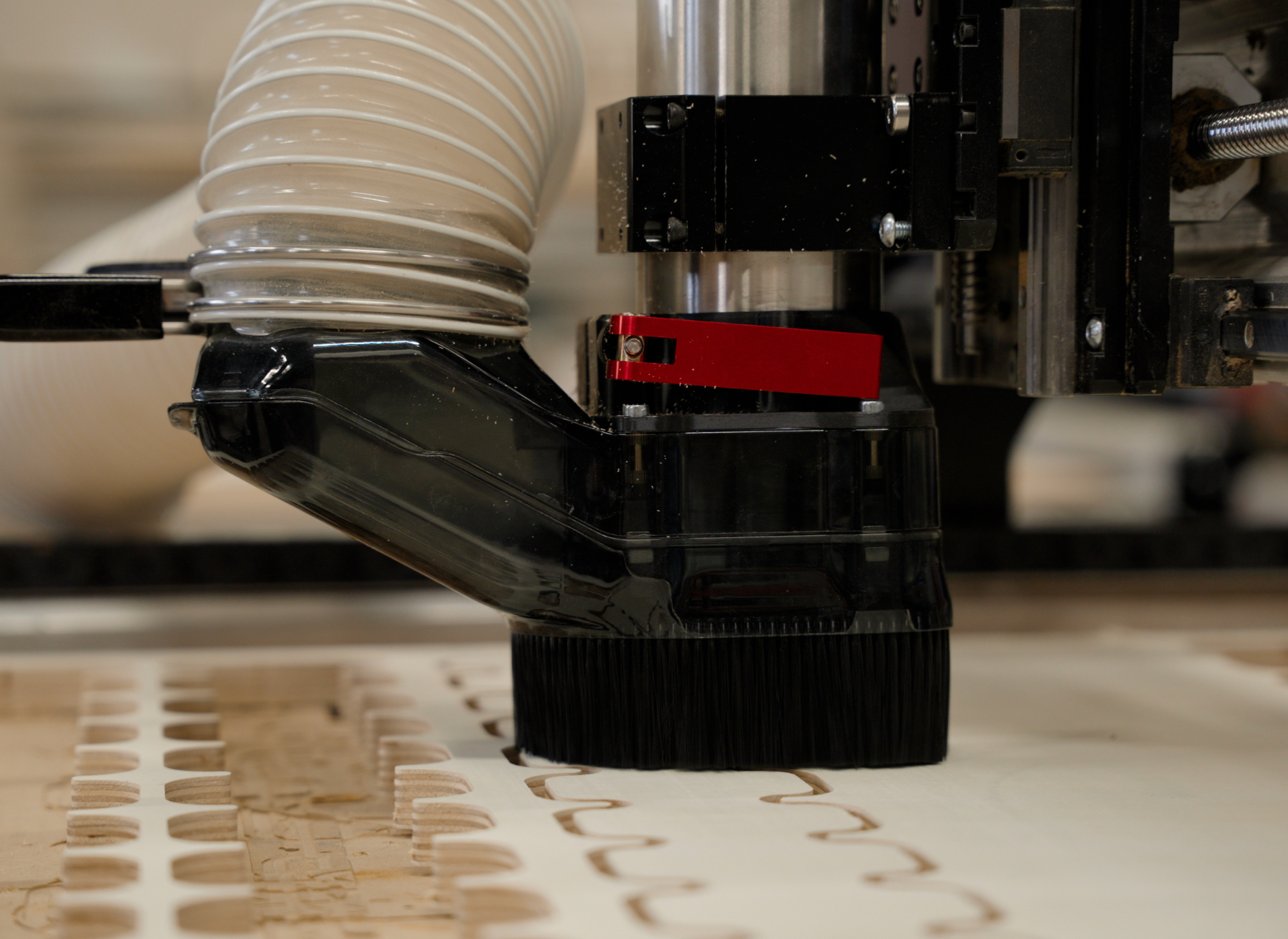

Also known as the vacuum attachment, the dust shoe is connected to a hose leading to the dust collector, sucking up debris on the work surface. If you are choosing a different dust shoe for the machine, here are some factors to consider:
- Spindle size
- Hose size/suction power
- Z-axis adjustability of the dust shoe
AltMill Clear Cut Dust Shoe
