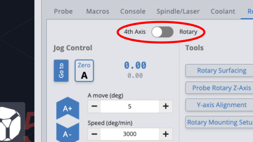

At this time you can power back up and enable ‘Rotary mode’ within gSender by selecting the ‘Rotary’ tab in the bottom right corner of the screen, then toggling the ‘Rotary Mode’ option found here.
You’ll be prompted to ensure your output switchover has been completed before proceeding.

4th Axis Mode
4th Axis Mode - CLOSED LOOP VORTEX ONLY
Make sure you have energized the A-axis. If you have a LongMill with a spindle, energize the Z-axis as well. To check, go to your Firmware settings and search for $37. If the axes are not yet enabled, toggle them and then press Apply Settings. Turn OFF then ON your controller to have the settings take effect.
$37, Z and A-axis enabled
Reconnect to gSender and toggle into 4th Axis Mode. Stay in 4th Axis Mode at all times, do NOT switch to Rotary Mode.
