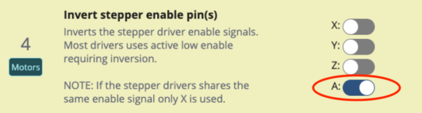

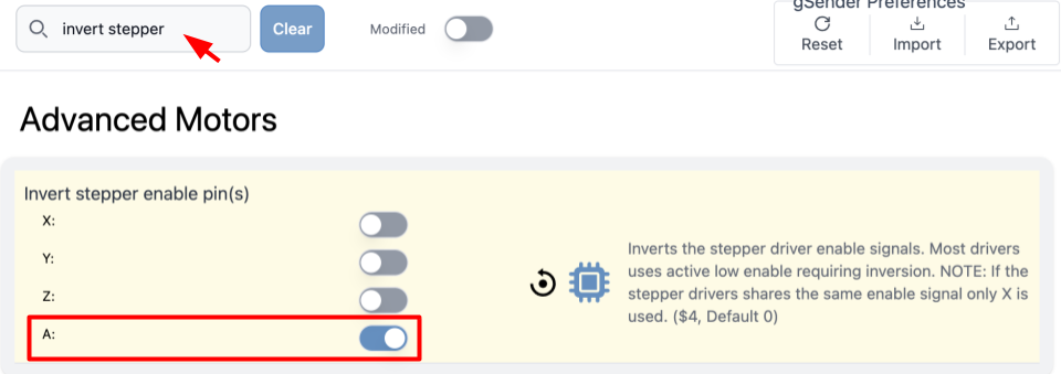

$4 Invert stepper enable pins toggle A to be ON (do not adjust X, Y, Z settings)

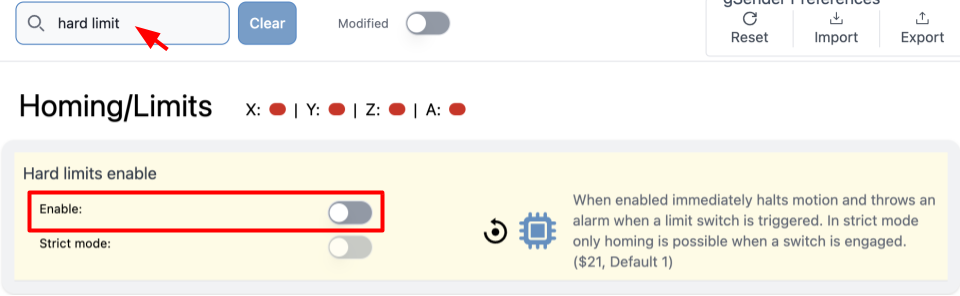

$21 Hard limits enable toggle Enable to be OFF

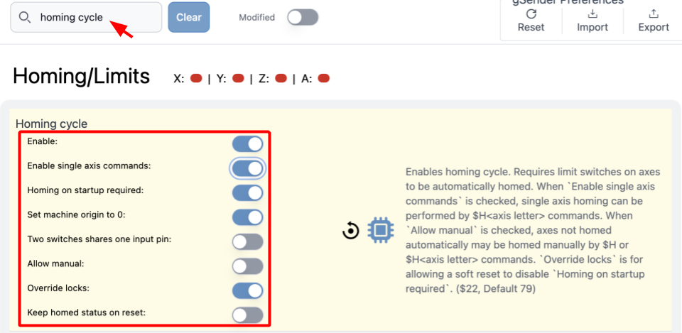

$22 Homing cycle → match the toggles as shown

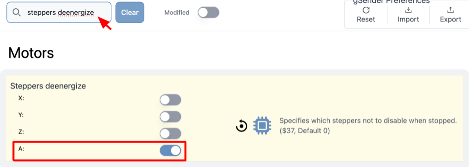

$37 Steppers deenergize → toggle A to be ON

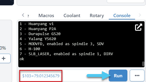

At the bottom right of the screen, select Console.
Type in $103 = 79.012345679 then press Run
Power OFF then ON the control board so that all the changes will take effect.

$4 – A toggle is ON, DO NOT TOUCH XYZ
$21 – Enable is OFF
$22 – Enable ON, Enable single axis commands ON, Homing on startup required ON, Set machine origin to 0 ON, Override locks ON .
Ensure you enable the following setting. The closed-loop stepper motors need to be power to the motors before receiving a move command. If you are experiencing a delay when jogging the A-Axis, it’s likely A hasn’t been toggled on.
$37 – A toggle is ON.
LongMill customers with spindles are recommended to enable the Z axis for 37 Steppers deenergize. When using the spindle kit with the vortex the following settings are:
$37 – A & Z toggle is ON.
One the settings are saved, go to the Console on the main gSender window. Type in $103 = 79.012345679 then press “Run”
Manually enter setting $103 on the Console tab
