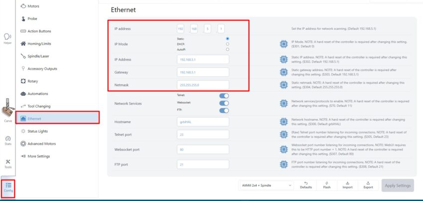

Connect your SLB to the gControl Panel using an Ethernet cable
First, connect the USB/USB-C cable from your gControl to the SLB and on gSender connect to the machine as shown below:
Go to Firmware and scroll down to find the 302, 303 and 304 options. By default, they should have these values:
302 (IP Address): 192.168.5.1
303 (Gateway): 192.168.5.1
304 (Netmask): 255.255.255.0
For the new gSender version:
After confirming, unplug the USB and connect the Ethernet cable from your gControl to the board. You should see a green light on and a yellow light blinking at the SLB port.
Now, on your gControl computer, find the Network Connections. If you write “network” in your search bar, a “View network connections” will appear; click on it.
In Network Connections, right-click on “Ethernet 2” and click on Properties.
Double-click on Internet Protocol Version 4 (TCP/IPv4)
Select the option “Use the following IP address:” and fill in the fields IP address and Subnet mask as shown.
** You can assign any IPs from 192.168.5.2 to 192.168.5.254. I chose 192.168.5.5 for this tutorial.
Make sure this information matches and you enter the correct subnet mask. Click OK after that.
Probably after this configuration, your Ethernet 2 should be showing it:
In gSender’s general settings, ensure the IP range matches the EEPROM IP.
With grblHAL firmware selected, choose Network Devices and confirm it connects successfully.

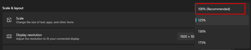

How to Change the Display Scale on gControl

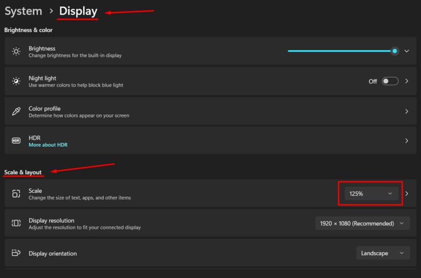

By default, the display scale is set to 125%. You can adjust it to fit your needs using these steps:

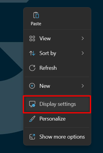

Step 1: Tap and hold (or right-click if you are using a mouse) on the desktop, and then select Display settings from the menu.
Step 2: In the Settings window, under System > Display, scroll down to the Scale & layout section.
Step 3: Click the drop-down menu and choose the scale percentage that works best for you. Common options include 100%, 125%, 150%, etc.
Step 4: Once selected, Windows will automatically apply the new scale. Some changes may take a few seconds.

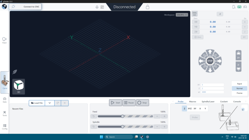

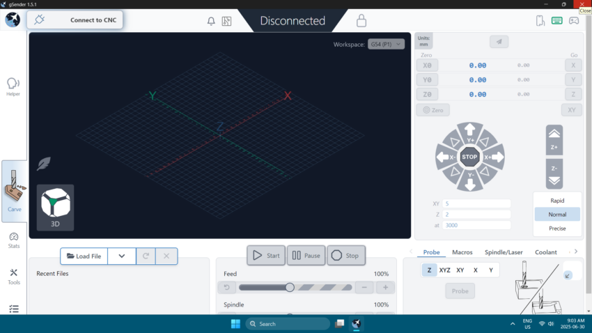

For the new gSender 1.5.1, using 100% scale gives the best layout and fit for the full interface.
gSender-1.5.1 with 125% Scale:
gSender-1.5.1 with 100% Scale:

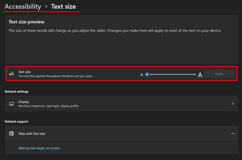

However, if 100% feels too small, you can keep the scale at 100% and only increase the text size.
To change just the text size:
In the Display settings page, scroll down and tap Text size (or go to Accessibility > Text size).
Use the slider to adjust the text size to your preference..
Tap Apply.

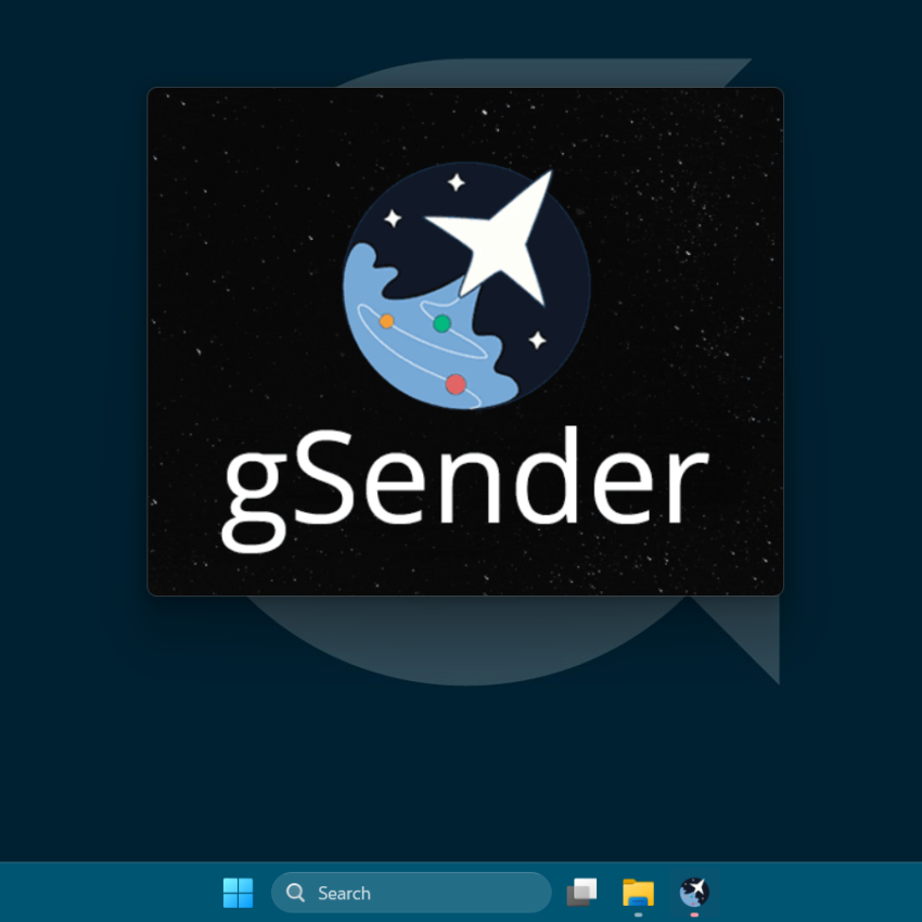

How to Fix gSender Getting Stuck While Loading
If gSender gets stuck on the loading screen and won’t open on your gControl, try uninstalling the current version and follow the steps below before installing another version.
You can also try the steps without uninstalling, but I recommend removing the app first for better results.

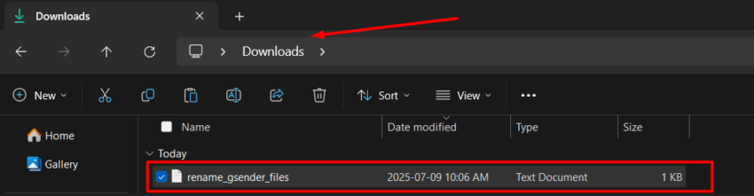

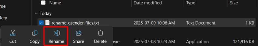

Step 1: Download the rename_gsender_files.txt

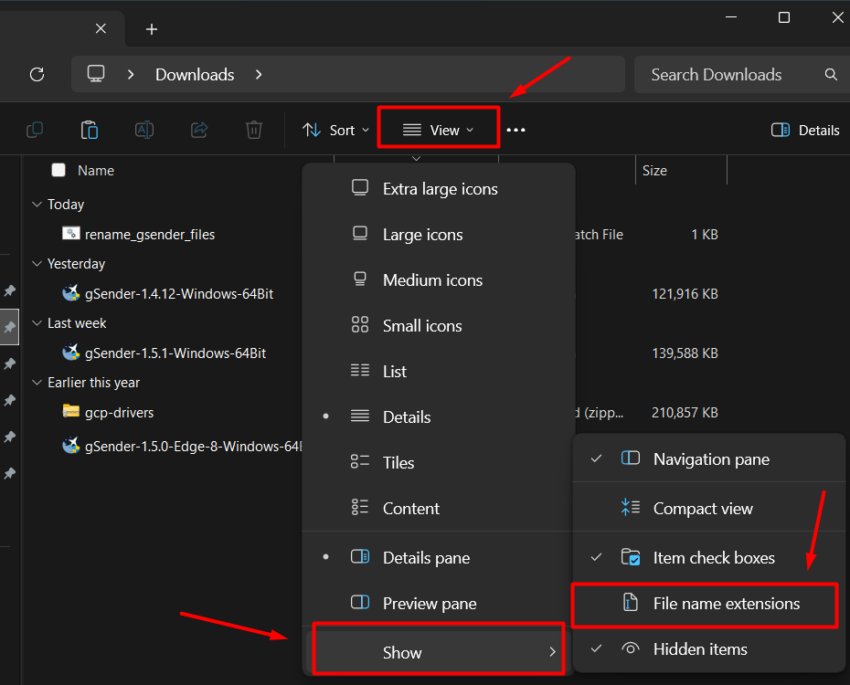

Step 2: After downloading the file, go to the Downloads folder:

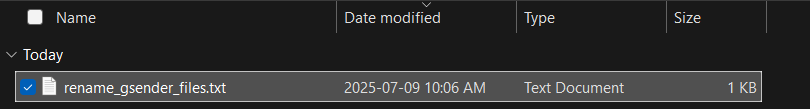

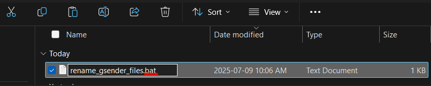

By default, Windows hides file name extensions. To show them, go to View > Show > File name extensions and make sure it’s selected.

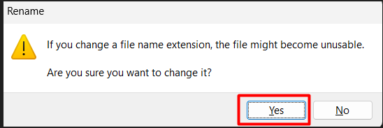

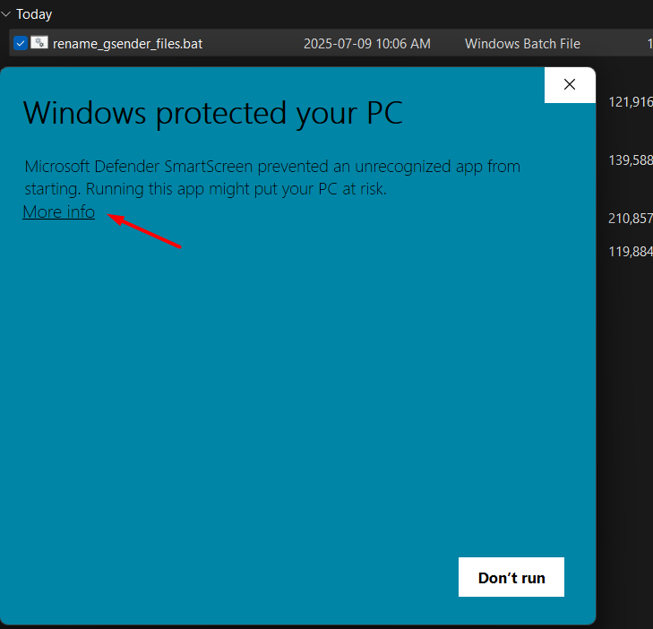

Step 3: Tap and hold the file (or right-click if you’re using a mouse), then click “Rename”. Change the file name from rename_gsender_files.txt to rename_gsender_files.bat.

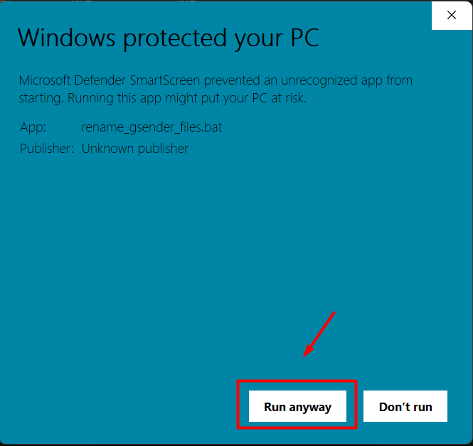

Click Yes:
Click More info:
Click “Run anyway”:

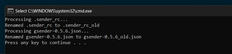

The Command Prompt window will show the results. Press any key to close it.

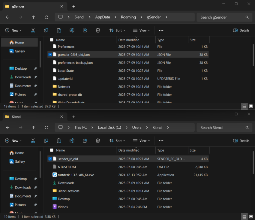

The .bat file you just ran will rename the files gsender-0.5.6.json and .sender_rc. This removes gSender’s reference to them, so the next time you open the app, it will automatically create new files.
If you prefer, you can deselect the option to show file extensions.
Step 4: After completing this process, try opening gSender if you kept it installed, or reinstall it if you had uninstalled it earlier.
gSender should now open without any errors.

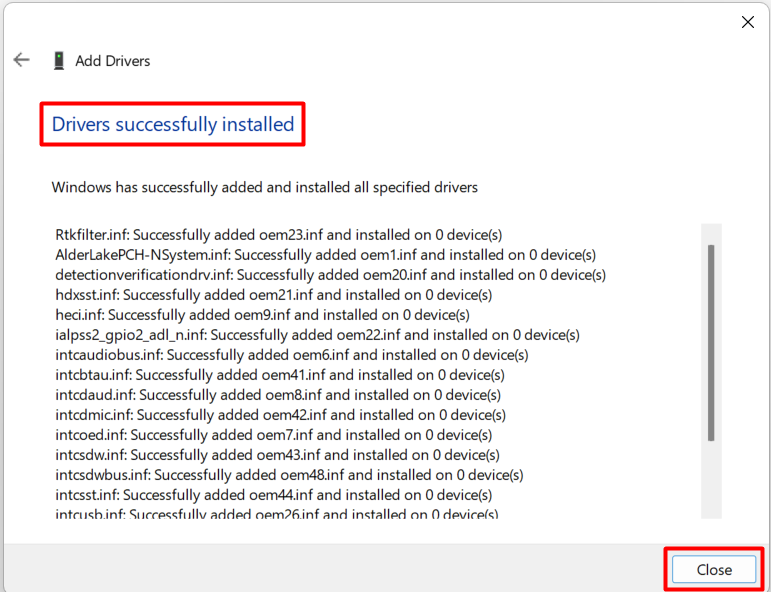

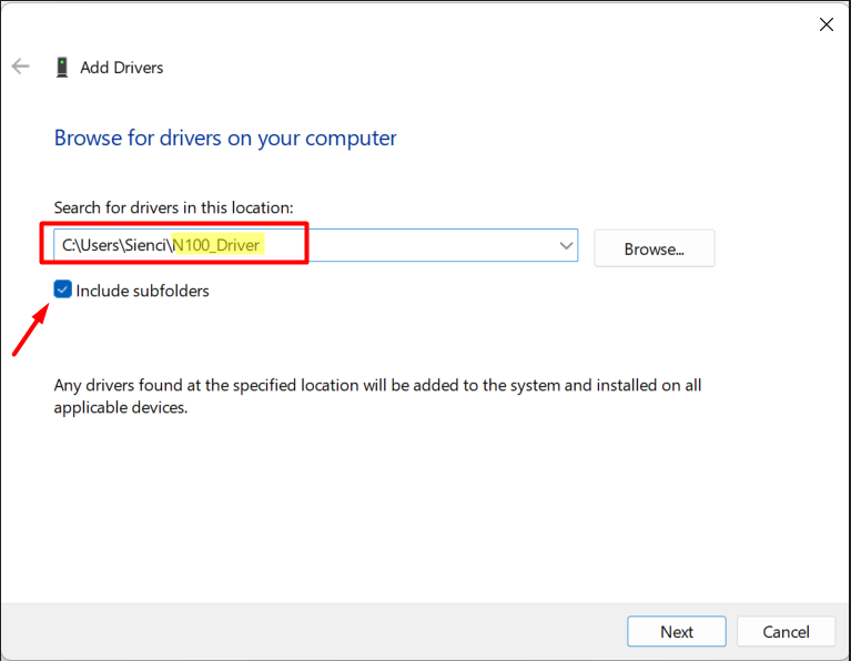

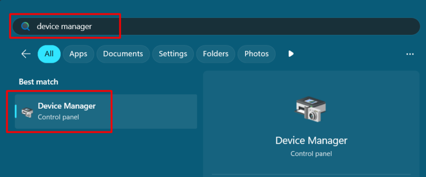

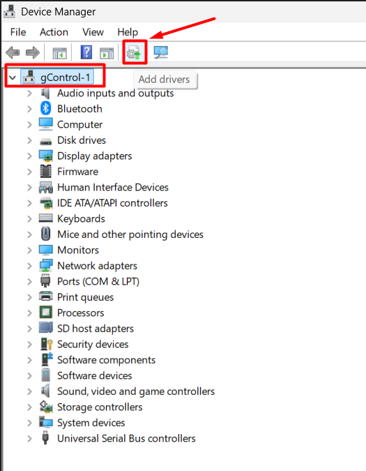

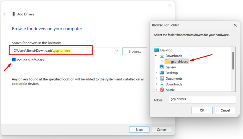

Adding Drivers to Your gControl
If any drivers are missing or need to be reinstalled and Windows doesn’t find them automatically, you can download the gcp-drivers folder. Leave the ZIP file in your Downloads folder, then right-click it and select “Extract All…”.
Next, open Device Manager by typing it in the search bar and selecting it. Click on your device name (for example, gControl-1), and then click the “Add drivers” icon.
If you see the path C:\Users\Sienci\N100_Driver in the search bar, simply click Next, and Windows will automatically install the drivers. If the path doesn’t appear, click Browse, locate the extracted gcp-drivers folder in your Downloads, select it, and click Next.
Or
Windows will then automatically install all the necessary drivers.

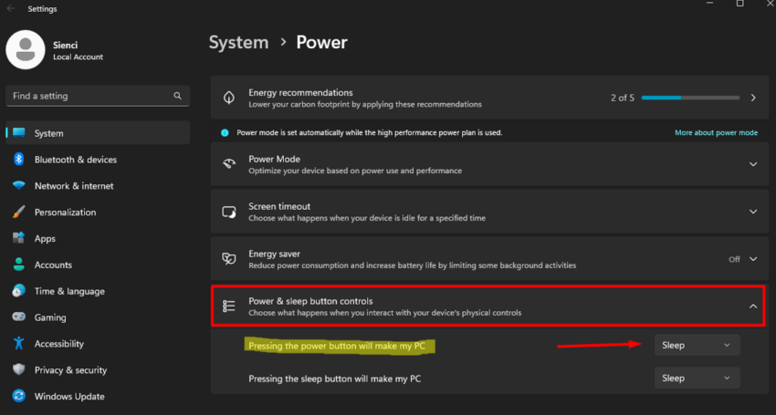

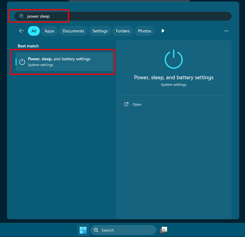

How to Set the Power Button to Turn Off the gControl Screen

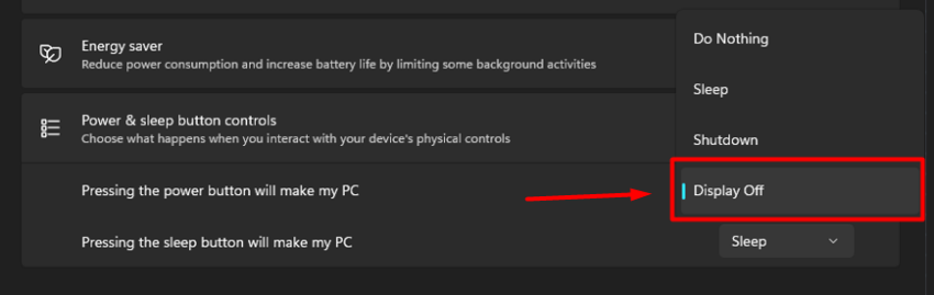

Step 1: Click the Search bar and type “power sleep”. In the results, you’ll see Power, sleep, and battery settings. Click it to open.

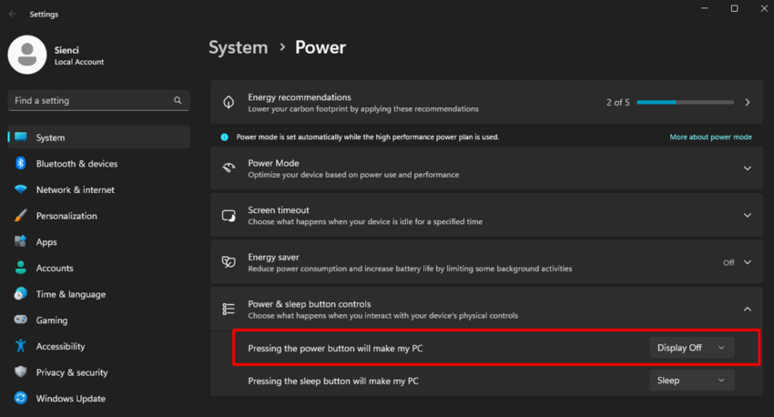

Step 2: Scroll down and expand Power & sleep button controls.
Find the option “Pressing the power button will make my PC” and change it from Sleep to Display off.
Step 3: After setting it to Display off, close the Settings window. Press the silver power button to test. The gControl screen will turn off while the system keeps running.
