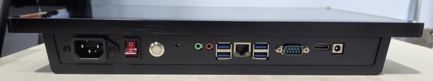

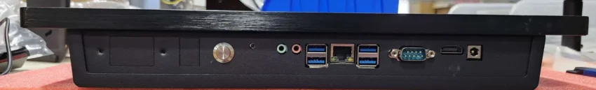

Inputs and Outputs
** Starting October 9, 2025, all gControl units use an external AC/DC power adapter instead of an internal power supply.
