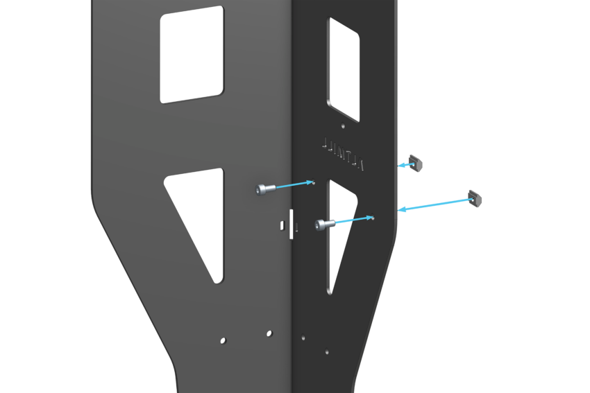

Insert two (2) M5-10mm socket head screws into the two (2) holes under the “ALTMILL” cutout in the side of the left leg. Thread M5 T-nuts onto the screws, leaving the T-nuts loose.
Slide the SLB-EXT enclosure onto the T-nuts. The T-nuts fit into the T-slot from the left side of the SLB-EXT enclosure. Orient the enclosure such that the Sienci Labs logo is on the bottom left corner when looking at the acrylic face plate.
Tighten the M5-10mm screws, clamping the enclosure to the table leg.
Note: If you thread the M5 T-nut too far onto the M5-10mm screw you will have a difficult time sliding the T-nut into the T-slot of the enclosure.

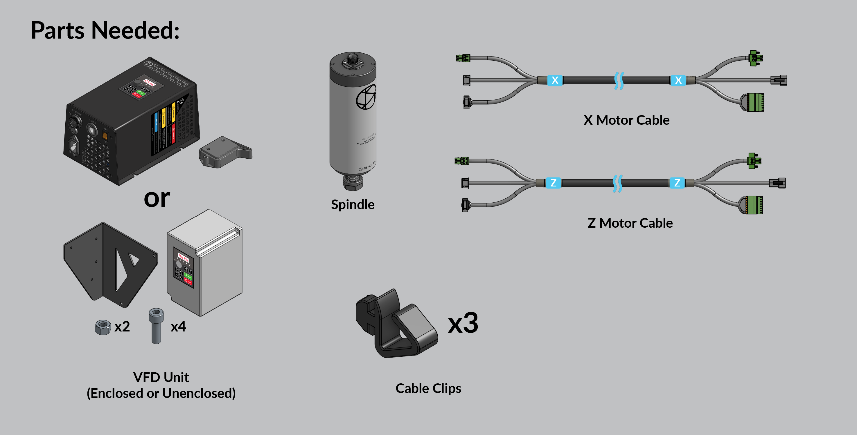

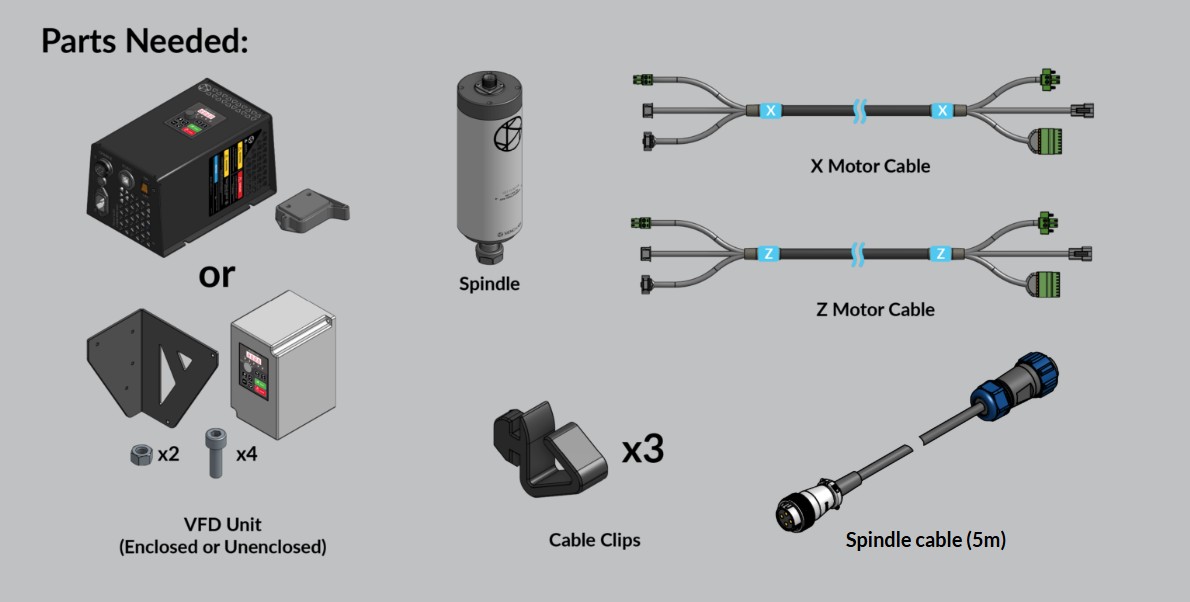

If you purchased the Sienci Labs Spindle Kit, please use either the Enclosed VFD (no VFD mounting bracket) or Unenclosed VFD (with VFD mounting bracket) instructions.
If you are using a third party spindle / router, follow the instructions for your specific spindle and come back to this assembly manual when you have mounted your spindle and are prepared to route the wires through the drag chains.   A 5m length towline rated cable is recommended for 2×4 and 4×4 AltMill models.

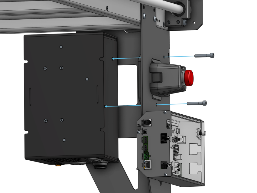

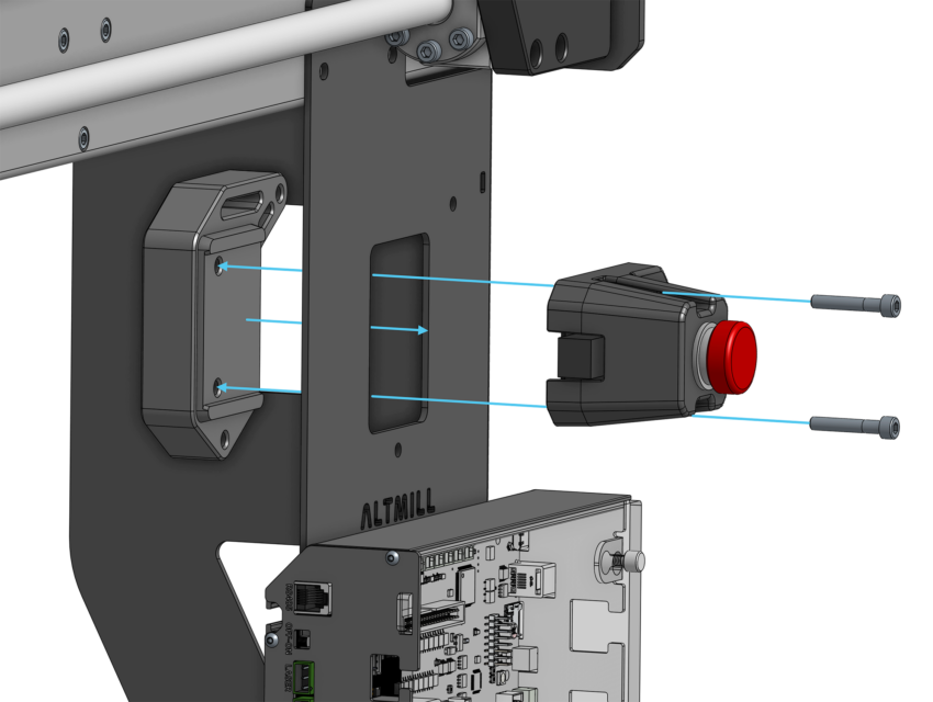

Use the plastic VFD mounting spacer to mount the E-stop module using two M5-30mm screws and two M5 nuts included with the spindle kit.
Mount the VFD unit inside the table leg using the remaining two M5-30mm screws included with the spindle kit. The VFD unit’s front screen should line up with the cutout in the front of the table leg.

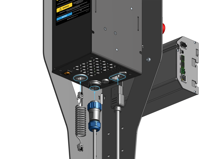

Plug in the included spindle control cable, AC power cable, and spindle cable into the bottom of the VFD unit. Plug in the AC power cable to your wall outlet or extension cable.

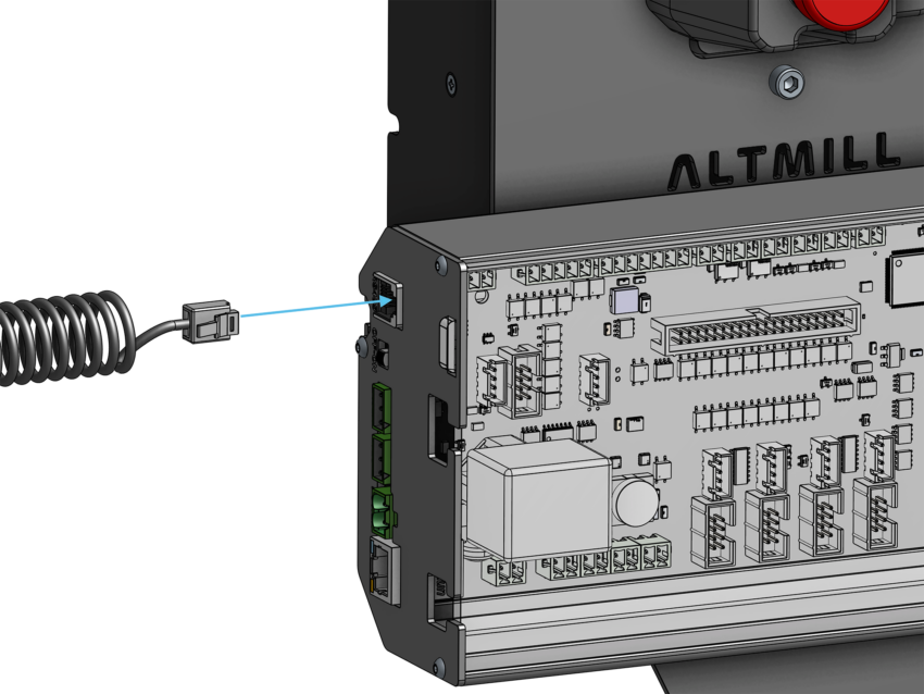

Plug in the other end of the spindle control cable to the ‘RS485’ connector on the rear of the SLB-EXT controller.

Fasten the VFD to the VFD mounting bracket using two (2) M5-16mm socket head screws and M5 nylock nuts. The VFD is fastened to the long flange of the mounting bracket.

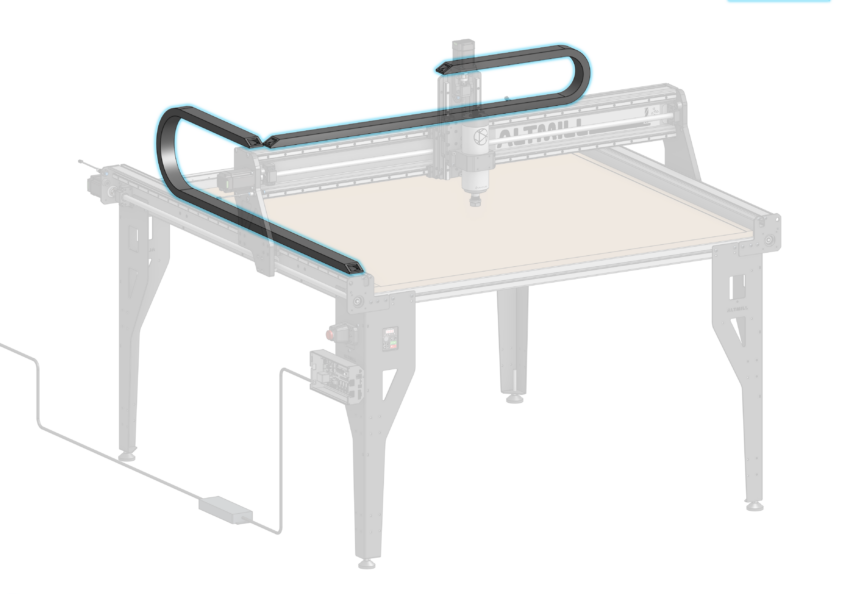

Place the drag chain on the X rail. Fit the spindle cable and the Z-axis wire harness into the open drag chain. Press the clips down to secure the cables. To save on time, it is recommended to remove half the clips from the chain, in the case that you need to open the drag chain again.
Note: Check the drag chain ends to ensure they will interface correctly with the drag chain. Remember one link has a knobbed flange and the other a holed flange.
Note: Ensure the Z-axis wire harness is oriented such that the motor side connectors are exiting the drag chain opposite the X-axis motor.
Routing through X-axis drag chain
Install the drag chain onto the drag chain end links.
X-axis drag chain secured on drag chain end link
Place the drag chain on the left side Y-axis rail. Fit the X-axis wire harness, Z-axis wire harness, and spindle cable into the open drag chain. Press the clips down to secure the cables. To save on time, it is recommended to remove half the clips from the chain, in the case that you need to open the drag chain again.
Note: Ensure the X-axis wire harness is oriented such that the motor side connectors are exiting the drag chain at the X-axis motor, not the opposite.
Routing through the left Y-axis drag chain
Install the drag chain onto the end links.
Securing left Y-axis drag chain on drag chain end links
