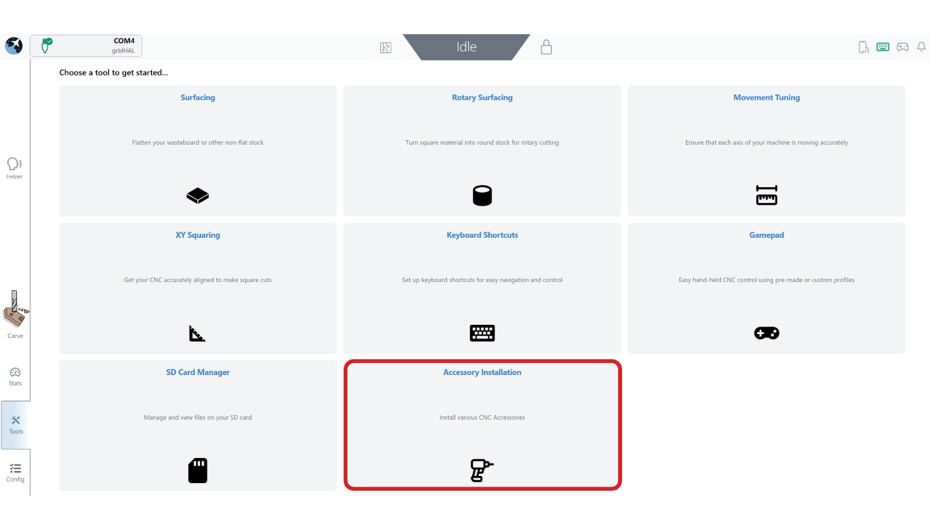

1. Go to Tools, then select Accessory Installation

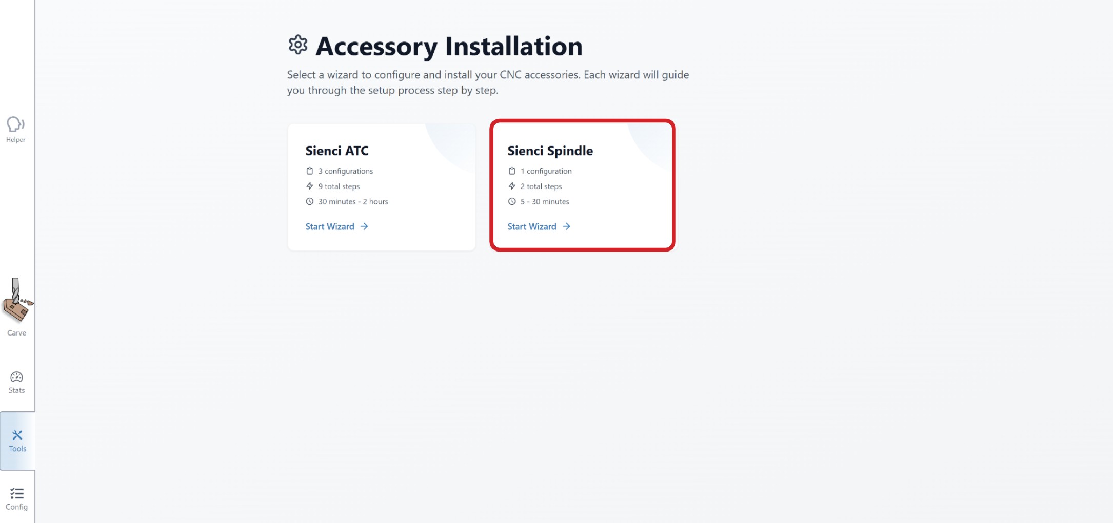

2. Select Sienci Spindle. Then follow the instructions in the installation wizard to finish setting up your spindle.
3. Once you complete all the steps in the installation wizard, go back to the main page, Carve.

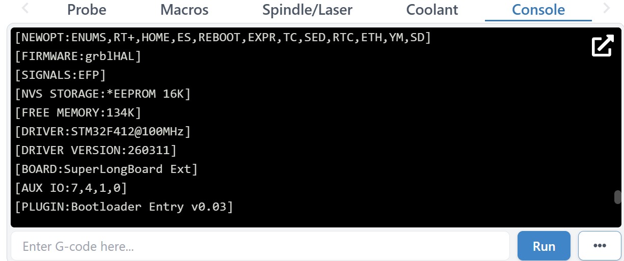

1. In the Console at the bottom right corner, enter $i then press Run.
2. Check what Driver Version you have.

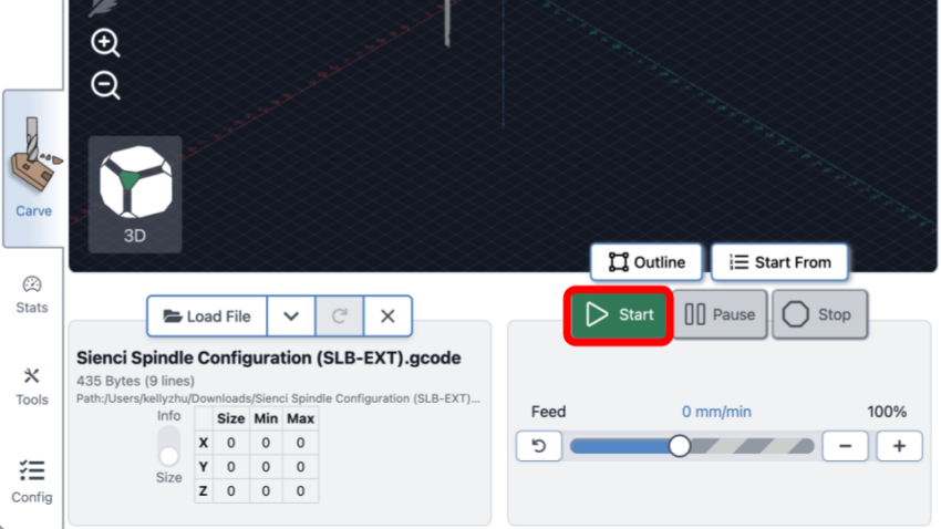

3. Press ‘Load File’ and select the file you just downloaded.
Then press ‘Start.’

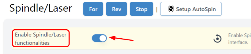

8. Navigate to ‘Config’ then at the left header select ‘Spindle/Laser.’
9. Turn ON ‘Enable Spindle/Laser functionalities’ toggle (or ‘Spindle/Laser controls’ if you are on gSender 1.5.4 and higher).

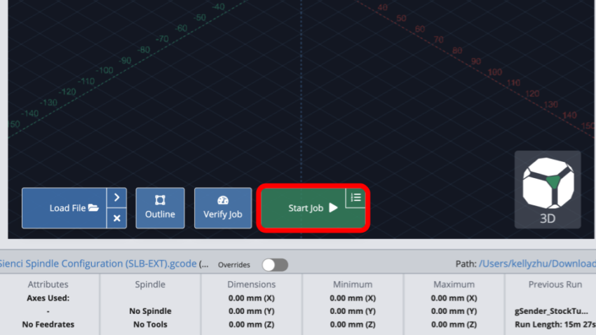

1. With your computer connected to your machine, and no alarms active, we’ll need to enable some settings to allow for communication between your controller and the spindle. This can be done by downloading and running this file Sienci Spindle Configuration (SLB-EXT).
2. Press ‘Load Job’ and select the file you just downloaded.
3. Then press ‘Start.’
