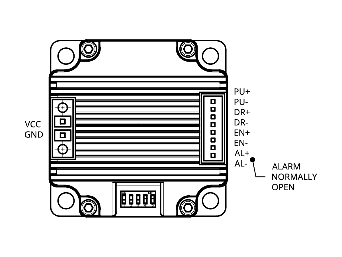

Each AltMill motor has two separate connectors – one for power, and one for signal. The pinout for both of these connectors is shown in the diagram below.
The power connector uses a 2-pin 3.81mm pitch Pluggable Terminal Block connector with two locking screws. DC power can be supplied to the motor within the range of 24V to 48V.
The signal connector uses an 8-pin 2.5mm pitch pluggable terminal block connector. This connector uses spring terminals – to install or release a wire from the connector, simply use a small screwdriver to press down onto the orange contact to disengage the spring which holds the wire.
Signals are sent to the motor using what are known as differential pairs. This means each type of signal input or output uses two equal signals of opposite polarity, allowing them to be much more reliable against outside interferences.

Motor Pinout
