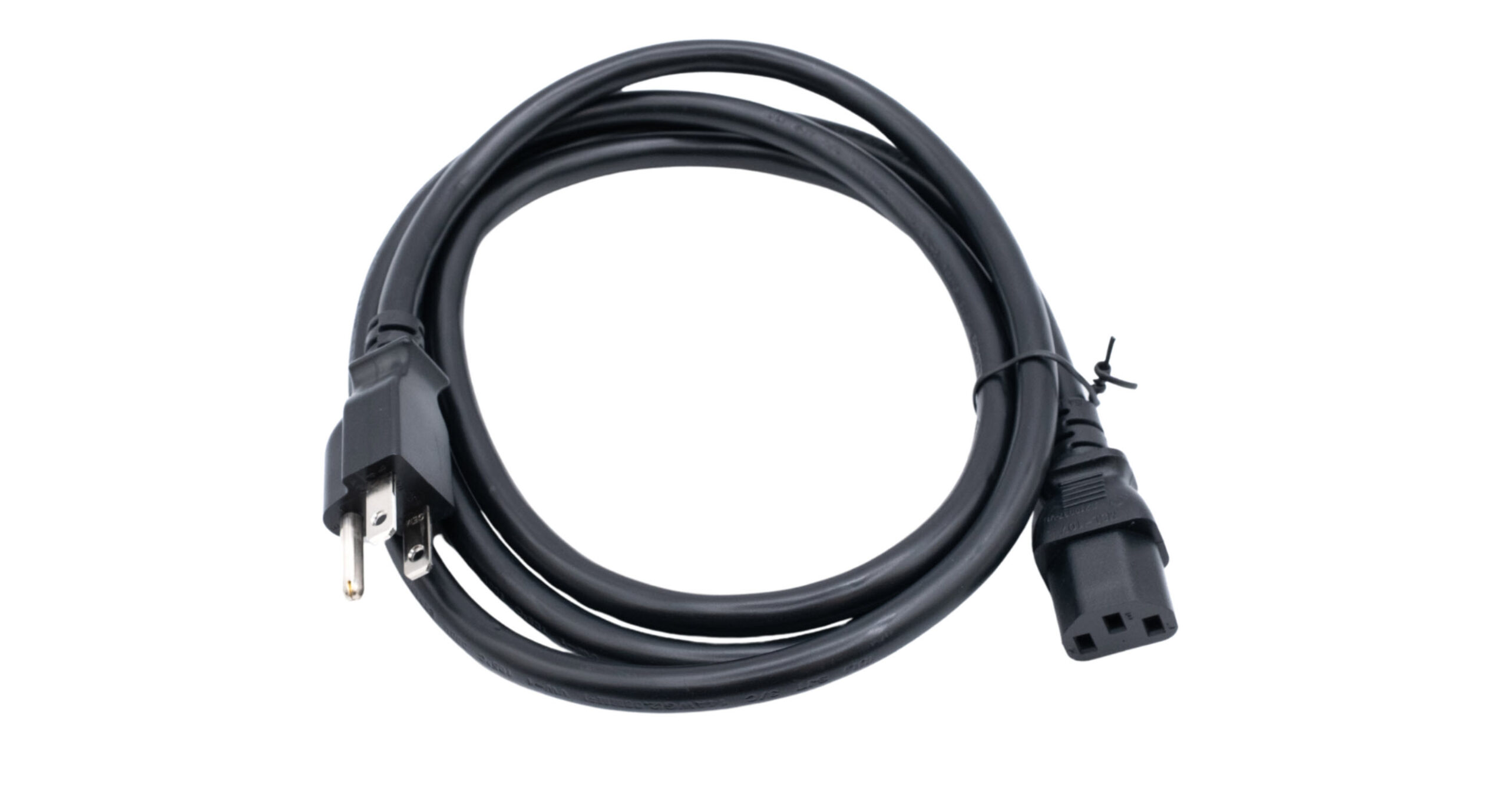

With a 1.5KW Spindle
We recommend allocating two 15A 110V/120V single phase circuits — one for the spindle and dust collection system, the other for the machine and a computer.
If you live in a country with 220V/240V power you should use a transformer to convert to 110V/120V.
- To solely run the machine, you need a rating above 500W
- To run the machine and spindle, you need a rating of 2000W, do not use GFCI breakers with spindles
The 1.5KW spindle uses NEMA 5-15P power plug.

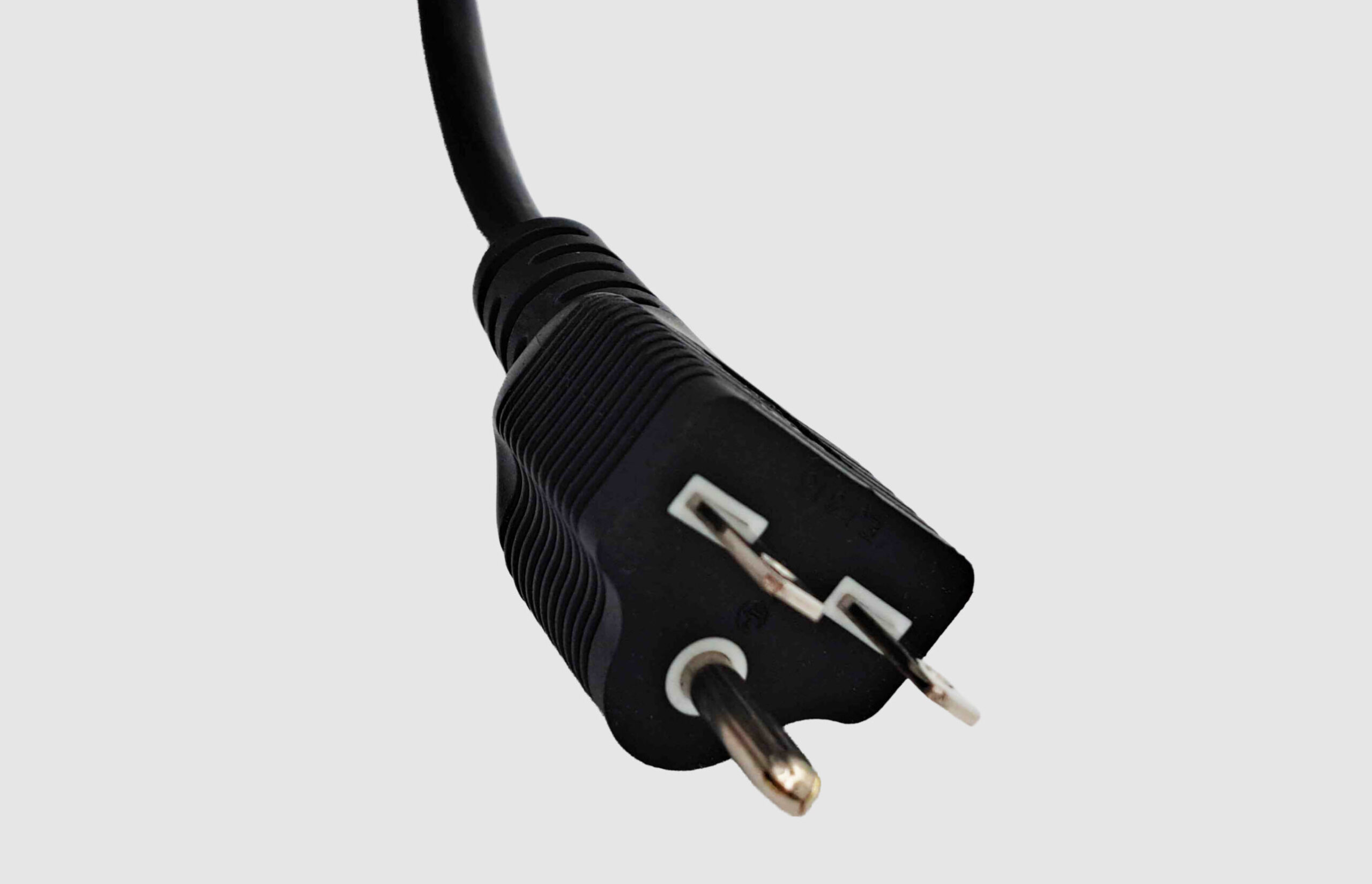

With a 2.2KW Spindle
We recommend allocating at minimum one 15A 110V/120V single phase circuit for the machine and one 15A 220V/240V single phase circuit for the spindle. Computer and dust collection can go on any of the two circuits as needed.
If you live in a country with 220V/240V power you should use a 500W transformer to convert to 110V/120V for the machine
The 2.2KW spindle uses NEMA 6-15P power plug.
