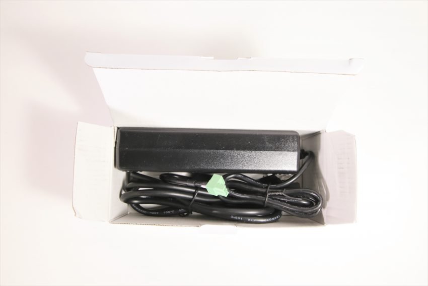

  • The power brick with its AC power cable inside a white cardboard box
