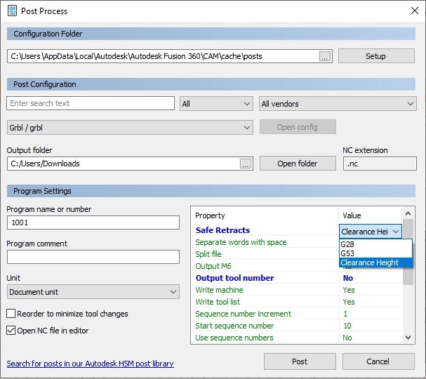

Machine is cutting lines into my project
  • If you have the ‘homing cycle’ enabled in your firmware settings, any ‘G28’ command used for a safe retract height will cause the machine to move to it’s Z-axis home position. If you have not homed the machine before this command is called, the Z-axis may not lift high enough, or plunge into the work material. With the ‘homing cycle’ disabled, gSender will automatically ignore these ‘G28’ commands and will lift the Z-axis to a clearance height instead.
  • If you are using Fusion 360, ensure that ‘Safe Retracts’ is set to ‘Clearance Height.’
  • Ensure that you are not hitting the Z-axis movement limits when running the job.
  • Review the g-code with a visualizer (https://ncviewer.com/) to ensure there are no unexpected toolpaths or incorrect g-code commands.

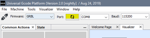

I cannot connect to UGSPlatform or any other g-code sending software
  • Try restarting your program or computer.
  • If you have other programs that are open that may be connecting to your Arduino (especially Arduino IDE) that they are closed.
  • Try installing the latest version of Java.
  • You might not have drivers installed. You can install Arduino drivers by installing the IDE for your computer.
  • Check your computer’s drivers. Update or reinstall them if necessary.
  • Try a different USB port and USB cable.
  • If you are using UGSPlatform, make sure to refresh and check the dropdown box for all of the ports that have devices connected to them. Try each one until you can connect.
    Click on the refresh button and try other available ports.
