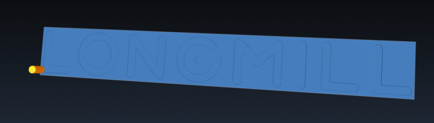

LongMill line writing
This is a very simple file which follows a line writing to spell out “LongMill”. The code that’s provided below has been made to make a very shallow cut at a low speed out of a 310x45mm piece of material. These conservative settings mean that the file can be run with almost any cutting tool out of almost any type of material. To set it up, mount your material in the cutting area so that it’s somewhat square to the machine. Using gSender or the control software of your preference, jog the tool over to the bottom left of where you’ve laid out a 310x45mm space where the tool can cut. Be sure that this space doesn’t have any screws or clamps in it which will interfere with the lettering and also make sure that it’s fully within the cutting area. Bring the tool down to the surface of the material (either manually or by jogging) and finally click “Reset zero” to confirm that you want to set this as the tool origin.
Tool (yellow) in the bottom left-hand corner (visualized using CAMotics)
LongMill-line.zip
Download the file above, ‘unzip’ or ‘extract’ it, then load it into gSender by clicking the “Load File” button. Once loaded, you’ll be able to see a visualization of the tools movements. If you’re satisfied, turn on your router (note this file doesn’t currently contain spindle control commands) then run the file!
