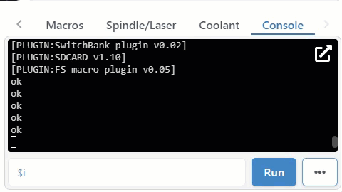

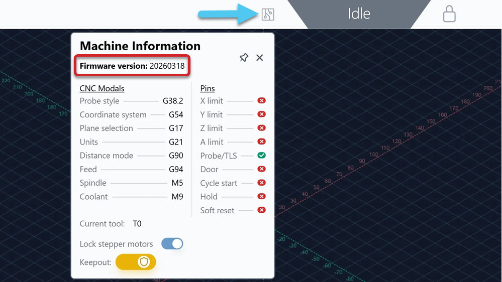

Before getting started, check what your current version is by going to the ‘Console’ of your g-code sender and send the command $i. The result will be a long list of text in square brackets. If you scroll down to about the 9th line you’ll see something like “[BOARD:” where you’ll also see the version number at the end. Compare this to the version list below to see which one you’d like to flash:

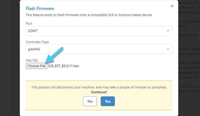

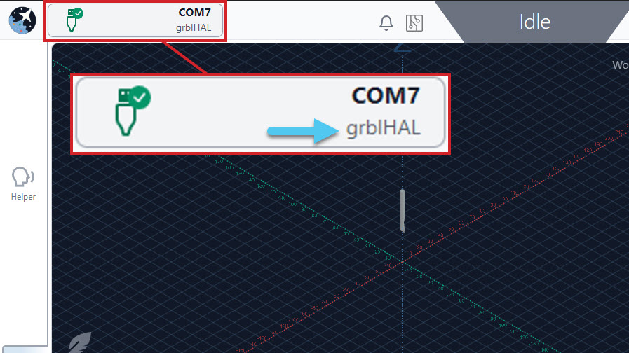

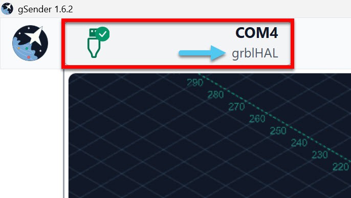

Be connected to your SLB over USB with the power on, ensure the firmware selected is ‘grblHAL‘ not ‘grbl‘

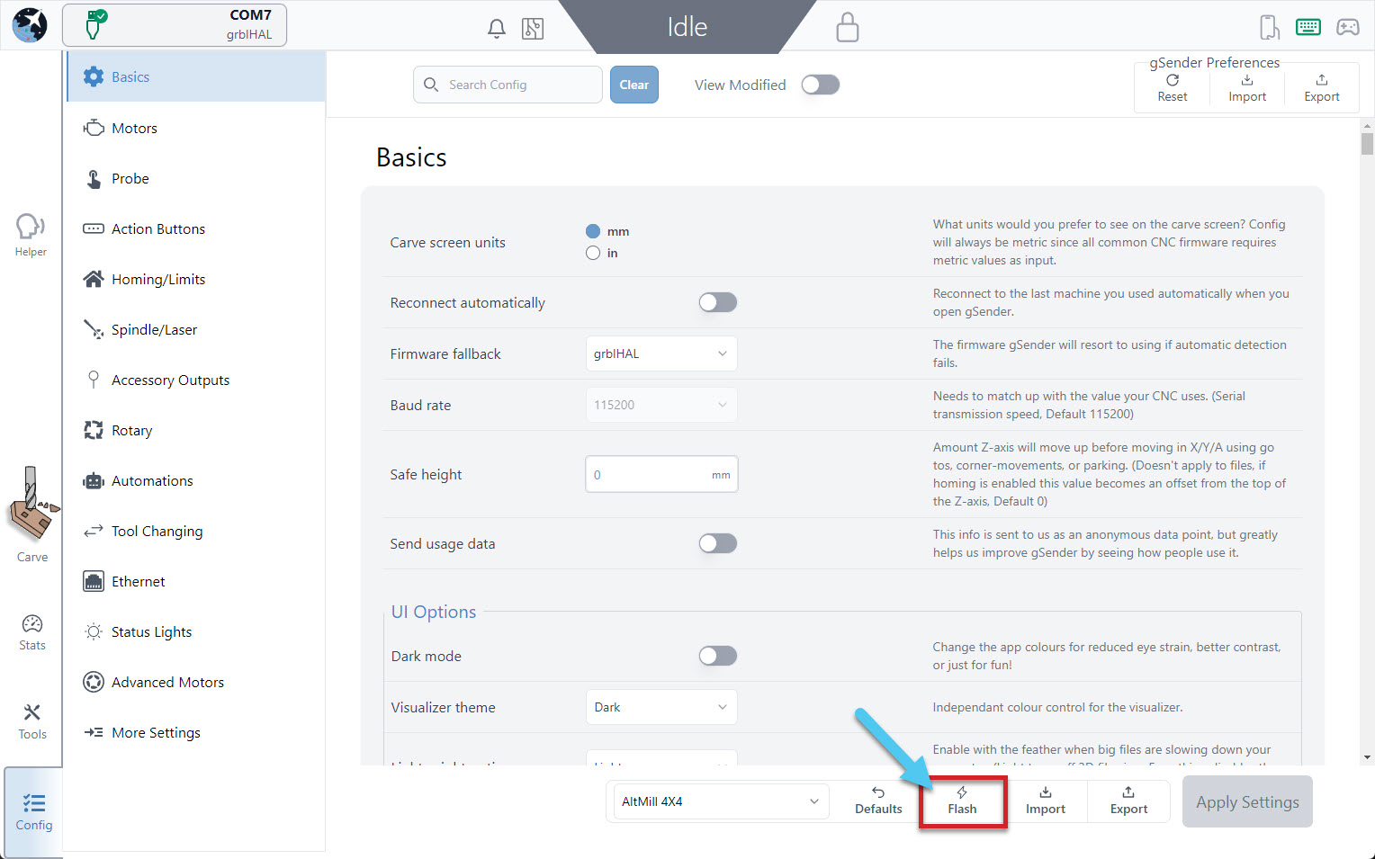

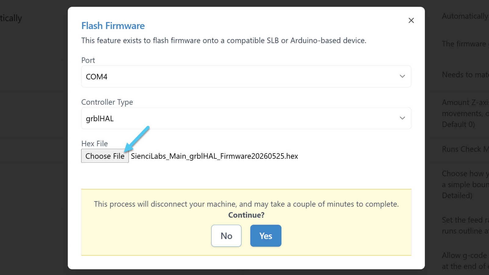

Go to the Config tab and click the Flash button
- Ensure the COM port is correct (matches the board you’re connected to), and that you have selected grblHAL as your controller type
- Click ‘Choose File’ to select the “.hex” firmware file you plan to update to, in the picture below it’s the 5.0.11 firmware for the AltMill
Click ‘Yes’ to begin the flashing process. If it stops before 100% and you see an error for:
- “LIBUSB_ERROR_NOT_SUPPORTED”, you’ll need to update your Windows driver
- “Unable to find valid device”, you might have installed your Windows drivers incorrectly
- “LIBUSB_ERROR_ACCESS”, your Ubuntu device might be having a USB rights issue

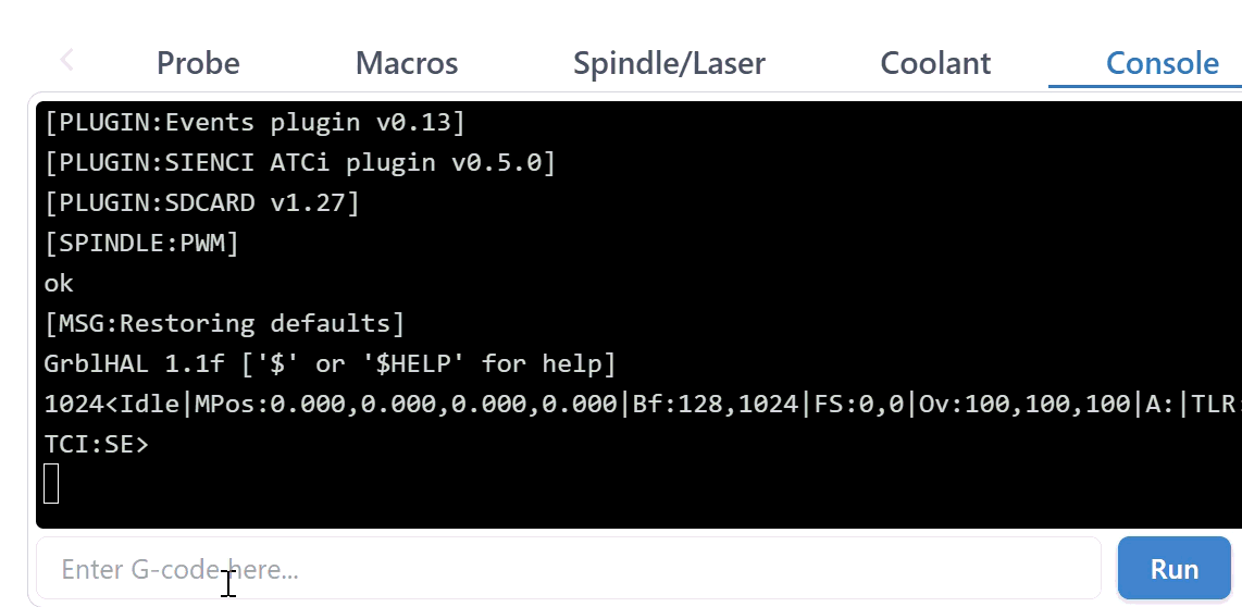

Once you see the loading bar at 100%, flashing is complete. Exit out of the firmware window and switch off the board with the power switch at the back then turn it back on again.

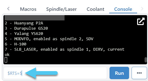

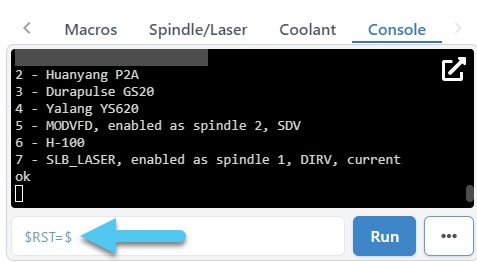

Once it’s back on, you should be able to re-connect to it in gSender. Go to the Console tab and send the command
$rst=$to revert your machine back to the default firmware settings (you shouldn’t get any errors when you send this command).
- Power the board off and then back on one more time after sending the command. Finally, if you had any specific settings from your previous setup that you want to check or reload, connect back to gSender and change those firmware values back. Remember to hit “Apply New Settings” when you’re doing this and ensure that the settings are being re-added correctly, if they don’t seem to be sticking then make sure that your SLB is in an ‘Idle’ state, cleared of all Alarms, and try turning the SLB off and back on again.
Congrats are in order, well done! If you go back to the ‘Console’ you should now see that sending the $i command will give you new text that matches up with the update you’ve made.

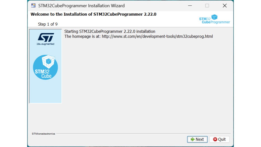

STM Cube Flashing
Download the software from here (this is version 2.15.0) or for another OS go to STM’s website.
