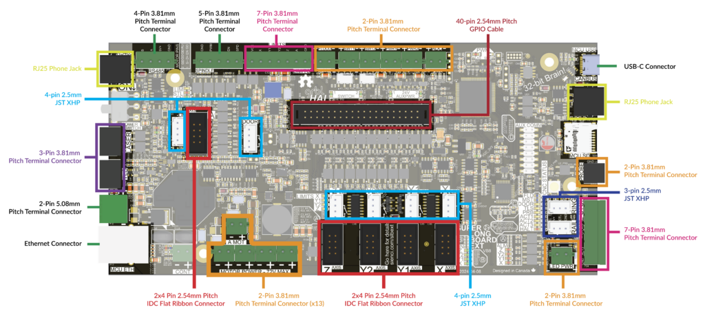

Wiring
You may need to remove the cover to access some of the connectors inside. To remove the cover, unscrew the top-right thumbscrew a couple turns (pictured) then slide the cover to the right. Once the hole in the cover lines up, pull the top of the cover towards you and it will come free.
Route all the wires from inside the enclosure through the two openings at the back, then close the lid again. The smaller, bottom one is meant to snugly fit all the motor cables, while the remaining cables should all fit into the larger, upper opening.
Here’s a general wiring ‘map’ you can use as a reference to start hooking things up. It covers the full scope of plugs and features that the SLB/SLB-EXT currently supports. Go here for the full list of connectors.
Power & E-stop Power in and control via switch, E-stop, E-stop backup, and board reset
USB & Ethernet Communication ‘streaming’ to the SLB
Motors Typical 3 axis (ganged Y) bipolar stepper motor control
Touch Plate/Probe Supports touch plates or other surface probing
Status Lights Onboard CNC status light, RGB LED strip outputs, other diagnostics lights
Limit Switches Hookup for Homing/Limits with two plug styles, also supports min/max switches for hard limits
Laser 5V PWM dedicated output for independent Laser control
Action Buttons 3 programmable action buttons that support macros
Accessory Outputs 2 SWITCH outputs that turn on any external circuits 1-24V up to 1A, and 2 AUX POWER outputs which provide up to 24V 250mA to external accessories
Spindle/RS485 Controls a Spindle or VFD using 5V PWM or RS485
Tool Length Sensor Powered input for a Tool Length Sensor for tool changing or for use as a secondary probe
Rotary/4th/A-Axis Output signals for an external motor driver and input of an independent rotary axis limit switch

Connectors List
The SLB/SLB-EXT comes with many inputs and outputs that are easy to wire in for CNC customization and accessory hookup by using pluggable terminal connectors. There are also a handful of other connectors used that are common and widely available for purchase. Below lists all connectors used on the board (male) with example links:

SLB-EXT Connectors
Current Unused SLB Ports
Right now there are a handful of plugs and pins on the SLB/SLB-EXT that technically don’t do anything useful yet which is why there’s nothing in the manual on it. The idea was that by adding in the hardware at the start, we could keep working on testing and implementing firmware to make more features available to all SLB/SLB-EXT owners without having to buy a new board. We’re very excited about it but ultimately can’t make any guarantees on what will and won’t ultimately work, so that’s why no features have been promised yet outside of what’s already been tested and delivered. These ports include the: SaS Spindle pin, Pendant, SD card, Door, ADC, 40-pin AUX COMM Header, and AUX IO Header.
If you’re still interested in trying these out without our support or documentation, we have all our board designs and firmware code available online for reference and modification so you can feel free to try your own stuff and even contribute back to the project! For instance, you can see the 40-pin inputs and outputs in the full schematic PDF on page 19.
