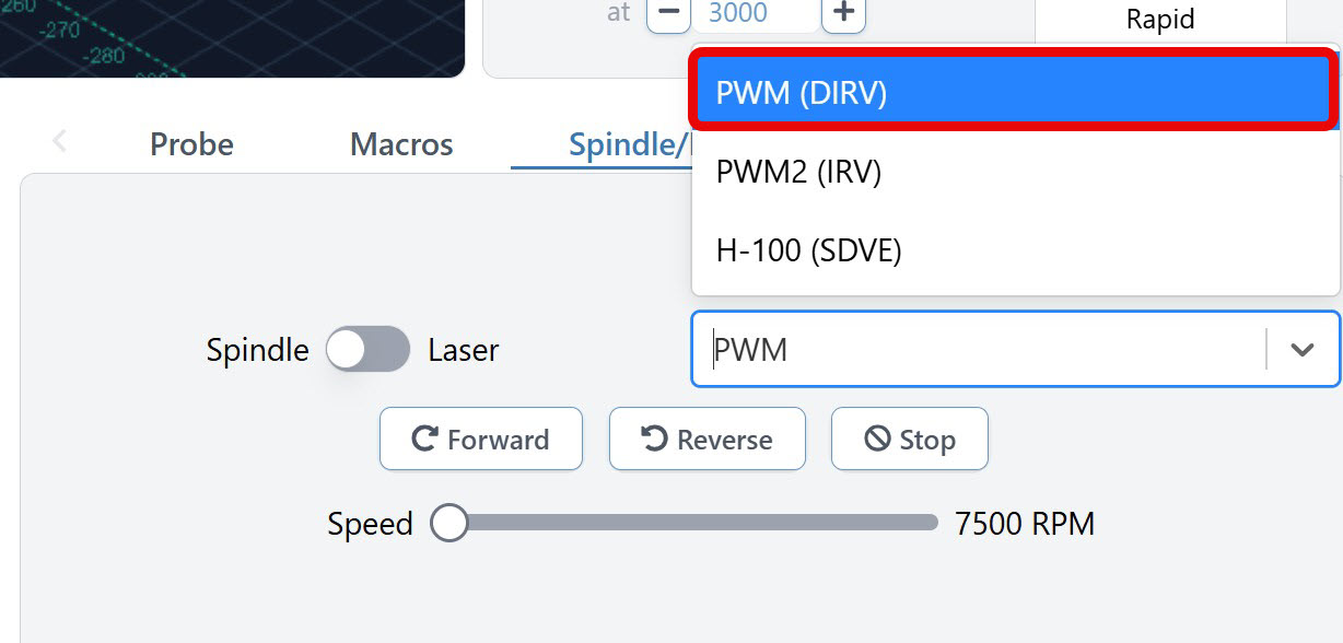

On the main gSender screen, go to the Spindle/Laser tab at the bottom right corner. Ensure you are on Spindle Mode, and you are using PWM or SLB_SPINDLE.
You can then use the speed slider and ‘CW (M3)’ or ‘Forward’ button to test the router at different speeds. Press ‘Stop (M5)’ when you are done.
Using PWM option
Using SLB_SPINDLE option
