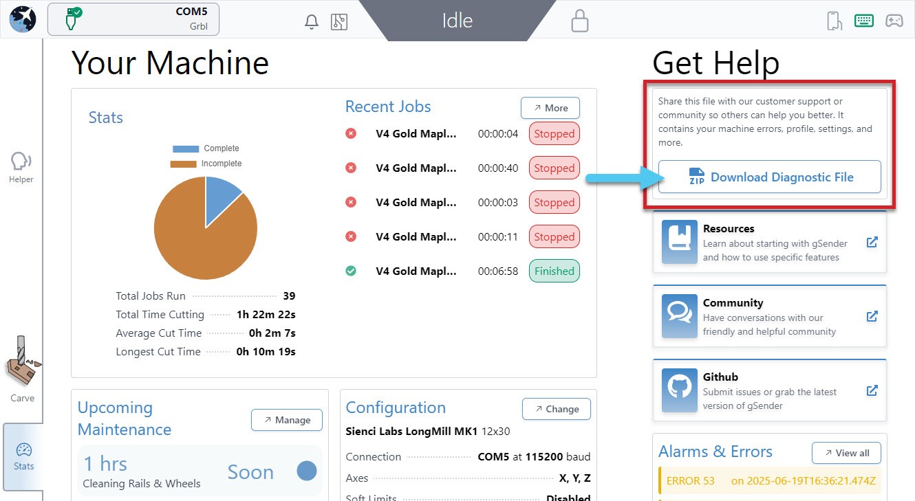

Information to Send
In order of importance, please collect together information of:
  1. The name and model of your CNC, your computer Operating system (Windows, Mac, etc.) and gSender version
  2. Please connect to your controller, try to recreate the issue, and as soon as it happens again create a ‘Diagnostic PDF‘ to send to us. If you can generate this shortly after the issue that’s ok too, but it won’t allow us to help you if you’re not connected to your machine or you generate it too long after you had the issue happen. Find this by clicking on the Stats tab in gSender, then clicking the Download Diagnostic File button and saving it on your computer.
  3. Machine Firmware, get this by going to the Config tab and looking to the bottom of the page. Here you will find another Export button to save the file to your computer.
  4. Your g-code file if you’re seeing the problem only with a specific file
  5. Any other pictures or videos of the problem can also help us to help you faster
Please attach the files and information in your post / email to us.

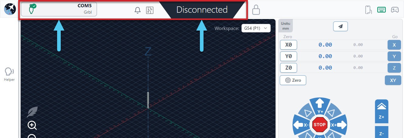

Connects but status says Disconnected
If your machine connects on a COM port successfully but the machine status says “Disconnected” then this is not an issue with gSender. A ‘Disconnected’ status means that gSender isn’t able to recognize your CNC even though it can see it.
  1. Check that you have the right settings for your board, for instance click the Config tab ➜ Basics ➜ Baud rate dropdown, where most boards use 115200. Also your machine might not be supported yet by gSender if it isn’t using grbl or grblHAL or your manufacturer edited the core firmware too much.
  2. Your board may have a faulty connection. Try unplugging it then plugging back in, use a different USB cable, a different USB port on your computer, or plug the cable directly in if you were using a USB hub.
  3. Your board might have other loose connections. Power off your machine, then use a non-conductive tool like a plastic utensil to push down on all 4 corners of your control board shield or Arduino. For the LongBoard you don’t need to open it, just flip it upside down and you’ll be able to access the Arduino through the slats on the bottom. Doing this will ensure that everything is fully plugged in since sometimes if the Arduino is slightly off the control board it can mess with its communication.
  4. Your board might have corrupted firmware. Re-flash your board if it’s a LongBoard, SLB, or by following your manufacturers instructions.
  5. At the least when you plug the board to your computer over USB you should hear a ‘connection’ sound from your computer. You should also see a new device appear under the Devices and Printers on your computer. If none of these are happening, then that means your computer isn’t recognizing the board so you might want to look at drivers or getting further technical support.

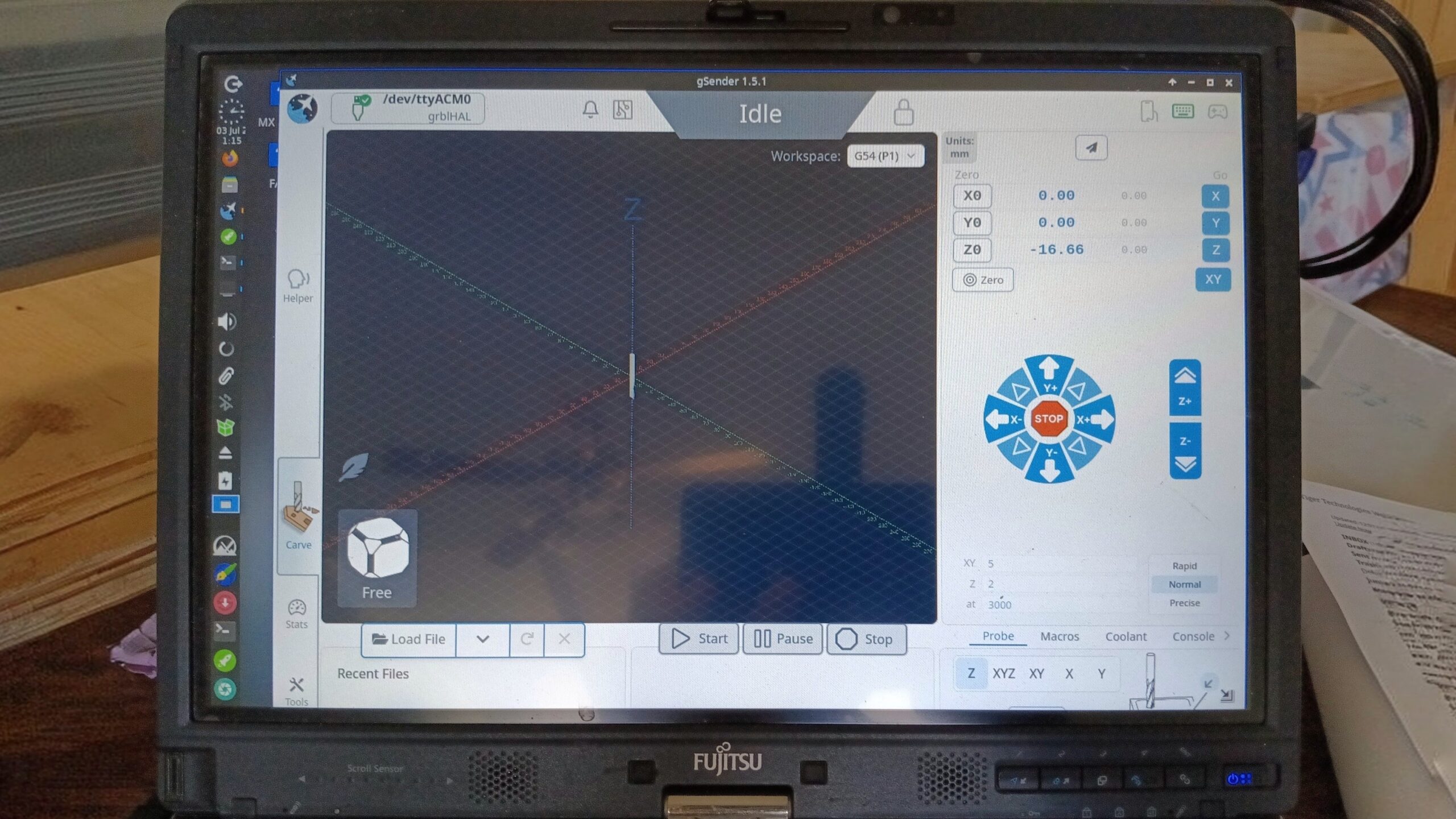

UI does not fit on the Screen
We’ve always done our best to ensure that gSender is clear and easy to use across devices and across screen sizes too – but sometimes there are certain screens that gSender just doesn’t suit. In these cases, we recommend you check the ‘zoom’ on your device until you can see everything clearly and can access all the buttons.
For Windows, see a writeup with pictures here but otherwise the shortened version is:
  1. Go to your Desktop, right-click it, the click ‘Display settings‘ from the menu.
  2. In the Settings window, scroll down to the Scale & layout section.
  3. Use the dropdown to choose the scale percentage that works best for you. It’s likely that using 100% will resolve your issue, but try other options if you need to make sure it works on your setup. Windows will automatically apply the new scale once you choose it.
  4. Another option you can adjust is scrolling down to Text size on the ‘Display settings’ page, using the slider to adjust the text size to your preference, then clicking the ‘Apply‘ button.
For Linux: try reducing the app-specific display setting from 1.0 to 0.75 for example.

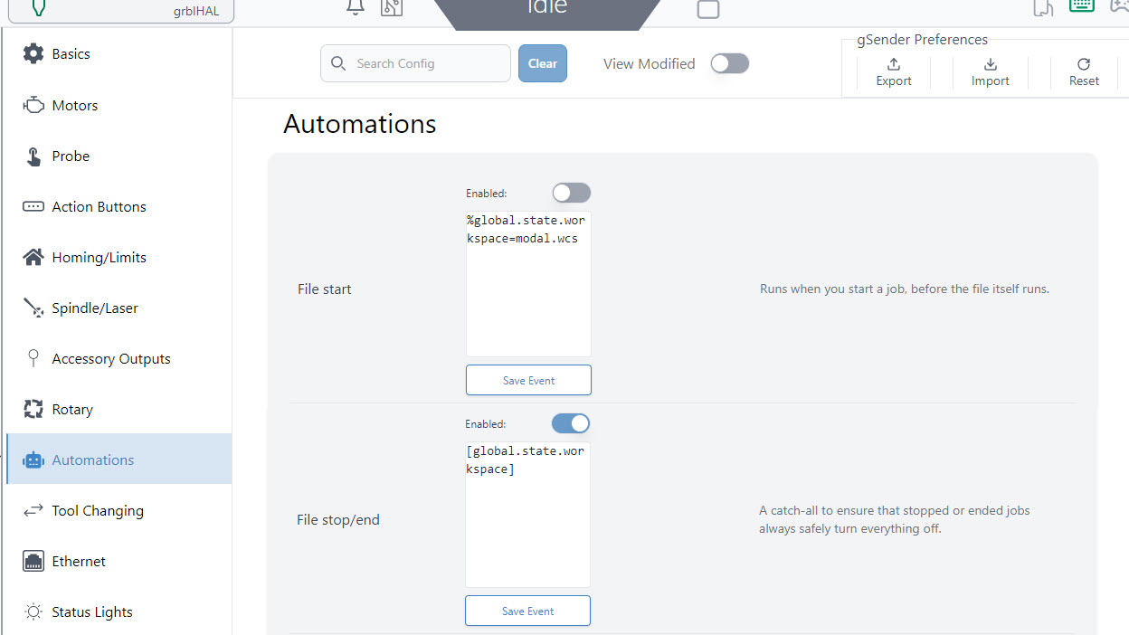

Workspace changes during/after a job
If your g-code includes any workspace commands from G54 to G59, G59.1 to G59.3, or has an M2 or M30 command at the end of the program this will alter your selected workspace either to the one specified or revert it to G54. These commands affect how grbl stores the active workspace and so also affect the workspace stored by gSender. If you’re experiencing this issue then you’ll want to check your CAM post processor and ensure that it stops inserting these commands when you export your g-code jobs.
Alternatively, gSender’s ‘Start/Stop G-code’ can also be equipped to sidestep problems with changing workspaces by saving the active workspace at the start of the program and then re-loading it at the end. This can be done with the commands %global.state.workspace=modal.wcs and [global.state.workspace] as shown in the picture below. Remember to ‘Update Event’ on both entries:
