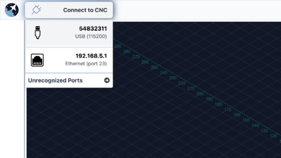

Connect to your machine through USB or ethernet.

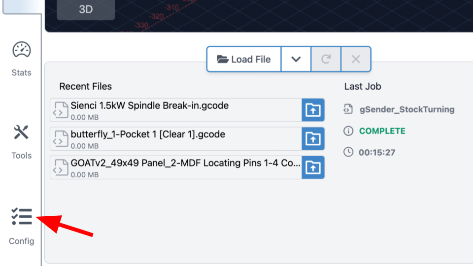

Navigate to the “Config” tab at the bottom left corner.

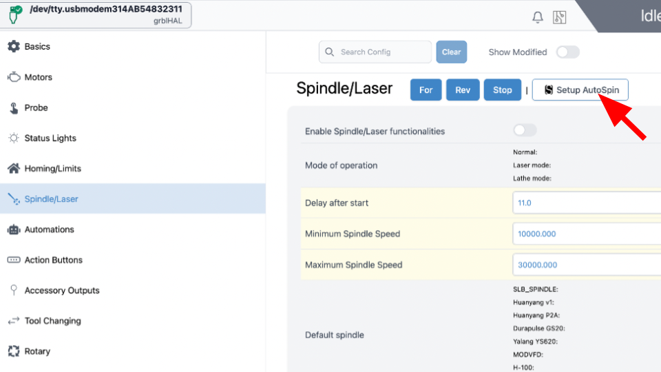

On the left side menu, select the ‘Spindle/Laser’ option.
You will be navigated to the Spindle/Laser section. Select the ‘Setup AutoSpin’ button.

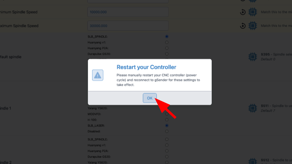

Your SLB will start flashing lights, indicating that the settings are being uploaded. Press OK on the popup window, then as mentioned, reset your SLB by turning it OFF then ON.

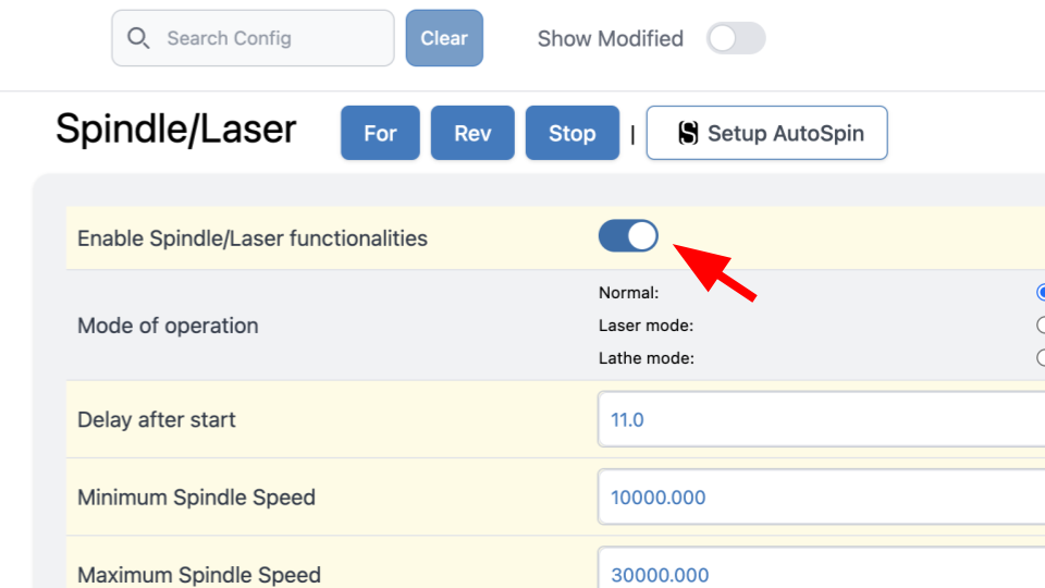

Reconnect to gSender. Go back to ‘Config’ and under Spindle/Laser, toggle ON ‘Enable Spindle/Laser functionalities.’

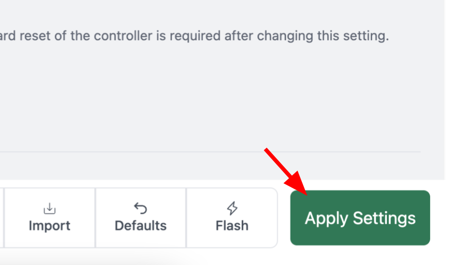

Press ‘Apply New Settings’ at the bottom right of the screen.

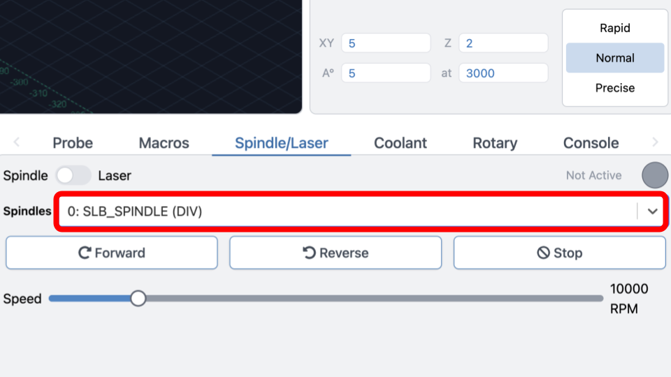

Testing
Now we will test that the AutoSpin is set up correctly.
First turn the dial of the router to the “S” position.
Then plug in the router and flip the power switch to the “I” ON position.
The two indicator lights on the router, for the power and spindle mode respectively, should both turn ON .
On the main gSender screen, go to the Spindle/Laser tab at the bottom right corner. Ensure you are on Spindle Mode, and you are using SLB_SPINDLE.
You can then use the speed slider and ‘CW (M3)’ or ‘Forward’ button to test the router at different speeds. Press ‘Stop (M5)’ when you are done.
