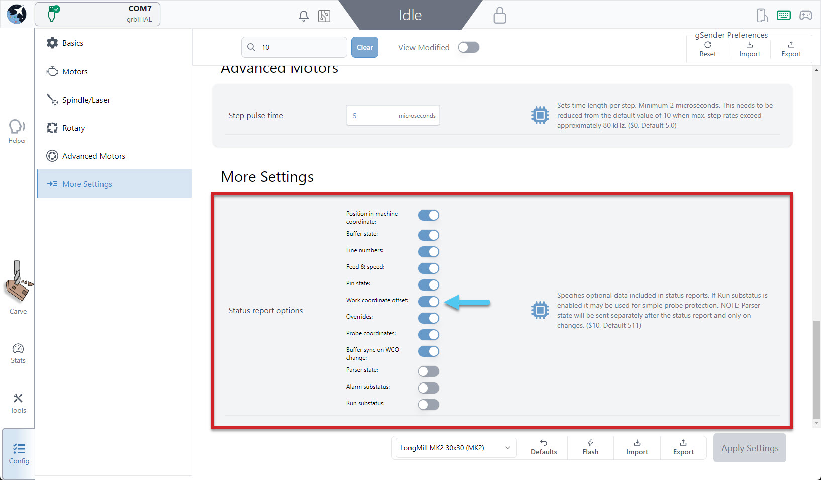

  • Pressing to ‘Zero’ axes isn’t working: ensure “work coordinate offset” is enabled for $10, or that $10 = 511
