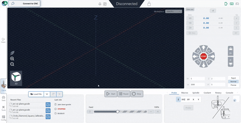

Once you see the ‘Completion’ screen you should be good to go! Click ‘Finish’ then open gSender and get ready to connect to your CNC.

Once you’ve downloaded gSender, double-click to run it. A window will pop up that will look like the one below. Click and drag the gSender app to the applications folder to save it to your computer.
Go to your applications folder and you should find gSender ready to use once you follow the same install process as Windows.

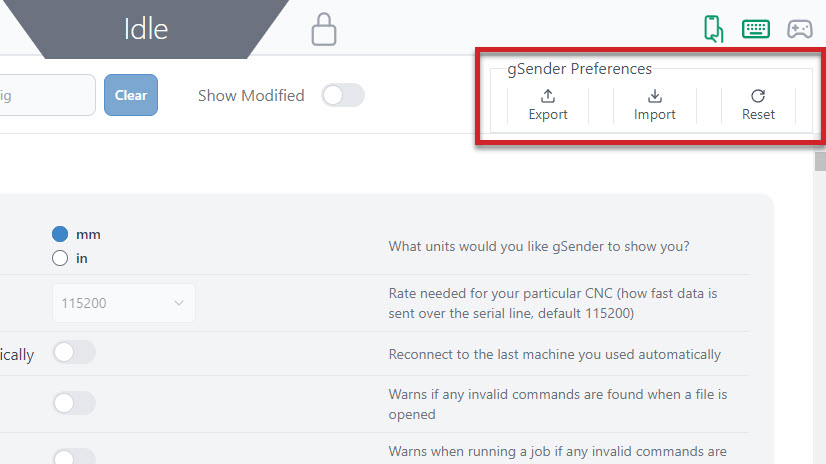

If you upgrade to a new version, or downgrade to an older version, and gSender won’t open or run (blank screen):
You’ll want to find a file called “.sender_rc” and rename it so gSender can generate a new version without errors. Sometimes you might also want to delete the “.sienci-sessions” folder too.
- For Windows: the file can usually be found on your hard drive, at: C:/users/{your username}/.sender_rc. Rename it to whatever you like, like “.sender_rc_old“, then try to reinstall gSender again.
- For Mac/Linux: the file is in the home directory as a hidden file. You can either:
- In Finder go to Go ➜ Computer ➜ Drive ➜ Users ➜ {your username} then un-hide the “.sender_rc” file by pressing
CMD + Shift + .keys. Rename it to whatever you like, like “.sender_rc_old“, then try to reinstall gSender again. - Go into the Mac/Linux console and enter the command
mv ~/.sender_rc ~/.sender_rc_old. You’ll be able to double check the renaming was successful by sendingls -al | grep senderin the console, where if you only see.sender_rc_old, you have successfully remanded and are ready to try to reinstall gSender.
- If this solves your problem, you’ll still be able to recover your old Start/Stop events and macros from the renamed file; just open it in a text editor and copy the macros you want to save so you can paste them back into gSender.
