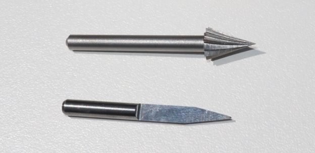

V-bit:ย v-bits have an angled tip that works great for engraving. They come in varying angles so that if you’re cutting a line with a certain thickness then a 60ยฐ bit will cut that line deeper than a 90ยฐ bit will; this variation can be used to great effect.
V-bits can be used for simple line-drawing engravings and are also commonly used for “v-carving” which varies the height of the bit as it cuts to change the width of the engraving. This can create detailed images and can also be used for stippling.
