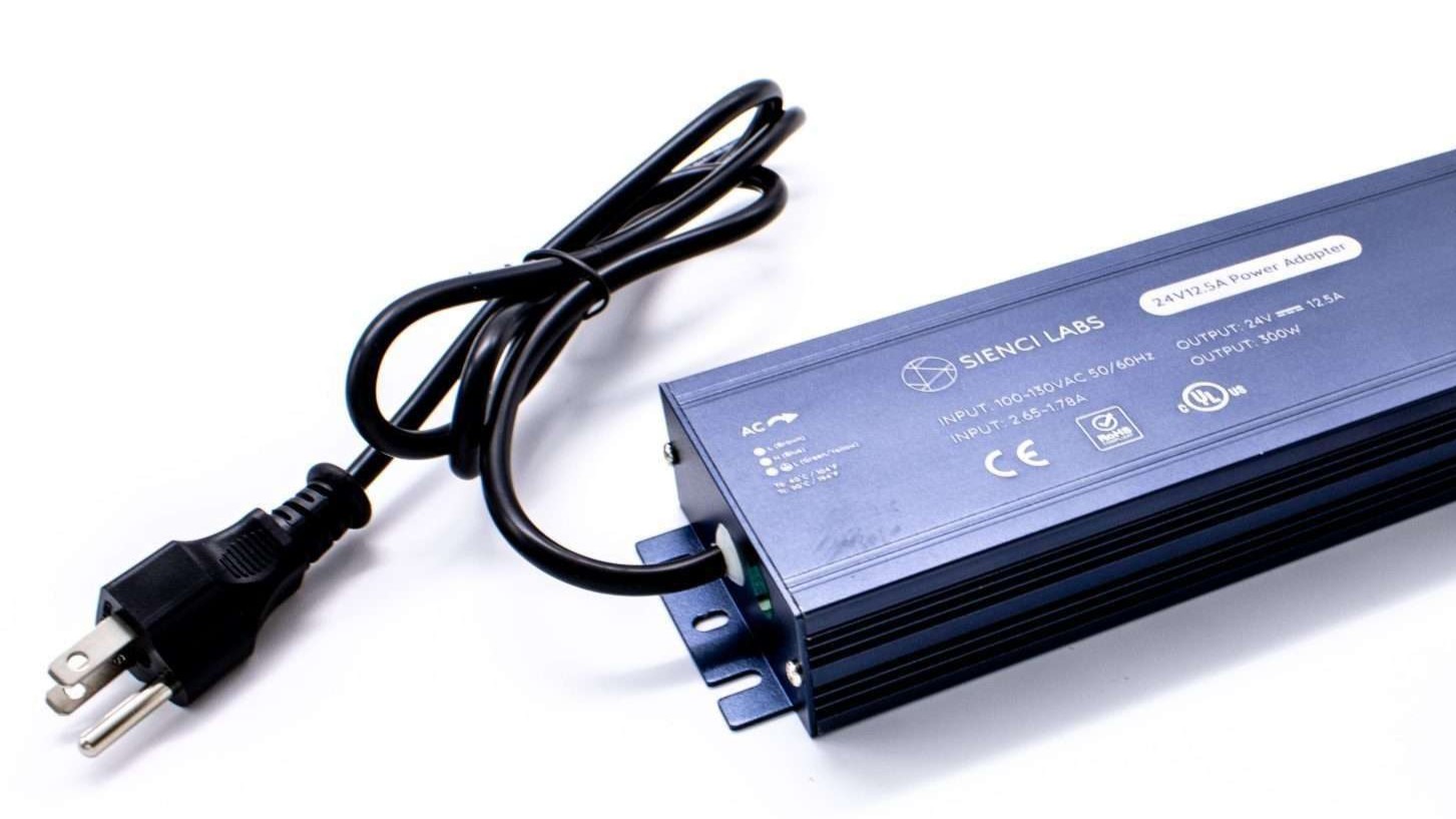

Requirements & Specs
Power Requirements:
We recommend allocating two 15A 110V/120V single phase circuits:
Circuit 1
  • 2.5A to the SLB controller
  • 6.5A to the AutoSpin or Makita router
  • Power to the desktop, laptop, mini-PC, or SBC (i.e. single board computer, like a Raspberry Pi)
Circuit 2
  • Power to your dust management system whether it’s a vacuum or dust collector (separate circuit will reduce static buildup/EMI issues)
    Router and SLB controller will use a North America NEMA 5-15P power plug. If you live in a country with 220V/240V power, you should use a transformer to convert to 110V/120V for the SLB controller.
